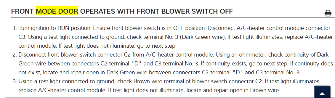

Fan will blow normal for approximately 30 minutes the less air comes out until it barely blows. Turn the switch off for 5 minutes and will start blowing again. Cleaned condenser and changed motor. More airflow after I cleaned it but still slows down. No noticeable slow down with motor just the output of air through any of the vents.

This could be a problem with your vehicle's front door mode motor. In the diagrams down below I have included the factory diagnostic troubleshooting guide for your vehicle's Front Door Motor. Please go through this guide and get back to us with what you are able to find out.
