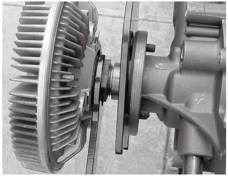

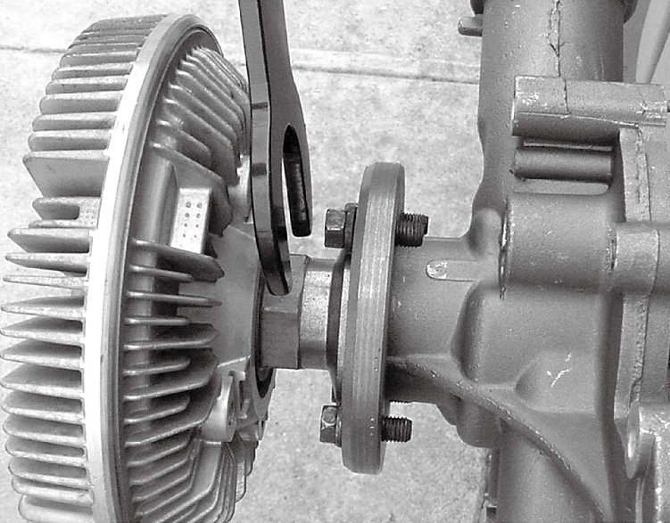

what size tool needed?
May 15, 2022 at 4:18 AM
SQM
  • 6,383 POSTS

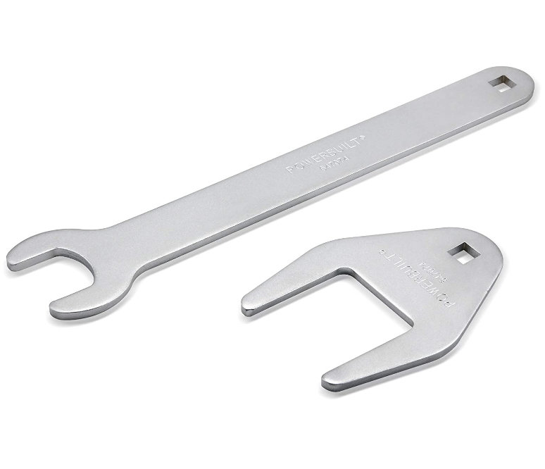

To remove the fan clutch you will need a special fan clutch removal tool.
It takes two special wrenches to loosen the clutch. They are 36mm and 57mm.
Most auto parts stores have those tools that you can use to complete the task.
Here is a helpful guide:
https://www.2carpros.com/articles/fan-clutch-removal
I have attached some pictures below for your reference.
Let me know of any questions.
