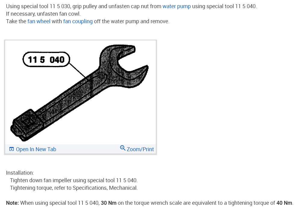

Start car, fan clutch is continuously engaged. Does not spin freely, has a good amount of resistance when I spin it. Engine temperature is perfect on dash but engine feels like it is running warm. It is belt driven, could bearing be bad? Fan clutch and water pump are only a few months old.

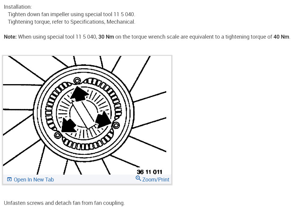

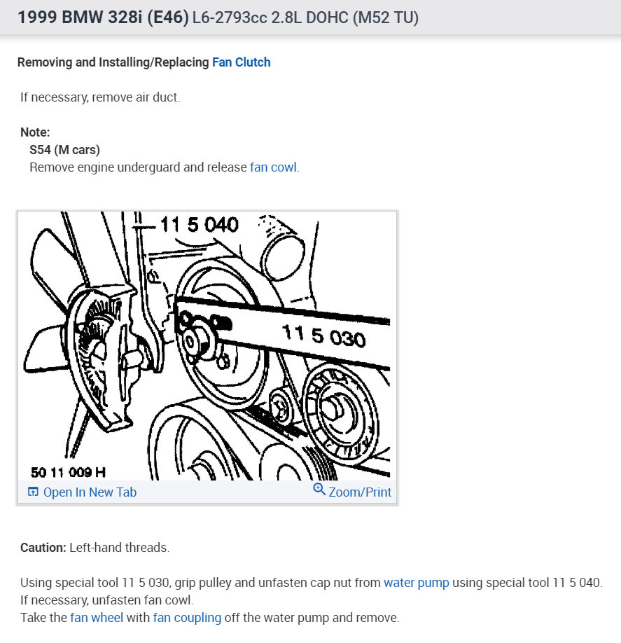

It sounds like the new fan clutch has gone bad here is a guide to help you reparable it with diagrams below to show you how on your car.
https://www.2carpros.com/articles/fan-clutch-removal
