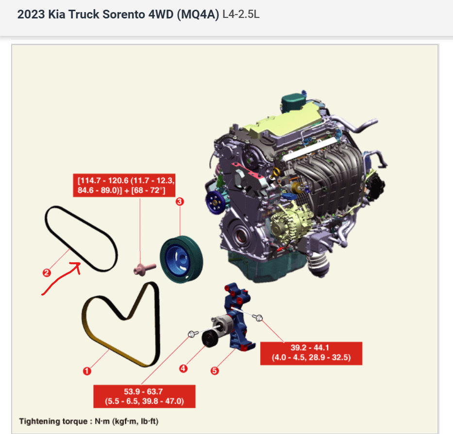

We rented the vehicle listed above. Drove the car 700+ highway miles from Glacier NP to Rapid City SD and then returned it the next day to the car rental at the airport from hotel in Rapid City. Three weeks later the car rental sent us a claim that the water pump belt was missing when they rented it the next day. The new renter drove it for an hour and the vehicle overheated. Their mechanic says this was due to mud being thrown up into the drive belts and de-railing the water pump. Is that even possible?

Yep, this sounds like an internal issue with the rental company employees. If the belt was off when you had it, you would know immediately because the engine would overheat. Check out the images (below). Let us know if you need anything else.

The same belt drives the alternator? There would be a light on showing that the battery wasn't charging?

No, the water pump belt is all by itself.
