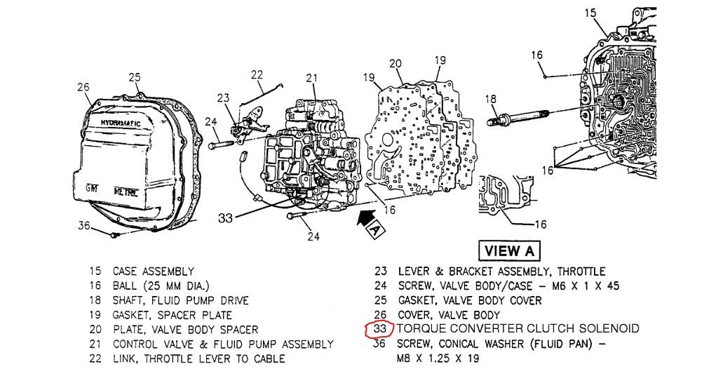

Good afternoon,
This sounds like the torque converter is locked up causing it to stall at idle whether in drive or reverse.
Is the check engine light on? If it is, I need the code to see if one of the solenoids has set a failure code.
