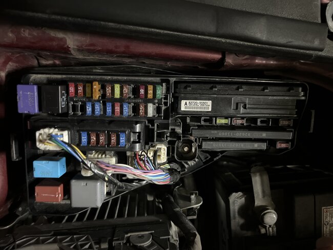

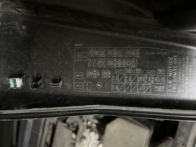

The first thing I would do is check the ECU-B1 fuse which is in the fuse panel under the hood. This fuse runs all of the systems you have motioned, this video will help.

The ECU-B1 is a 10A fuse and it’s good. I replaced it just in case. No luck

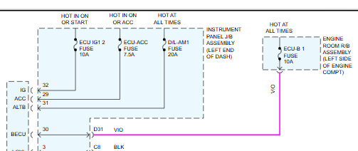

Okay, that is the smart key thanks, I would have the car on and test the fuses listed below. Check out the images (below). Please let us know what happens.
