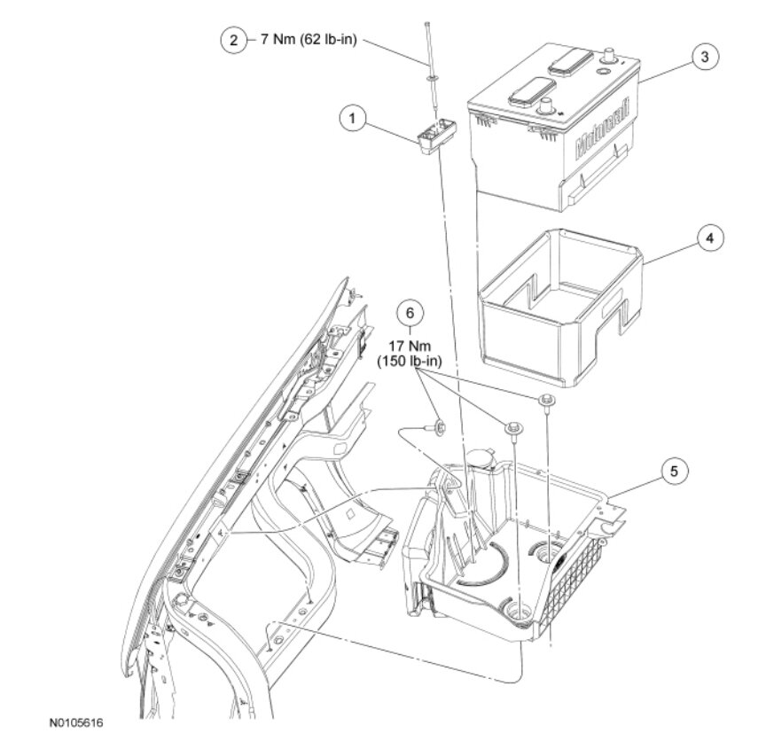

Is it possible for you to video what is happening? I just dealt with a similar issue and the problem was a weak battery.
If you haven't already, confirm the battery is fully charged and the terminals are both clean and tight.
Nov 11, 2024 at 6:32 PM
  • 54,520 POSTS
Yep, agree with JACOBANDNICKOLAS, it sounds like the battery needs to be replaced, here is a guide to help walk you through it. You can take the battery to the auto parts store and they will test it for you.
https://www.2carpros.com/articles/how-to-replace-a-car-battery
Check out the images (below). Please upload pictures or videos in your response of any problems so we can see what to help you with.
