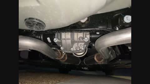

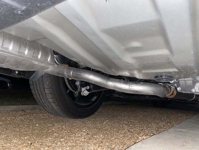

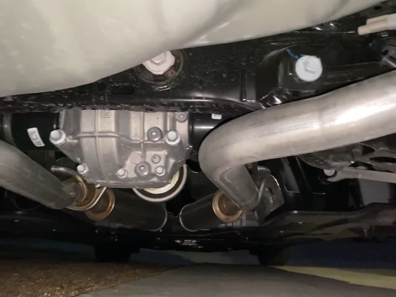

I’m thinking 2.25. The car is brand new, and man does it have power for a V6. 0-60 in about 5.9 seconds but sounds like a baby, lol. I would like a deeper tone. I thought about doing a rear resonator deleting but fear I might get a drone sound. I have true dual exhaust with 2 4-inch tubular mufflers in the mid-section and two resonators near each back bumper. Would replacing the stock mufflers with Flow master FX be a good idea for a deeper but not fart can sounding option? I have a Hemi 5.7 Ram so I’m not trying to make it sound like a V8 just a bit deeper tone as it has the power already. Attached pic is the two front mufflers. Thanks

Attached are the current mufflers.
Sep 30, 2022 at 3:35 PM

Back resonators.
Sep 30, 2022 at 3:37 PM

Thanks for the images and video. The flow master FX is a good choice, but I would hang onto the stock mufflers because they are of a high quality. Please upload a video once the job is done so we can hear it. :)

Do you mean that I should replace the back resonators with the FX mufflers or simply keep the stock mufflers after removal? I think you mean hang on to the stock mufflers. thanks again

Yes, the rear resonators only but keep the stock ones because you might go back to them.
