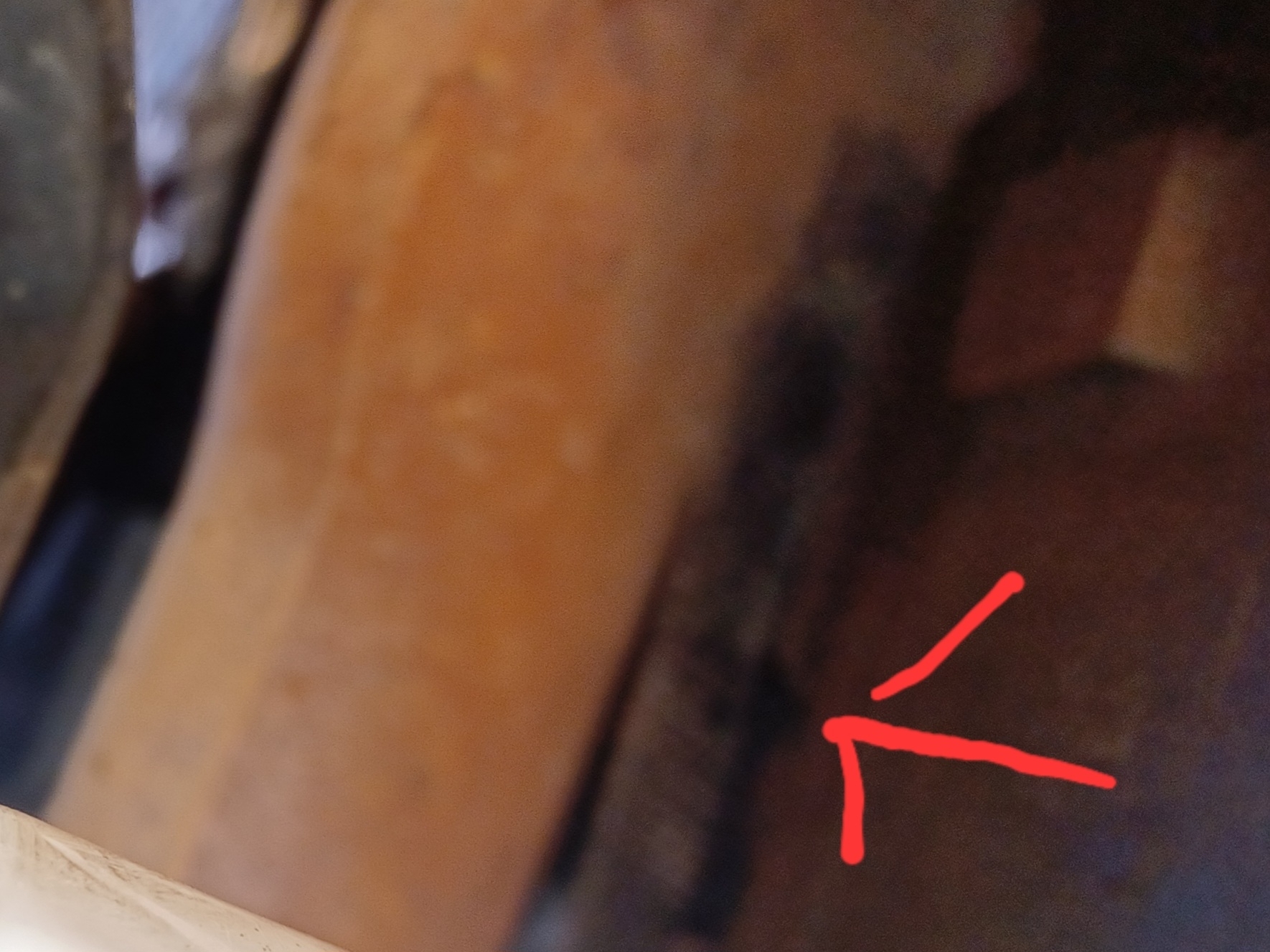

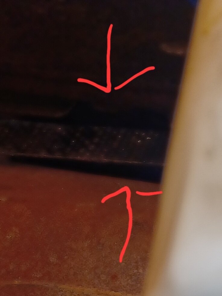

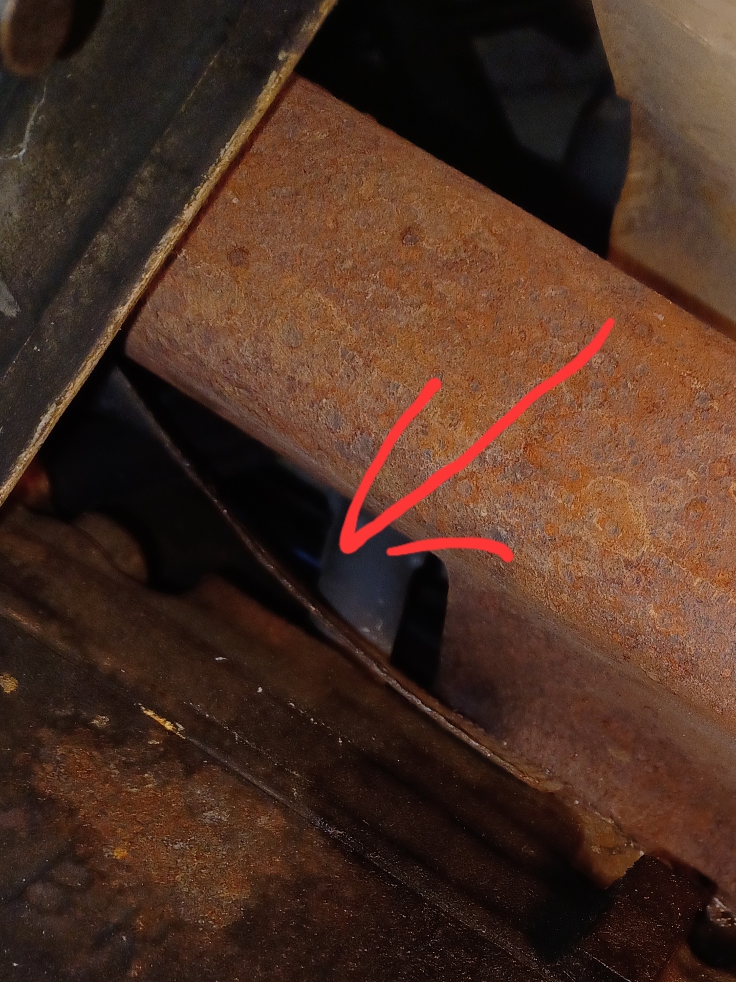

I have found what looks to be a hanging piece of gasket at the bottom area of the manifold. Very loose hanging gasket like piece. The other side is off it looks like too.
Can that cause you to lose oil where it's not sealed?

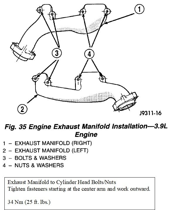

What's the best technique to get off the bolts without breaking them? And do I use thread lock on new bolts and what's the torque?
Any info is appreciated.

There's a metal gasket between the cylinder head and the exhaust manifold. It's actually in two pieces but they're held together with a connecting strip that doesn't get sandwiched between anything. If that connecting strip gets rusty and breaks free, it can hang down. If you can twist it to break it off, that part can be thrown away. If any of the sealing parts rust away, you'll have a loud ticking noise. That is especially easy to hear from inside during periods of moderate to heavy acceleration.
Chrysler doesn't use gaskets between the manifold and exhaust pipe. If you have to take that connection apart, you can expect the little tin clips that hold the nuts to break and let the nuts spin when you turn the bolts. Those clips are only meant to hold the nuts during assembly, then their job is done. It's hard to get a wrench on those nuts to hold them, and if you can, they're usually rusted too tight to spin them off with hand tools. It's much easier and faster to use an air-powered cutoff tool to cut through the bolts. The holes in the manifold are not threaded, meaning you can just lift out and discard the top parts of the bolts.
The exhaust manifold has nothing to do with oil leaks. The only thing going through them is exhaust gas. No thread locker is needed on any of these bolts. Using that will just make it that much harder to take them apart next time.

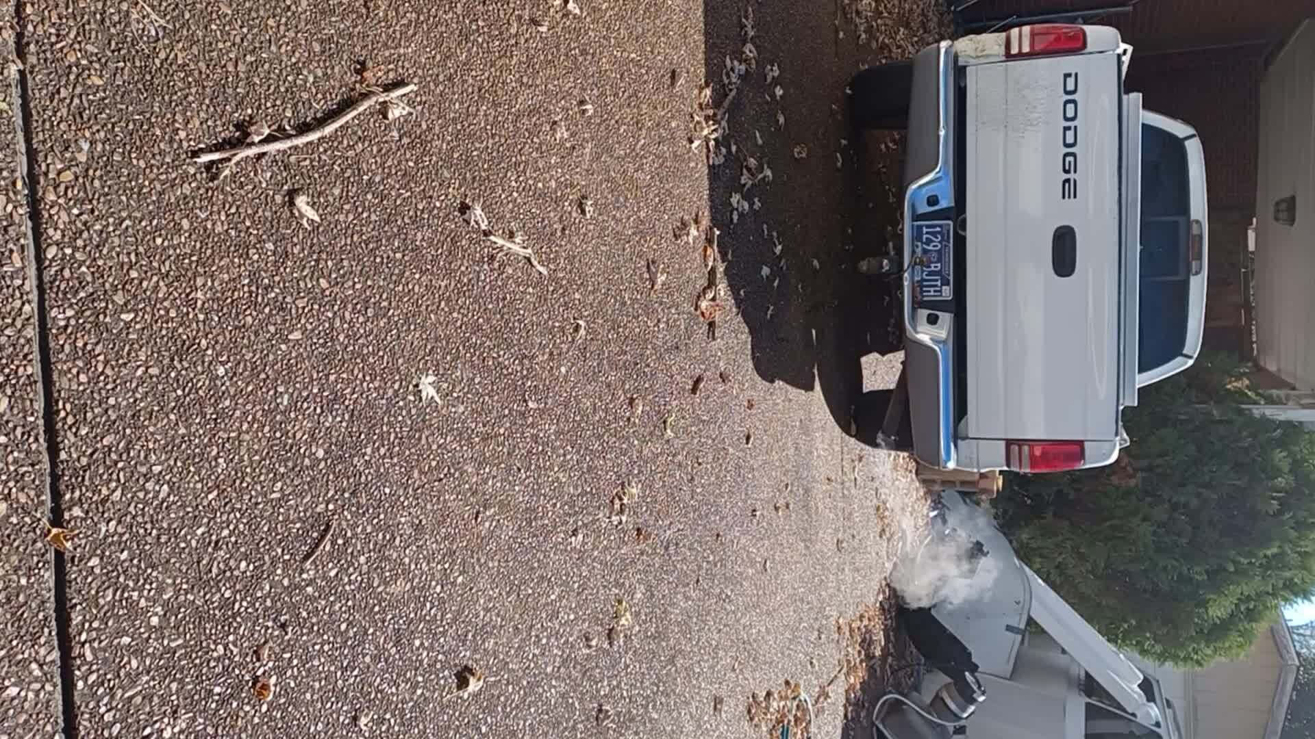

Is the gasket that's hanging down why at times I see white smoke. From tailpipe especially at start up or lights, but not always?

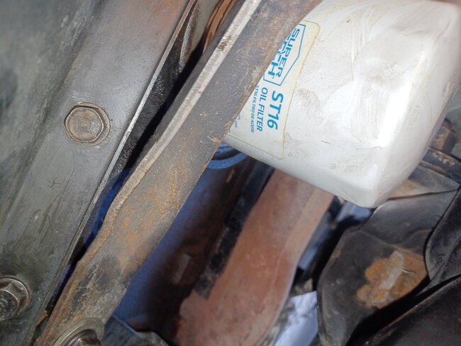

I also wanted to know if the o ring on the cam pos sensor can factor leakage? I'm goanna replace oil drain plug since its cheap an I see a tad there. Also, see a tad ar lower lip of oil pan at rear and some more along bottom of bell housing. I'm stumped.
I did find a rad hose from the heater core needs retightening leakage.
I don't know what to look at next.
Added 3/4 of a quart today.2 weeks ago was full.
Any other suggestions?

The camshaft position sensor is inside the distributor. There is a large O-ring right under the base where it sits on the engine block, but leakage there is very uncommon. Oil there is not under pressure. It would have to splash up there, then get pushed out by excessive crankcase pressure before it runs down into the oil pan. More likely a film of oil would settle around the distributor if that O-ring wasn't sealing properly. If enough oil leaked out there to cause a drip, the PCV valve would be the better suspect as it isn't allowing the normal blowby gases to be drawn out and burned. That results in pressure in the crankcase that will push oil and / or air out through a leak.
The oil pressure sending unit sits right beside the distributor. There is pressurized oil there. Just about the only time you might find oil leaking past the threads is right after a new sensor is installed. Oil won't start leaking there years later. It is possible for the sending unit to leak internally. The two clues there are the entire sending unit will be wet, all the way up to the connector, and, if you pull the connector off, you'll find oil down by the sensor's terminals. The connector has a rubber weather seal to keep water out, so if you do find oil in there, it can only come through a leaking sensor.

Is this normal on start up an as it continues to run.

One of the byproducts of a properly working catalytic converter is water vapor. When the exhaust system is still cold, that water shows up as steam from the tail pipe. There will also be a small drain hole at the rear / bottom of the muffler. You're likely to see water dripping from that hole too. That steam can also be due to heating up the condensed water vapor that was pooled in the exhaust system overnight. That will burn off within a few minutes. As the exhaust system gets hot, you'll see less and less of that steam coming out of the tail pipe.
If that white smoke continues or becomes worse the longer the engine runs, that is a sign of burning antifreeze in the engine. That's caused by a leaking cylinder head gasket. That can happen to any engine, but it isn't real common with the 3.9L. The first clue is the level will drop over time in the coolant reservoir and you'll have to add periodically. There is an additional chemical test that can be performed to identify that. If you don't have to keep adding coolant, consider the smoke out the tail pipe to be normal. Coolant at the tail pipe will also have a sweet smell to it. Hold your hand there to collect some of the vapor. If it's water, it will evaporate cleanly. If it's antifreeze, it will leave a slimy, oily feeling.

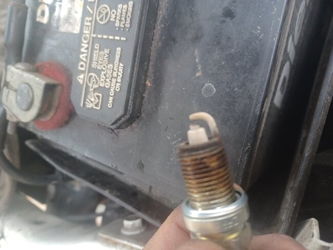

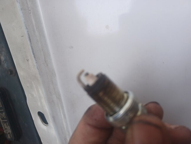

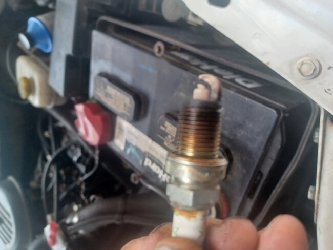

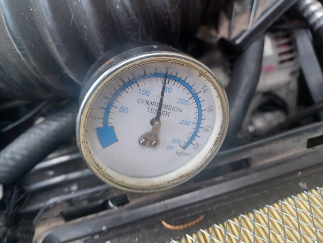

I did a quick compression test with all very loose if not even in 1st tgread. And most read 150 PSI 1 other was 148 and 146 beside it. I didn't keep a long turn over time nor opened the throttle. Is this good?
I also saw gunk on a few plugs but I'm not sure if it is additive or suit or what.
