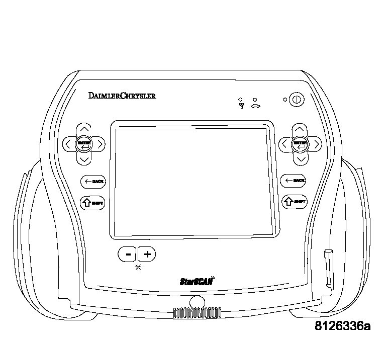

1. PROGRAM THE POWERTRAIN CONTROL MODULE
picture 1
NOTE: Check the engine for air/vacuum leaks and diagnose any Fuel System Lean/Rich as well as MAP Sensor DTCs before continuing.
Verify the PCM is at the latest calibration (flash level).
NOTE: An intermittent loss of power to the PCM without performing an ETC Relearn procedure may cause this DTC to set.
Flash the Powertrain Control Module per Service Information if any updates are available.
