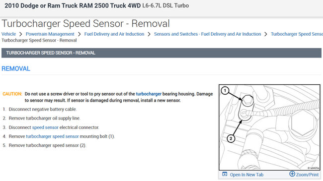

I'm getting this codes on my 2010 dodge ram 2500.
P2579 - Turbocharger Speed Sensor Circuit Range/Performance
P2580 - indicates a Turbocharger Speed Sensor Circuit Low
P2227 - Barometric Pressure Sensor 'A' Circuit Range/Performance
P2270 - O2 Sensor Signal Stuck Lean (Bank 1, Sensor 2)
P226C - Engine Control Module (ECM) has detected a slow response from
the turbocharger boost control system
P21B2 - prolonged duration to enter closed-loop NOx absorber control
I have replaced the O2 sensor and Barometric Pressure Sensor. I have also pulled the Turbocharger Speed Sensor and tested the ohms, and it read 900 from what I've read the ohms should be between 600-1200 so it would seem that it is fine. I'm kind of lost at to why the codes are still happening and need help with finding what to look at or diagnose next.

Yes, I would inspect the turbo as must as possible, if it looks okay it could be the speed sensor is out which can cause all of these codes. Lets swap out them speed sensor here is the location, clear the codes once completed. Check out the images (below). Let us know how it goes.

Would it even be the speed sensor if I've pulled that and tested the ohms and I'm getting 900? from what i have found the ohms should be between 600-1200. so, this would be in range. But if you think that it could be that then i can look into replacing it. i haven't had the time to check the turbo but my guess is it will mostly likely be it as it's the stock turbo at 144,444 miles on it. i don't really use the exhaust brake. I'm wondering if that has also contributed to the soot build up. if i feel conformable i would just pull the turbo and rebuild it but i would kind of be lost on the rebuild part. Thanks again for all your help and insight.
