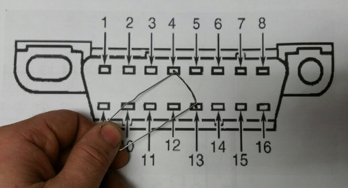

Hello Ken,
Unfortunately, with another cluster same symptoms.
There is only left ECU or wirings under dash.
Any advice what else to check?
Thank you
Saturday, April 20th, 2024 AT 11:09 AM
KEN L
  • MASTER CERTIFIED MECHANIC
  • 55,248 POSTS
You are on the right track, wiring or ECU, if the wiring has not been messed with I would say the ECU is bad, you can send it in for testing by searching google or ebay.
Sunday, April 21st, 2024 AT 10:47 AM
MUSTK
  • 26 POSTS
Only testing cost at least twice more than purchase used, I purchase used one - 3 times less than test only, even there are any issues, I can return, low chance it would be same problem. Sync with immobilizer - short on OBD port pins 4 and 13 for 30minutes. Only downside - VIN number from donor, however I can re-solder chip later if would needed. As always, I'll keep you updated. Thank you!
Monday, April 22nd, 2024 AT 10:32 PM
KEN L
  • 55,248 POSTS
You are welcome, please let us know.
Tuesday, April 23rd, 2024 AT 10:05 AM
MUSTK
  • 26 POSTS
Hello Ken,
Yesterday I replaced the ECU, it did not sync with the immobilizer, so I was unable to start the vehicle, but changing lever correctly shown on cluster without delays.
Today I transfer IC900 chip from original ECU to "new" and will test it next week, will keep you updated.
Thank you!

MUSTK
  • 26 POSTS
Hello Ken,
Seems it is working.
I was able to start the vehicle, change gears, and all seems OK.
Unable to drive it today, but next will report final tests.
Thank you for your support!
