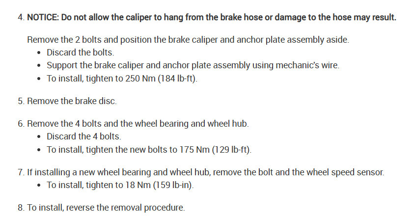

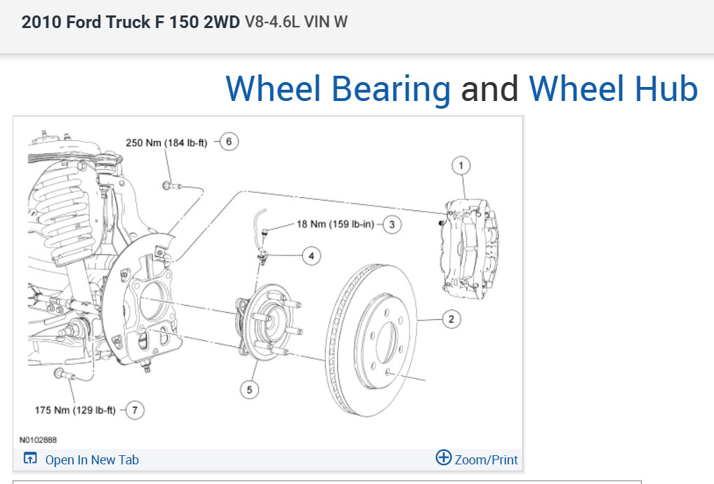

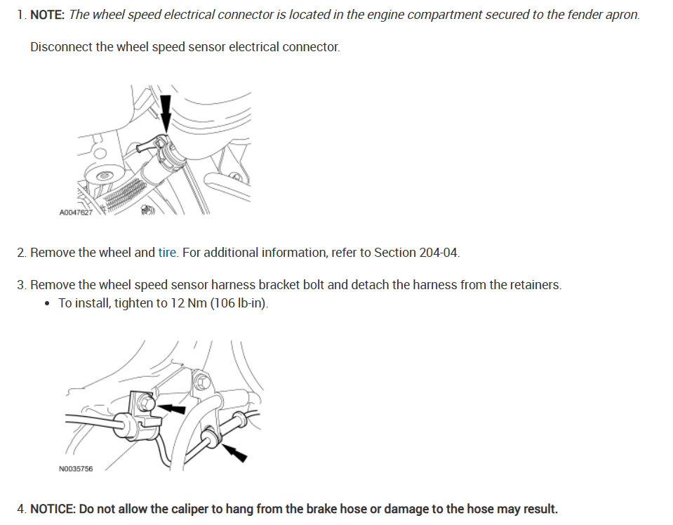

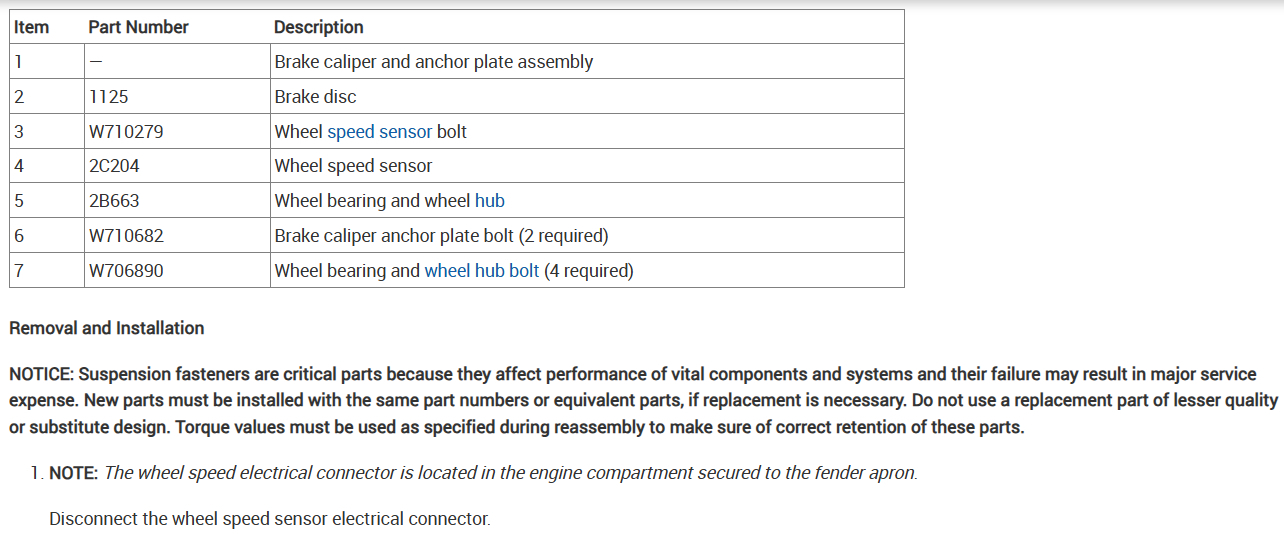

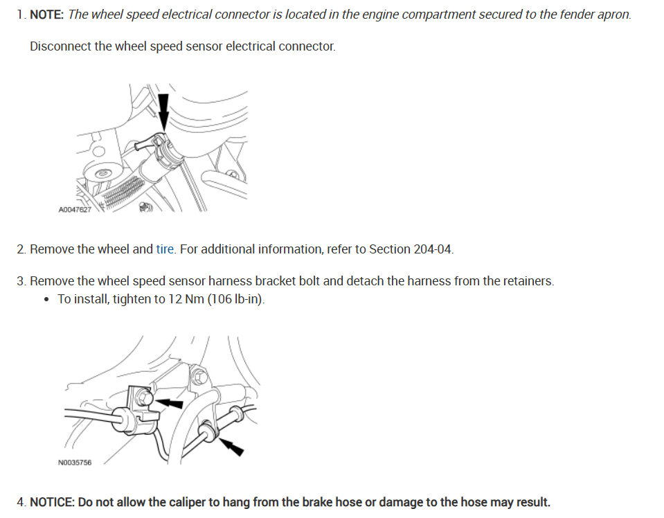

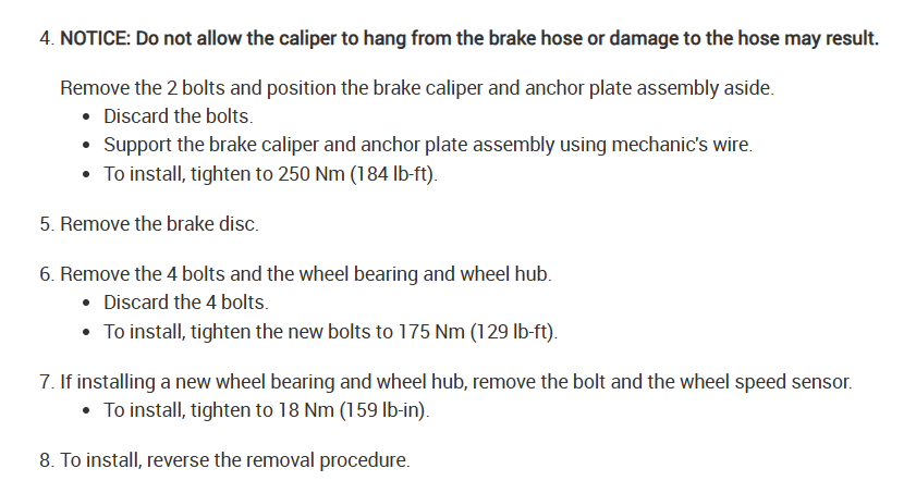

The diagnostic trouble code (DTC) C1296 in your 2010 Ford F-150 indicates a Left Front Wheel Speed Sensor Input Signal Fault.
So This code can be caused by a bad wheel bearing hub which will cause the reluctor wheel for the ABS sensor to misalign with the sensor causing the code. Here is how to change out the bearing hub which should fix the problem. Check out the images (below). Please let us know what happens.
Check out the images (below). Please upload pictures or videos in your response of any problems so we can see what to help you with.
