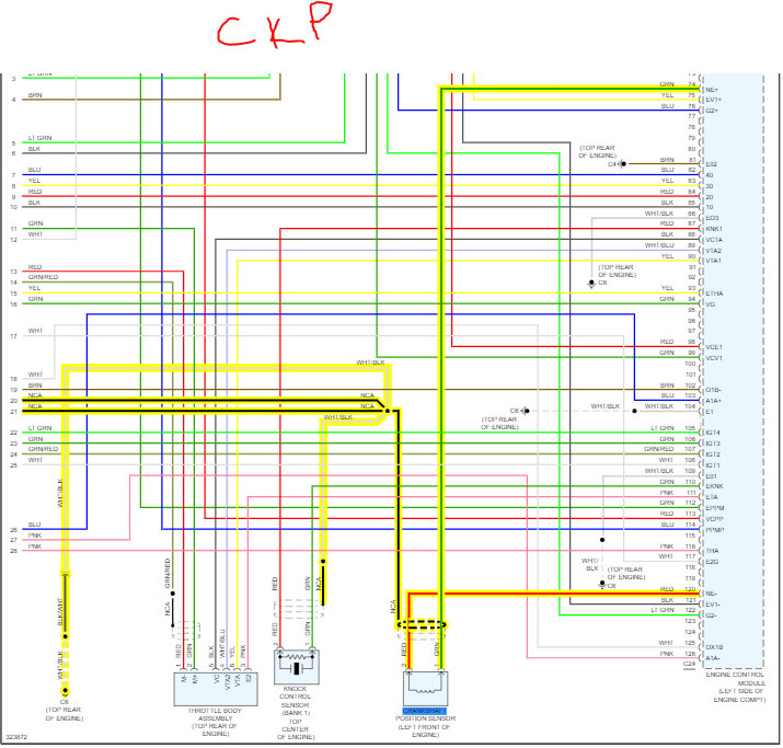

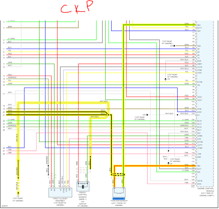

Please, I need the correct wiring to my crankshaft sensor and camshaft sensor. The socket is broken, and the technician is unable to harness the correct color codes for the socket.

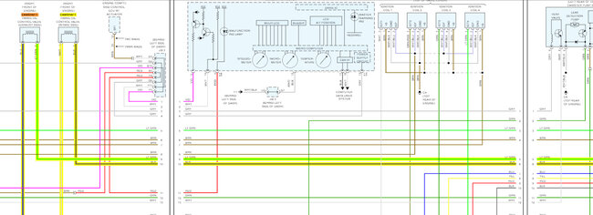

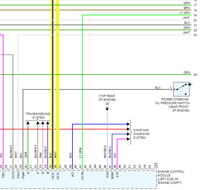

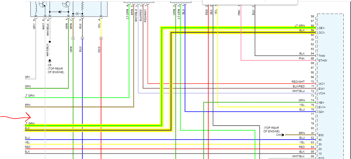

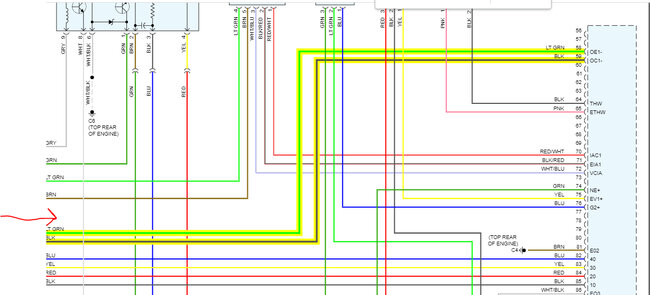

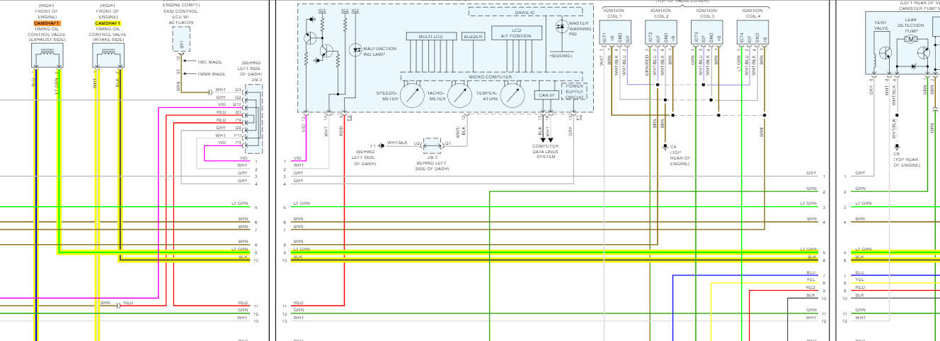

I attached pics below of the crankshaft position and camshaft position sensor wiring. Pic 1 is the crankshaft sensor. The remaining pics are for the camshaft position sensors.
Let me know if this is what you needed.

Thanks a million, this answer was totally helpful beyond what I can describe in words.
