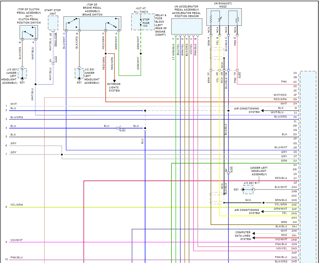

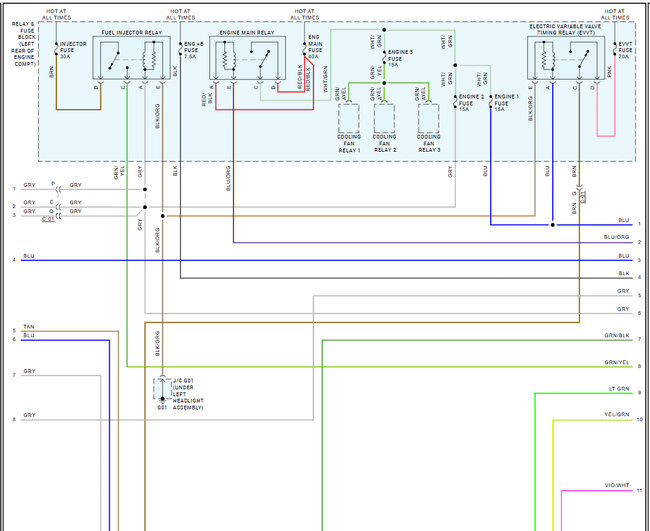

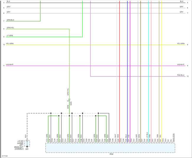

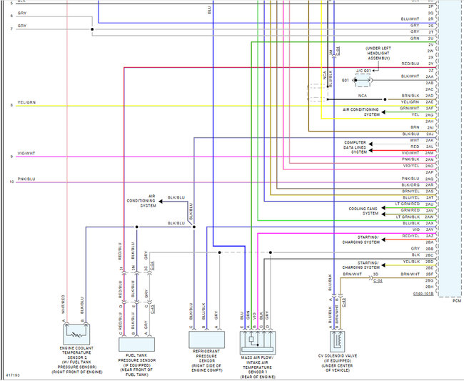

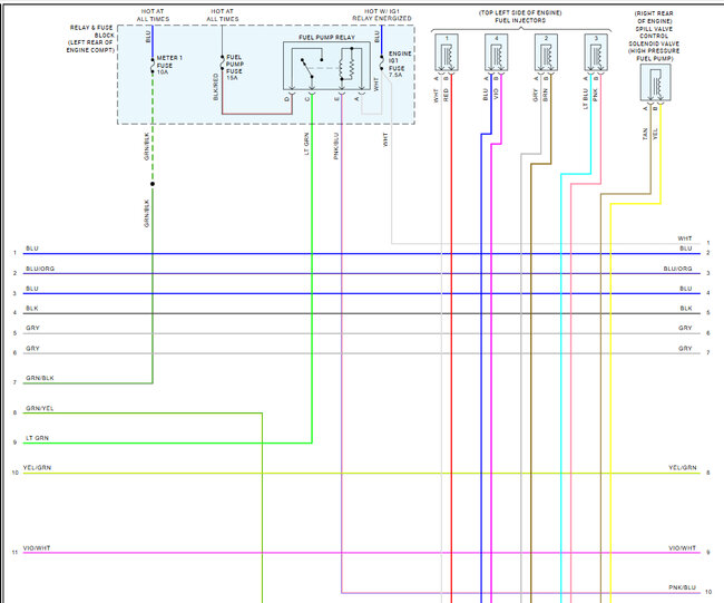

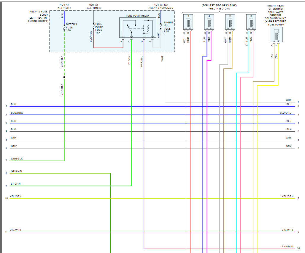

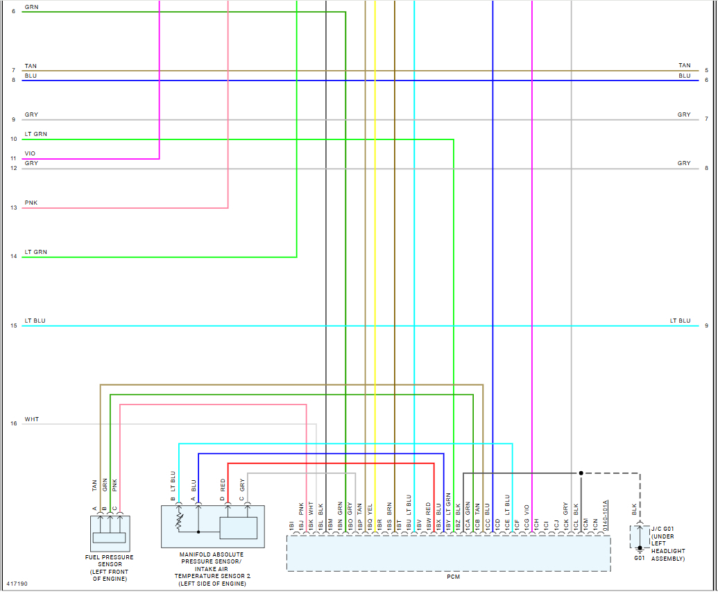

Hi Ken, please could you help me with the engine wiring diagram. Some signals just don’t match. Car keeps reporting errors and after parts are replace it still complaints.
Please any wiring regarding this model, will go a long way.
Sep 16, 2025 at 8:25 AM
  • 54,494 POSTS

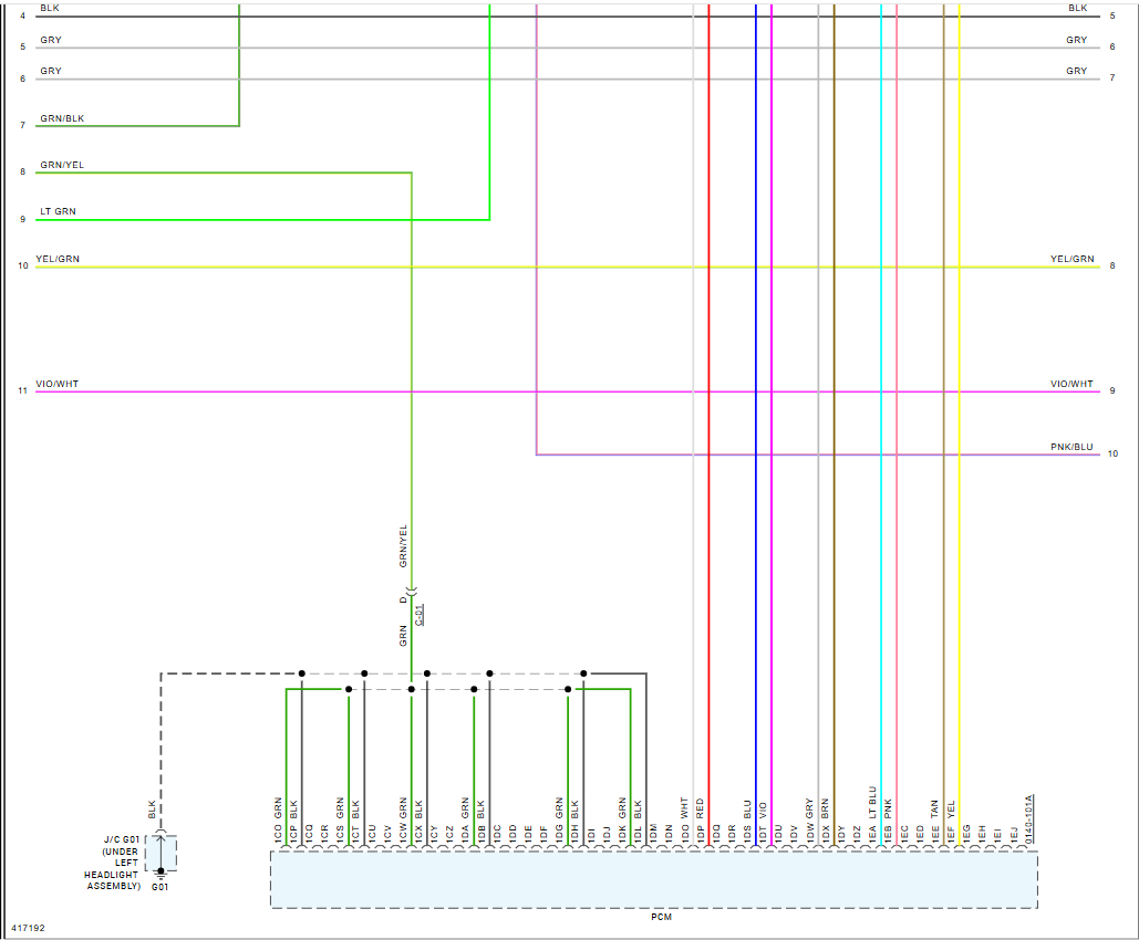

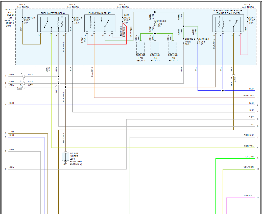

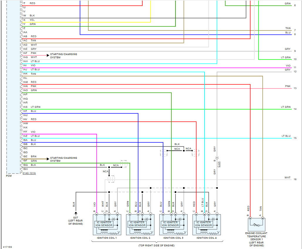

Hi Andrin,
Yep, here are the engine wiring diagrams for the 2.0 liter as requested. Check out the images (below). Let us know what you find.

Hi Ken. This model is Diesel engine I need. It looks the diagram you sent to me is Petrol engine.
Sep 16, 2025 at 10:12 PM
  • 54,494 POSTS
They don't offer a diesel engine in the US, sorry.
