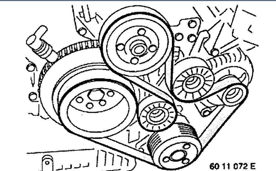

It sounds like you have a loose belt. Does it feel tight? Also, how many belts are on the vehicle? One manual shows me one serpentine belt, and another shows me a total of three belts.
Next, if possible, record the sound and upload it for me to hear. If there is more than one belt, take a small amount of water and while you hear the noise, one belt at a time, pour a little water on them. Pay attention to which belt changes pitch when water is on it.
Let me know. Also, I attached a pic below. Let me know if that is the design you have.
joe
See pic below.
