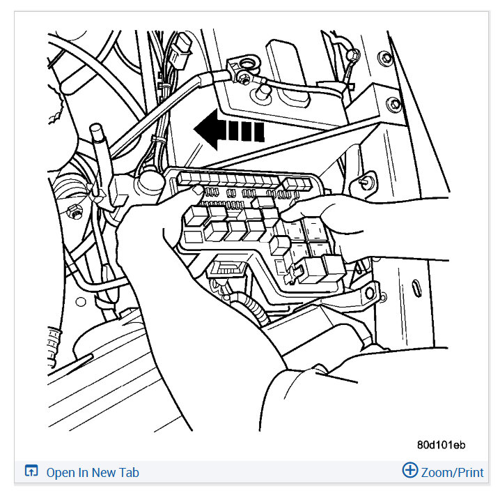

My neighbor is working on this truck, and we are stumped.
Truck will crank and run fine, then after about 20 minutes or so, it will shut off entirely. The gauges on the dash will move back and forth then there is a clicking under the hood. Upon inspection, relays 57 and 58 in the fuse box are clicking. Fuel pump is also clicking on and off. Truck will do nothing until it sits for around 30 mins then it will fire right up and be good for another 20 mins or so. Unhooking the battery doesn't reset anything, you still have to wait the full 30 minutes before you can crank it again.
We tried another battery and even tried another fuse box (I think the computer is attached to the fuse box so it's a new computer too). Is this something with immobilizer system?

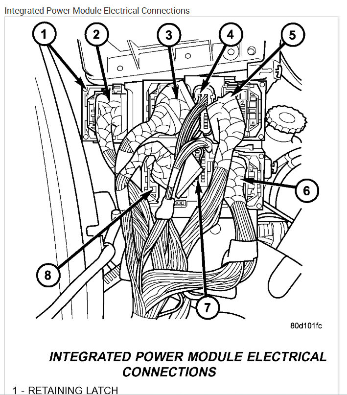

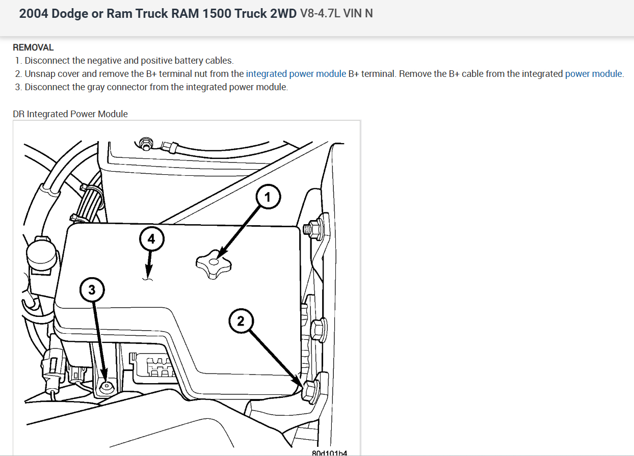

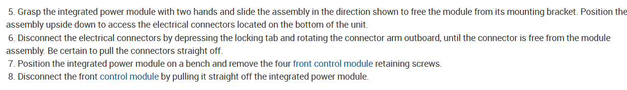

So the part you replaced was the IPM? These have a high failure rate FYI, also please check the ground from the battery to the engine and then to the chassis. This truck must have a good grounding system, so electronics don't back feed and overheat. Here is the part in question. Also, we should check to make sure the alternator is not throwing AC voltage due to a bad diode.
Relay #57 - Auto Shut Down (ASD) Relay:
Relay #58 - Fuel Pump Relay:

So did you replace the fuse panel under the hood? (IPM). Also, I would still check the grounds from the battery to the chassis and to the engine. Is there any other bad wiring under the dash?

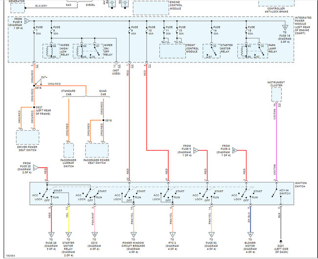

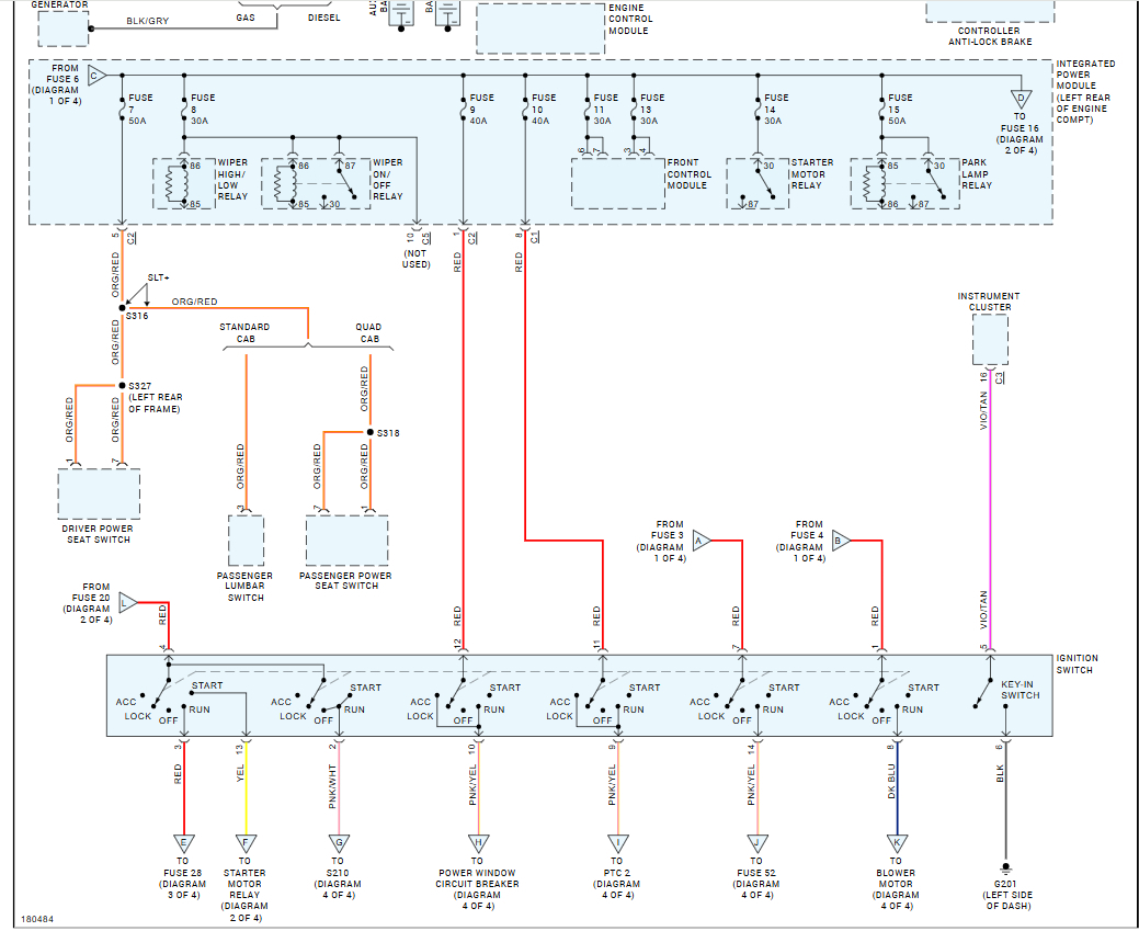

Yes the owner did provide another IPM, but issue persists with both the old and new one. The grounds from the battery to the chassis seem okay, but there could be an issue with the wiring in the dash since sometimes removing the key with the door open the chime doesn't stop beeping. Could this be an issue with the ignition switch?
Monday, March 10th, 2025 AT 8:49 AM
KEN L
  • MASTER CERTIFIED MECHANIC
  • 55,488 POSTS

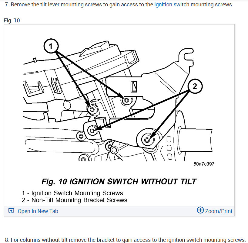

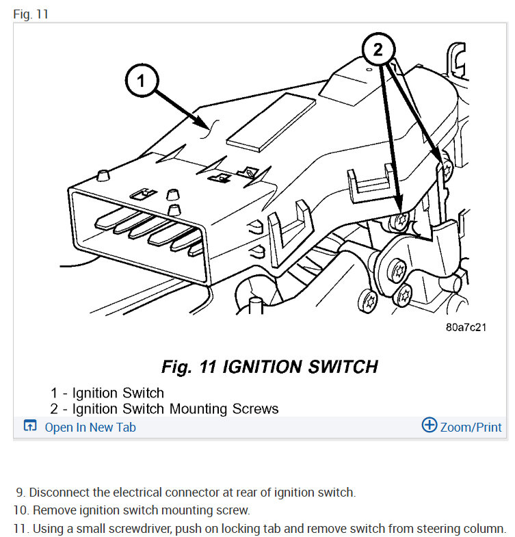

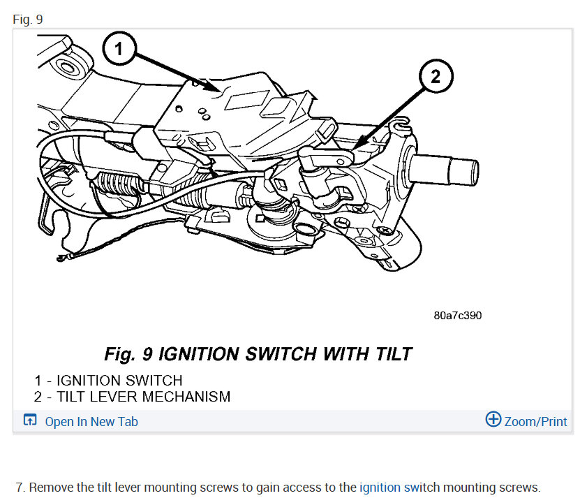

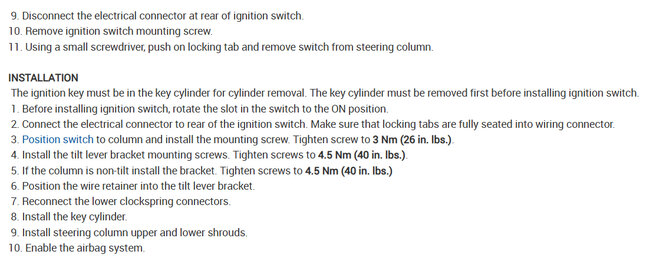

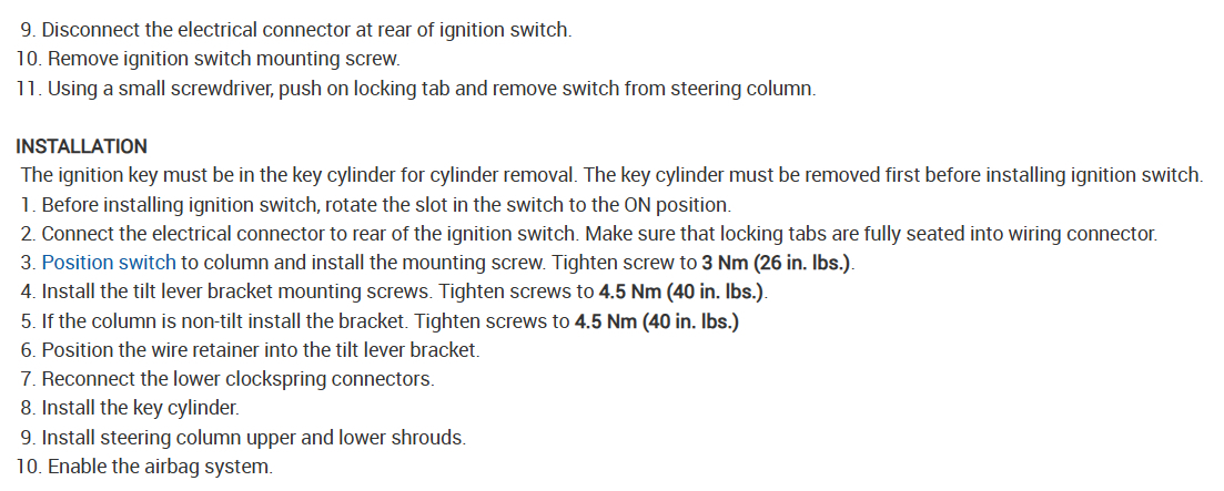

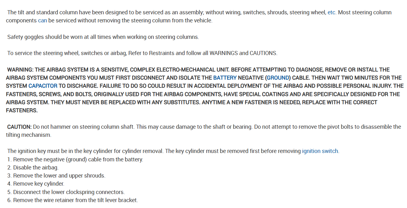

Yes, it could be and the ignition switch is a common failure. Here is how to change the switch out and a guide to help you test inputs and outputs, I have also included the wiring diagrams as well for the ignition switch.
Check out the images (below). Let us know how it goes.
Monday, March 10th, 2025 AT 10:38 AM

Sorry for the late reply. All the janky wiring has been fixed, and the ignition switch replaced. Still same issue. We noticed when it's clicking, the fuel pump is also making a wizzing sound. Makes sense since on of the relays that's is clicking is for the fuel pump. We are going to try replacing the fuel pump/sending unit and see if that fixes it.

Sorry for the late reply, but we did finally get it fixed. We had to replace another computer box on the passenger side of the truck, I forgot what it was called. There was a short in the old one.
Tuesday, December 23rd, 2025 AT 6:26 AM
KEN L
  • 55,488 POSTS
Thanks for getting back to me, was it called a TIPM? Glad you got it fixed.
