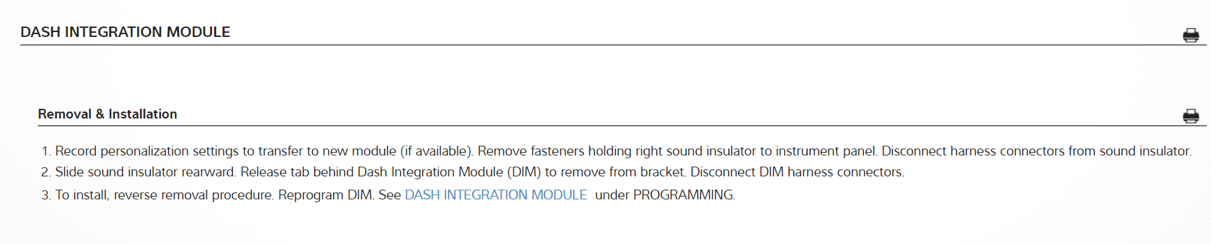

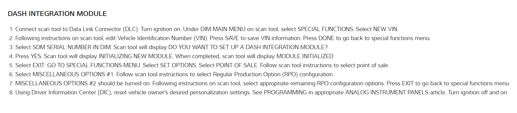

This sounds like you have a dash interrogation module going out. To be sure here is a video that shows how to scan the CAN system you can get a scanner for about $40.00 on Amazon. I have also included how the change out he BCM in the diagrams below.

Yep, modules can cause all kinds of weird issues. Let me know when you get the scanner. Also there is a drivers door module as well (DDM). Which may cause the issue as well.

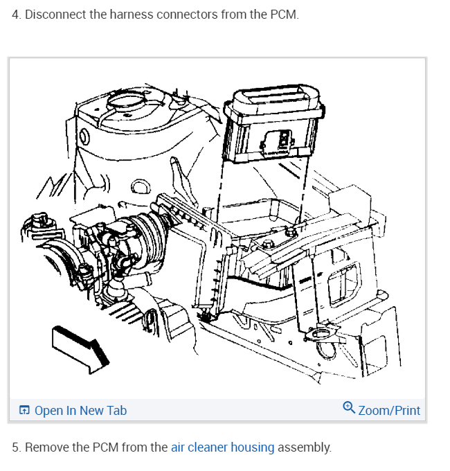

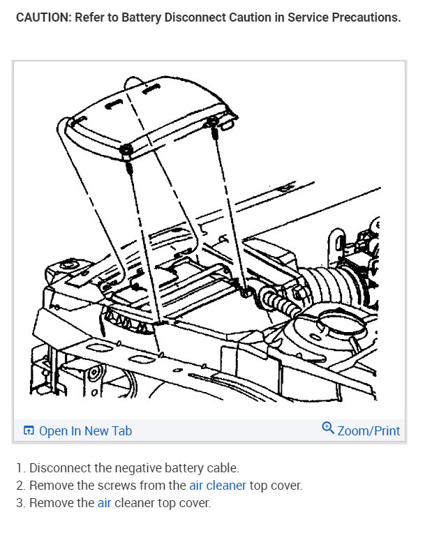

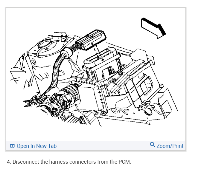

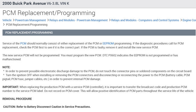

The U1040 is the key - U1040 Chevrolet code.. Cost of diagnosing the U1040 Chevrolet code.. The Power-train Control Module (PCM) communicates over the Serial Communication Protocol (SCP) bus network, or J1850 bus.
Sounds like the PCM is bad here is the location and how you replace it.

Ken sorry to take so long, I got used PCM programmed to my VIN, it took 5 tries to program key, but it works! Now I have to drive for a while to see what it fixed and what it didn't fix. Thanks for your help! I will let you know!
