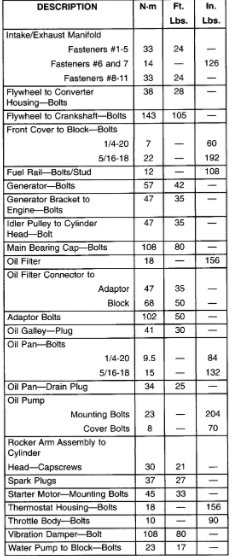

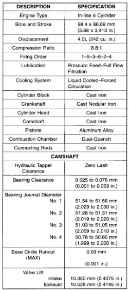

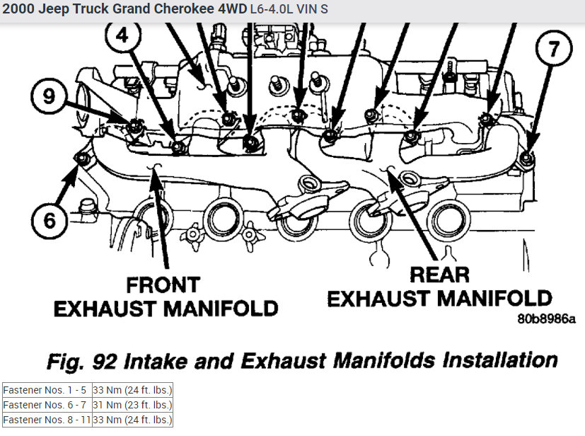

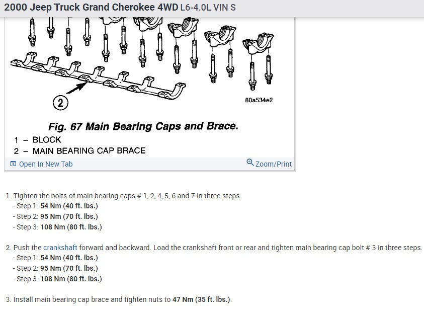

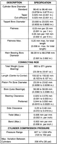

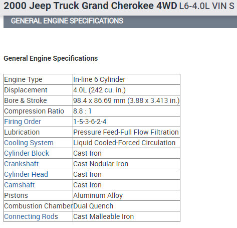

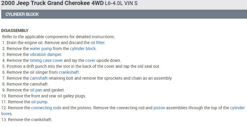

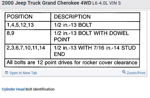

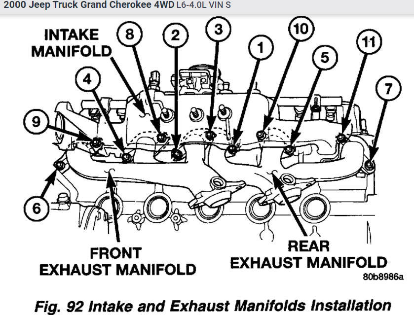

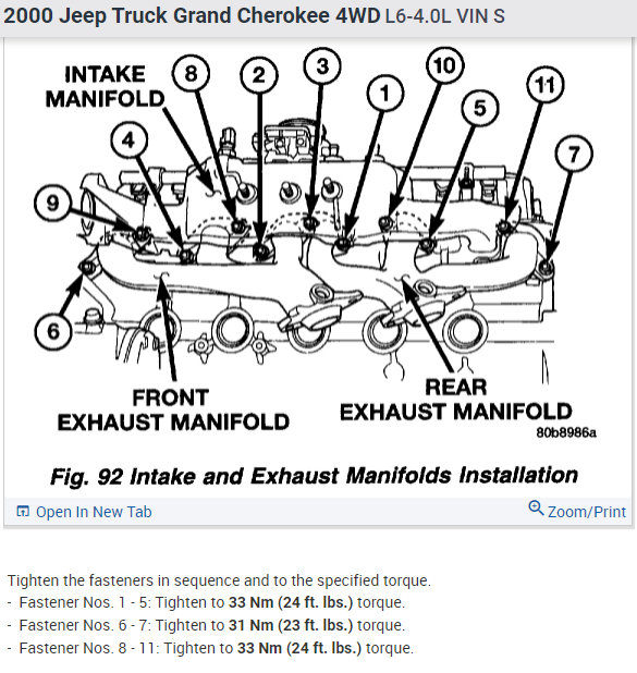

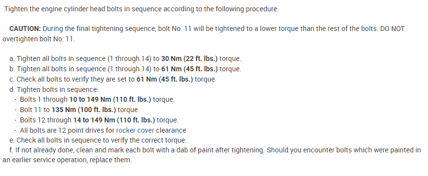

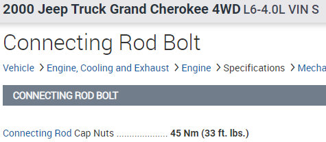

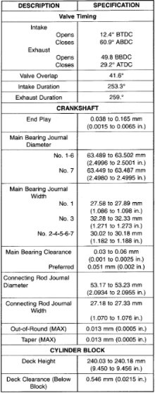

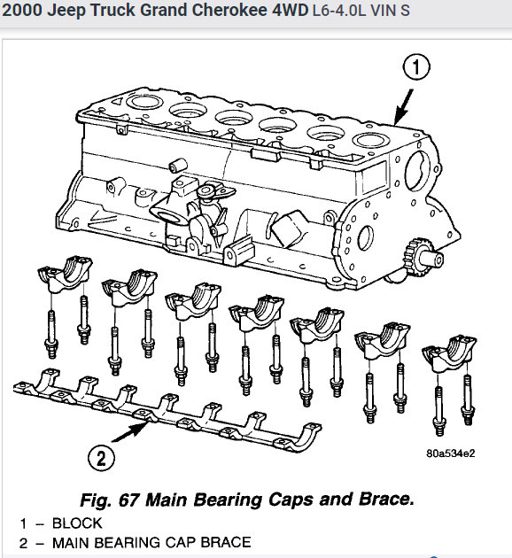

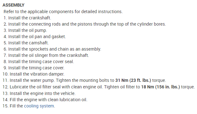

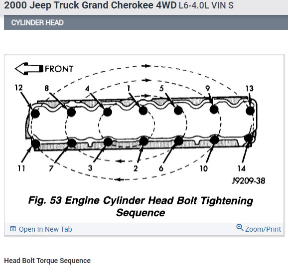

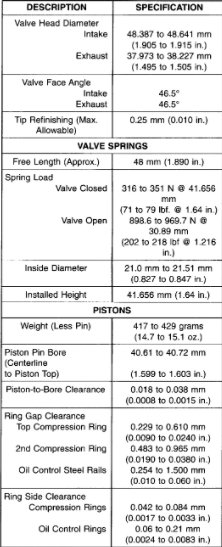

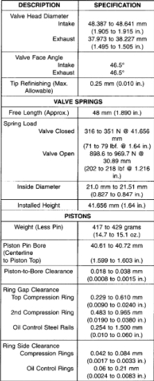

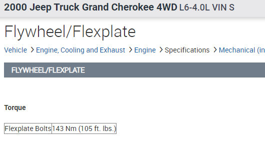

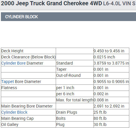

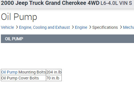

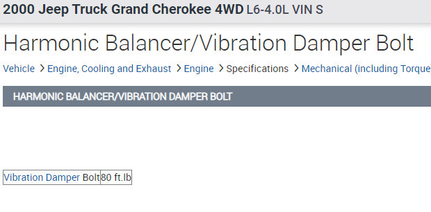

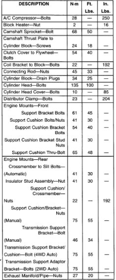

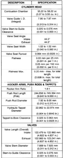

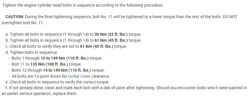

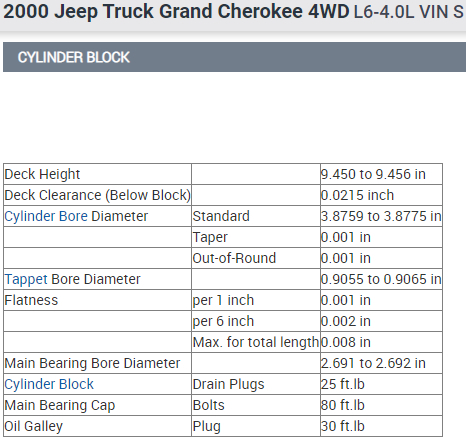

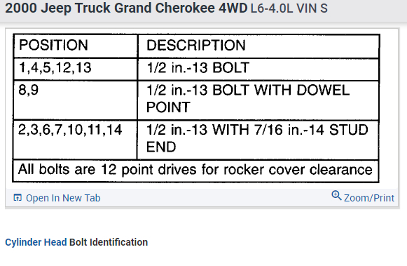

Rebuilding engine need torque specs and order of tightening from connecting rod caps up to head, manifold, springs, pretty much the whole motor. thanks for your time and input.
Jul 17, 2021 at 11:51 PM
SQM
  • 6,383 POSTS
I have attached all the torque specifications and sequences for your Jeep.
Please let me know if you need any other info.
