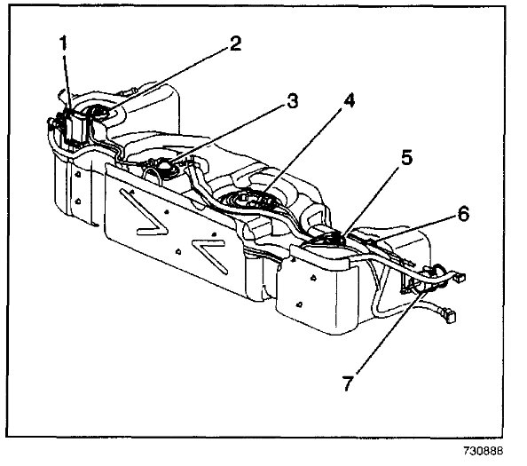

The vehicle runs descent until I stop and then try to go, very slowly to roll out. Sometimes when I'm at a stop it will cut off. I would like to know where speed sensor is located, oh yes, sometimes when driving I have to go to 1st gear then 2, 3 then drive. Thanks. Add images please.

Don’t know what the code was, I will take it to the auto parts store and recheck. All gauges are good, but the back end of the SUV smells of a lot of fuel.

If you have a fuel leak, that can cause a power loss. Do you have anything under the vehicle that is wet or stained indicating a leak? The fuel line runs across the top of the fuel tank to the fuel filter. See pic below.
See pic below.
