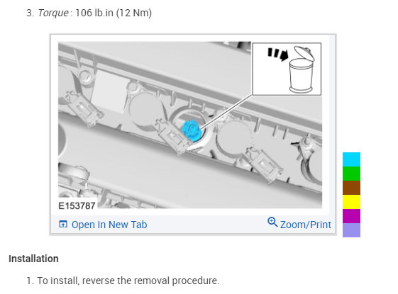

Hi to you, this may concern I'm having an overheating problem on my car listed above. I've been trying to locate the coolant sensor or a few days now, this is the code that popped up when i put the ob2 reader on (p1299).
Aug 26, 2022 at 10:47 AM
  • CAR REPAIR CONTRIBUTOR
  • 110,193 POSTS

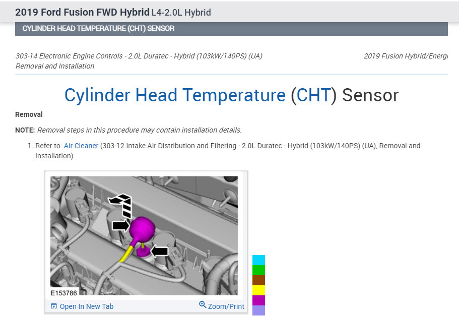

The code is related to what is called a cylinder head temperature sensor (CHTS). This is located at the center of the valve cover top, between cylinder 2 and 3 ignition coils.
I attached the directions below for replacing one. However, when the engine is cold, make sure the coolant level is full.
Let me know if that takes care of the problem.
