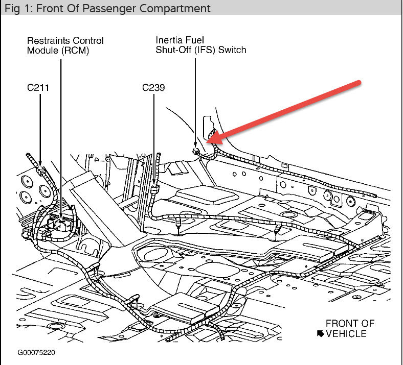

Apr 2, 2017 at 11:03 PM
HMAC300
  • CAR REPAIR CONTRIBUTOR
  • 48,601 POSTS
see picture.

ABAYOMI
  • 10 POSTS
I guess from the picture, will be able to see the switch when i open the hood?
Apr 3, 2017 at 6:52 AM

HMAC300
  • 48,601 POSTS
the inertia shuts off fuel when shaken to much or in an accident. the area of the pic is right kick panel on passenger side of interior of truck. In my opinion you should have a regular mechanic look at this as I see no replies to what I have sent as far as fixing the truck.
