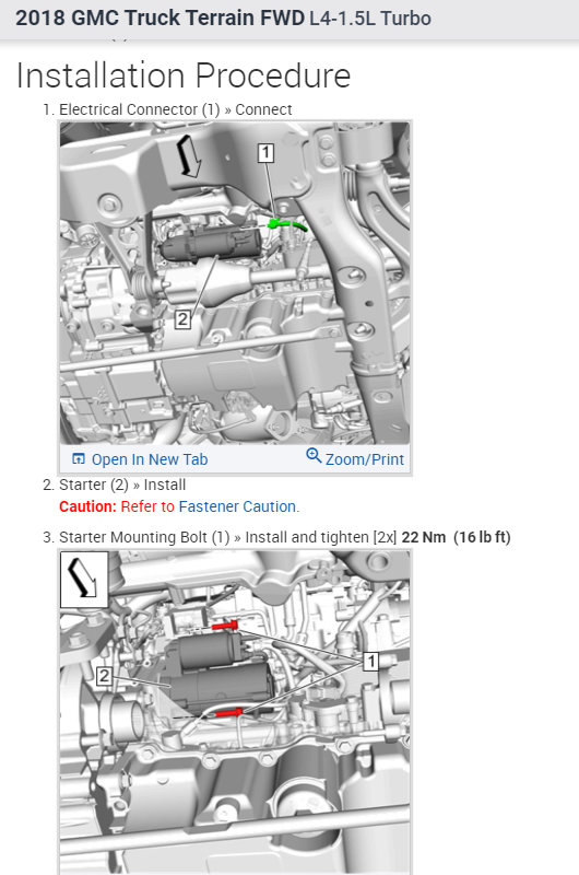

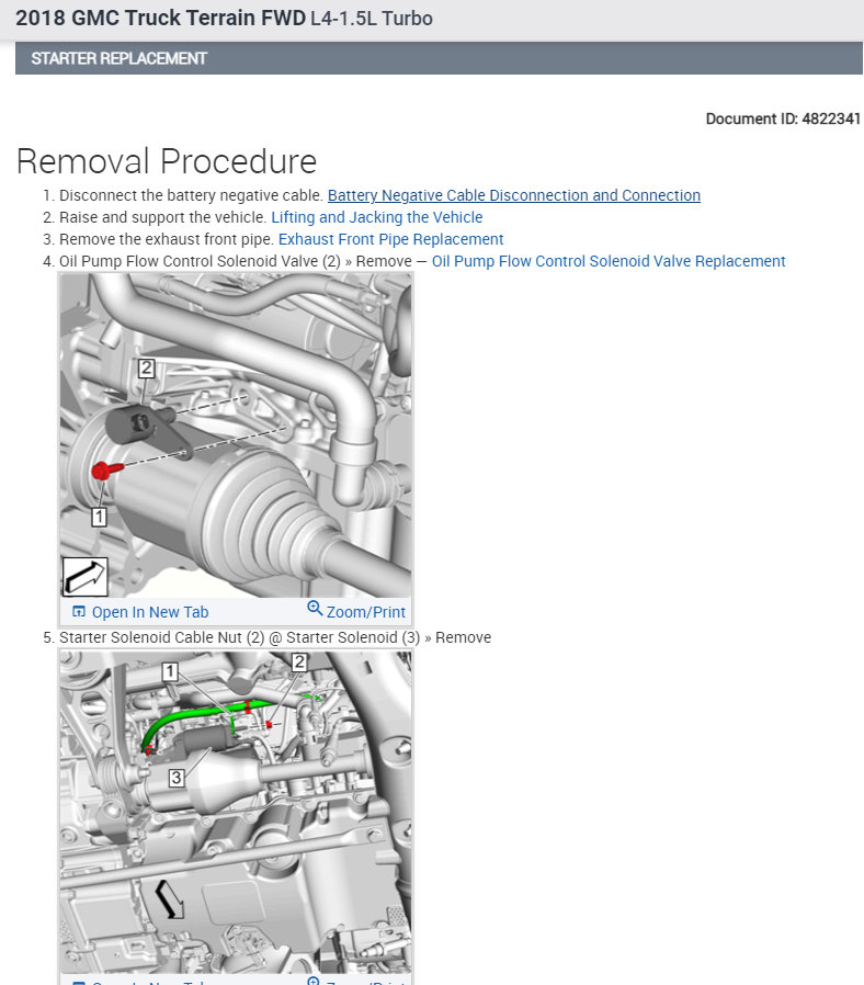

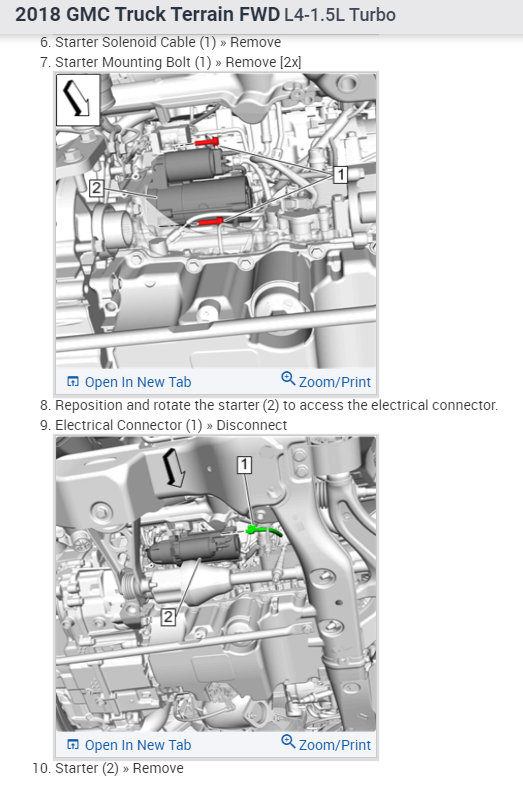

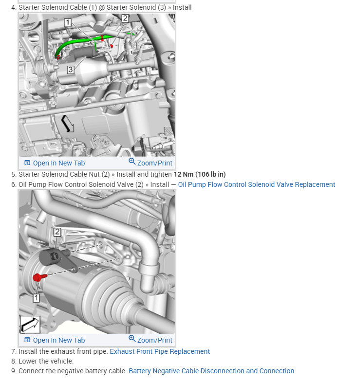

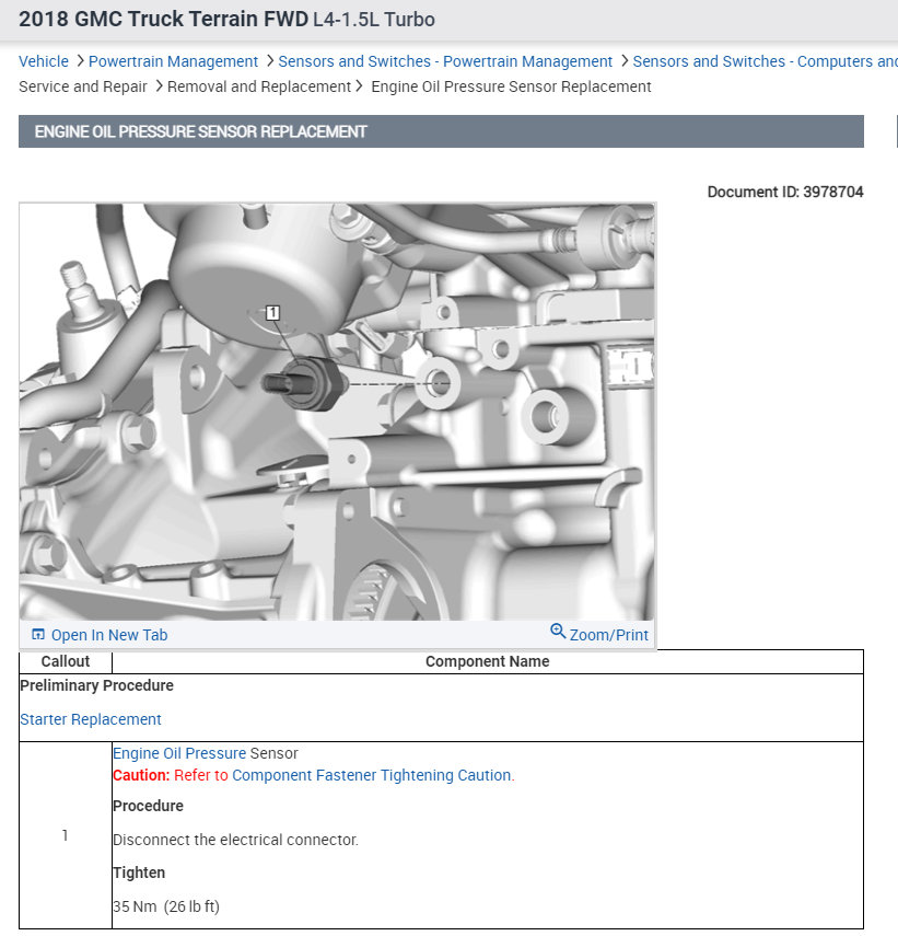

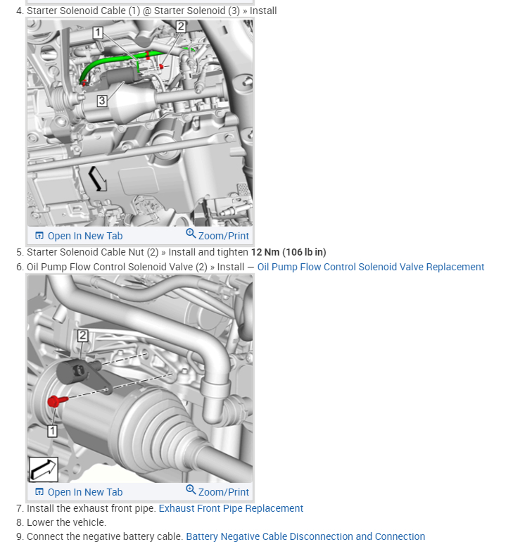

I can’t find the location of my engine oil pressure sensor and I’ve looked for hours from the top and bottom.
Friday, May 20th, 2022 AT 9:21 AM
SQM
MECHANIC
6,383 POSTS
The oil pressure sensor is located behind the starter. To replace it the starter first needs to be removed.
I have attached diagrams below for your reference.
Let me know of any questions.
