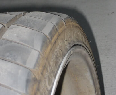

I believe I heard it. It is a deeper growing sound, correct? Please understand, listening to a recording can change things, but to me, it sounds like a wheel bearing. Pay close attention when turning if it changes the sound. If it does, let me know how it changes and what direction you are turning.
Also, make sure the front tires aren't cupped. Make sure they are worn evenly. See pic below. Note that the edge of the tire has both high and low spots. That can cause this type of noise as well.
See pic below.
