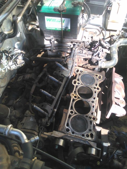

I just change head gasket for this car, it is failing to start and when it starts it struggles to idle and turns off. What could be wrong?

It sounds like you have the timing belt off a tooth.
Here is a guide to help you double check the camshaft timing;
https://www.2carpros.com/diagrams/mazda/protege/2001
