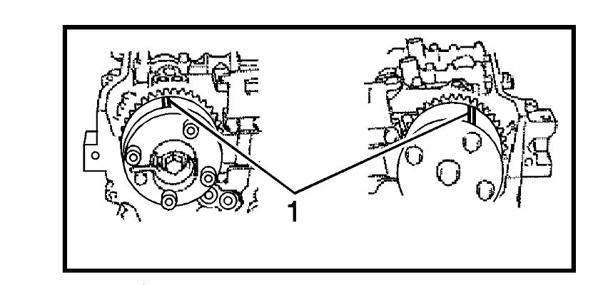

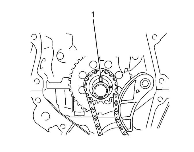

Good morning,
What are the codes?
From the looks of the compression, you may have a timing issue between the cam and the crank.
https://www.2carpros.com/articles/the-reasons-for-low-compression
What did the shop tell you?
Wednesday, December 4th, 2019 AT 7:00 AM

Is the check engine light still on.
You need someone who will do a proper diagnostic and tell you the issues
I think you need a timing chain
Wednesday, December 4th, 2019 AT 2:22 PM
