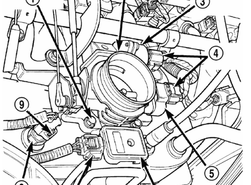

Engine light is intermittent code read retrieval P0122, P0123, P0121
What are these codes translate please

The codes relate to throttle position sensor. I usually want to check sensor wiring circuits first. Ref voltage--ground and signal wires. You can use digital multimeter, backprobe signal wire, key on, no need to start it, check that the voltage readings on the meter move up and down smoothly, no glitches or cutouts on the reading. If all that checks out, I don't see the problem, at the moment.

Move the throttle with your hand, open and close, notice the readings.

Where's the location for the throttle positioning sensor?

The tps is on the throttle body. Number 5 in the picture. The add image link didn't seem to work. I'll try something else.

It's number 5 in the picture.

Thanks so much for the image hey greatly helps I will keep you posted on the outcome with greatest sincerely Richard
