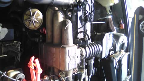

Yeah, thanks. The car started again on the third try and ran it for about 20 minutes with both sensors plugged in and RPM's did go low a couple of times and gave it gas to keep it running. Did adjust idle a bit higher but still had the same problem. Did disconnect EGR valve with no difference, because it still had same problem.
Friday, June 19th, 2020 AT 6:21 PM
PALOSBB40
  • 53 POSTS
Video.
Friday, June 19th, 2020 AT 7:06 PM
