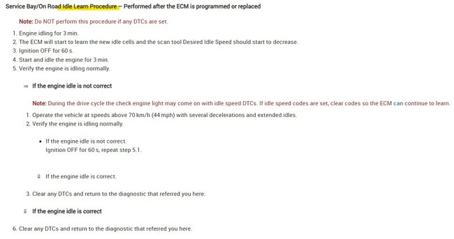

So my best bet would be getting a new TB from GM. I just need to be able to clear the codes so it can do a relearn?

Once you get the codes cleared, you can follow this throttle relearn procedure, this is the non-scan tool procedure to be done if the throttle body is cleaned or replaced. Can you read live engine data with the key "on" with that scan tool? The communications from the data link connector looks to go through the body control module then to the ECM. But at least you weren't reading any voltages on the TB wiring, you may try checking the yellow wire and the brown/white wire each (with the key Off) for any shorts to ground, but it sounds like the original TB was actually physically broken inside, with stuff bouncing around inside.

I purchased a new throttle body, was able to clear the codes using the scan tool, and then ran through idle learn procedure you posted. It's been 3 days, and the car is running great. Thanks!
