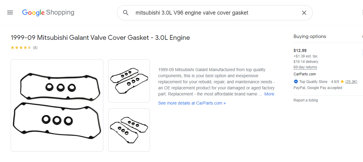

BRIAN ONEILL
Thanks,
I need to replace the Valve cover Gaskets and the Spark Plug Tube seals, but I cannot find parts specific for V93 to closest I can find is V73 (Mizumo Auto MA-4216904330 Valve Cover Gasket Compatible With/For MITSUBISHI 6G72 6G73 6G74 6G75). I cant seem to be able to confirm if the V73 are Compatible, (my Engine 6G72 V93) specifically the Spark Plug Tube Seals, as these really need replacing.
Any advice would be welcome.

I'm not sure where you are located, but I looked through multiple Mitsubishi 3.0L V6 engine valve cover gasket kits and they do all look the same. The Pajero isn't offered in the US, so that is why I'm struggling, and I can't find anything that specifically identifies a V93 engine.
Take a look at the pic I attached below and let me know if that appears to be the correct design.
See pic below.

BRIAN ONEILL
Thank You, I agree all the 3.0L do look similar, only time and $17.99 will tell :-)

  • CAR REPAIR CONTRIBUTOR
  • 110,190 POSTS
Brian, if you can, let me know if that is the correct one. They change one small thing on an engine and rebrand it as something different. LOL
