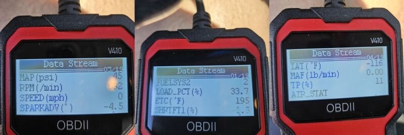

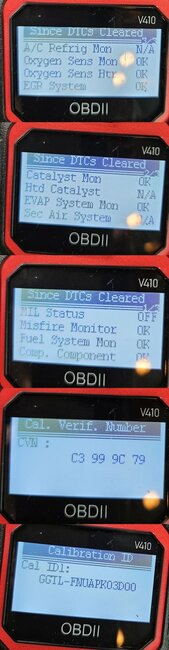

I got another reader because my old one would not exit. Anyway. Here are the pics off the new reader

It still sounds like you have a vacuum leak, did you get the smoke machine and try it? If you can get the long and short trim values I can tell you if the engine is lean or not. It seems like it can be the intake manifold gasket is leaking. Please let me know.

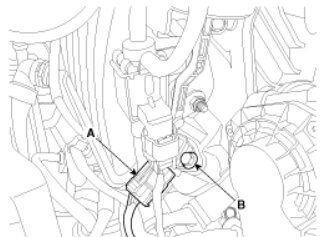

Can you get the long and short fuel trims so we can see what the computer is doing? It sounds like the MAP sensor is weak, also can you pull the spark plugs to see what color they are? Here is the location of the sensor so you can check it out.

Plugs are brown. MAP was replaced with the throttlebody. I will ask him if his reader will do trims and bring to me on Wed. Thanks

When installing the sensor did the O ring seal get replaced/installed? This is what seals the sensor to the vacuum. Also, be sure there is no exhaust leak as well, this can allow fresh air into the exhaust system and fool the computer which can lower the idle. Please go over this guide as well

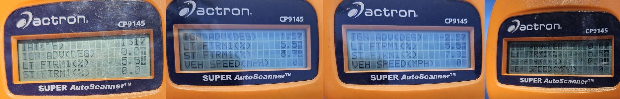

Yes new o-ring used. No sign of exhaust leakage. Here are pics of the reader. Note the two which show the TRIMs LT ST reflect the ST changes but not the LT.

I am sorry I cant read any of these they are two small. Can you break them up please?
Thursday, August 7th, 2025 AT 5:55 PM
MIKELINE
  • 12 POSTS

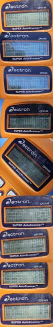

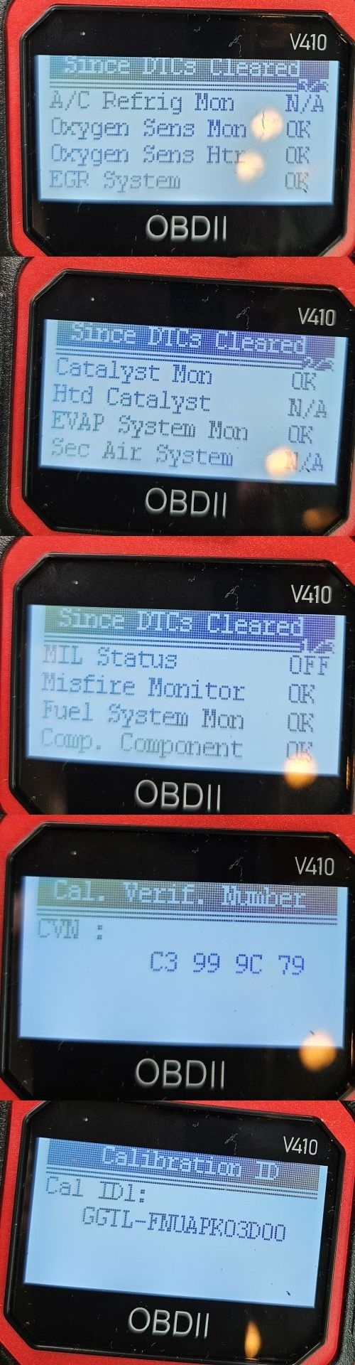

I put four in a row. I hope that helps
Thursday, August 7th, 2025 AT 6:31 PM
KEN L
  • MASTER CERTIFIED MECHANIC
  • 55,512 POSTS
Thanks you, okay it was like I thought, the PCM is thinking the system is lean, here are choices for the cause and a guide as well.
