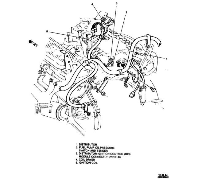

One of the most common issues is the ignition module. It is inside the distributor.
Remove the cap and rotor and it is held down by two small screws.
You can then take it to a parts store and they can test it for you to verify the failure.
