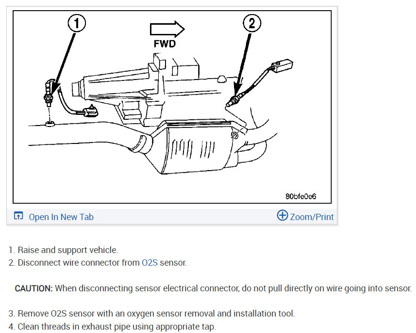

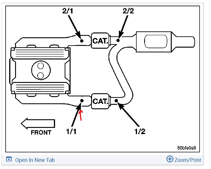

stopped at stop sign would not start code reader p1035.
Aug 14, 2024 at 9:47 AM
  • CAR REPAIR CONTRIBUTOR
  • 54,452 POSTS

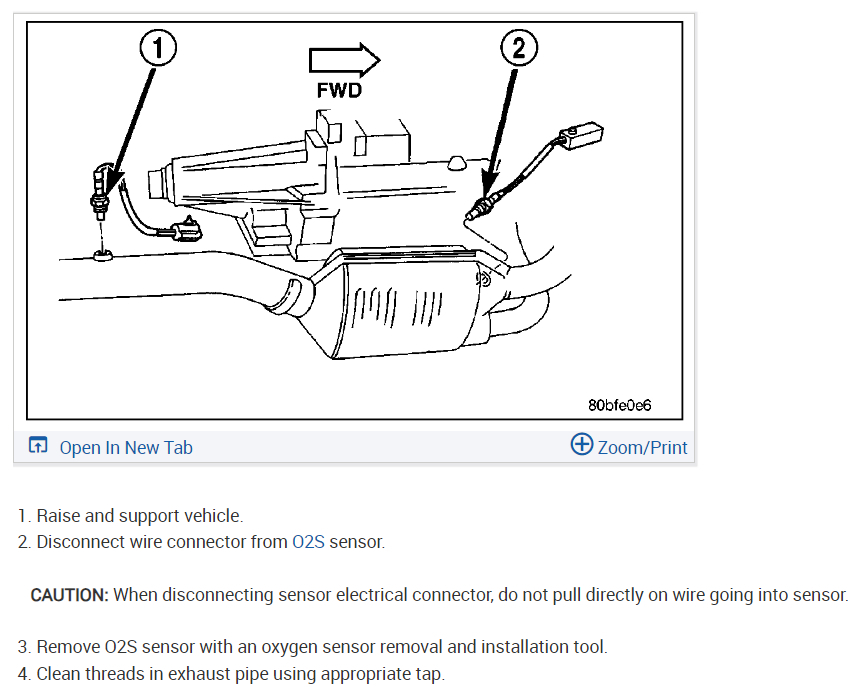

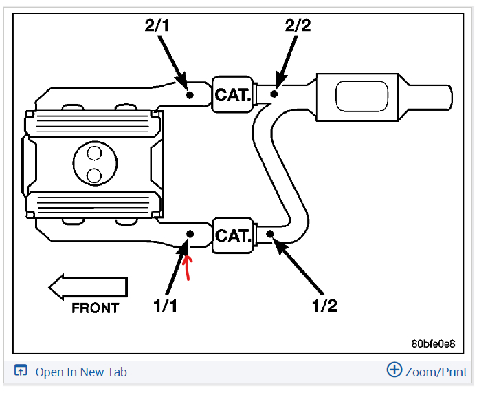

The code P1035 for a 2006 Dodge Ram refers to an issue with the Heated Oxygen Sensor (HO2S) Heater Control Circuit for Bank 1 Sensor 1. Here is a guide to help you change it step by step with the location of the sensor in the images below:
https://www.2carpros.com/articles/how-to-replace-an-oxygen-sensor
1. Install O2S sensor. Tighten to 30 N.m (22 ft. lbs.) torque.
