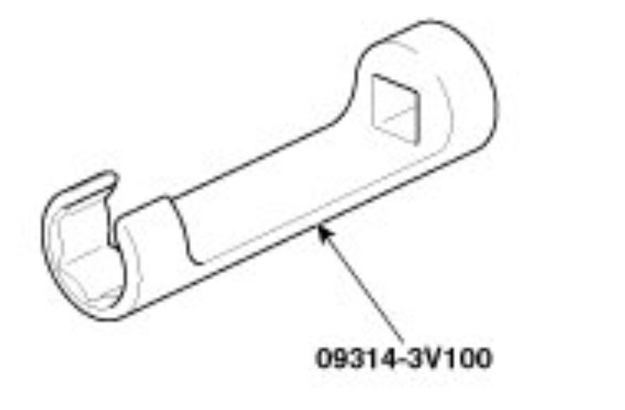

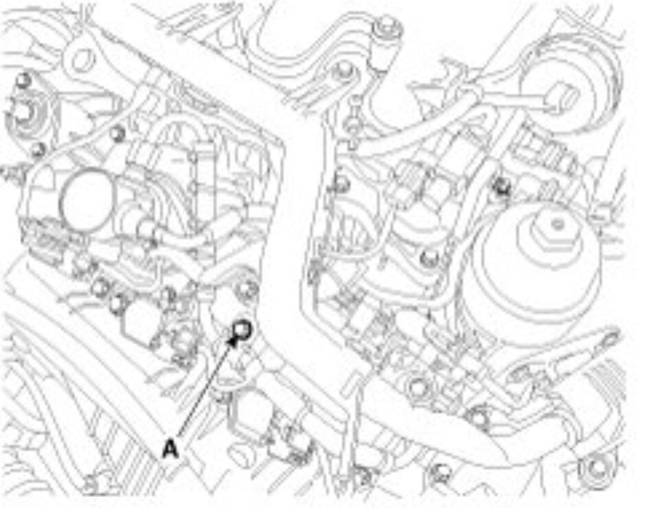

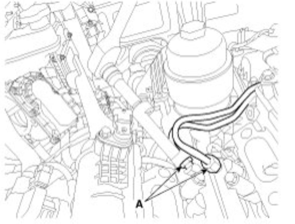

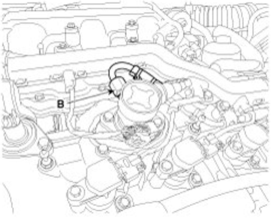

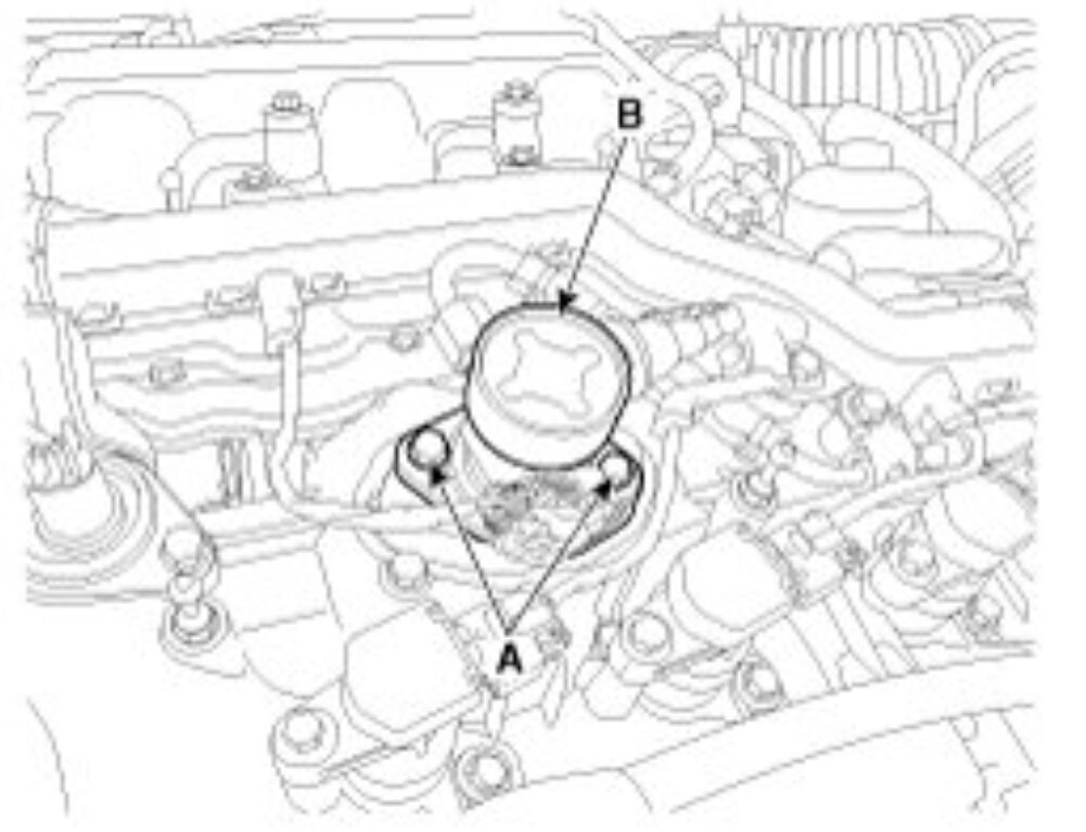

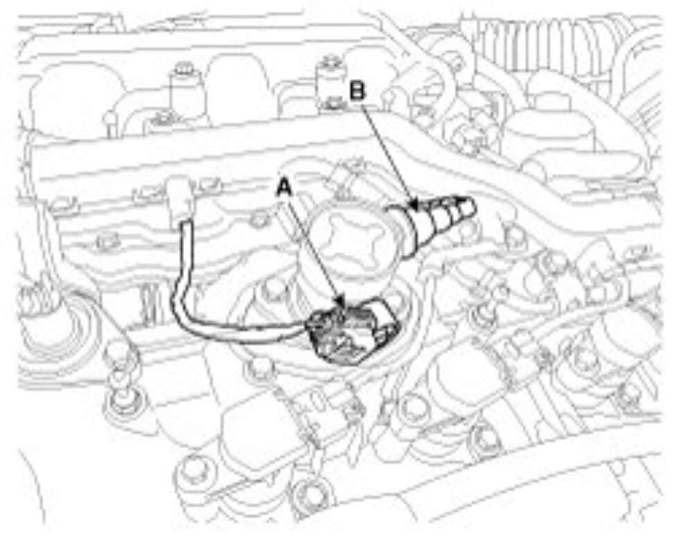

Thanks for clarifying, the Hyundai Grandeur is also the Azera in the United States. I will list the procedures for the high-pressure fuel pump removal below, with pictures attached at the bottom. Please let us know if you have any further questions. Thanks!
Removal
WARNING:
In case of removing the high-pressure fuel pump, high pressure fuel pipe, delivery pipe, and injector, there may be injury caused by leakage of the high-pressure fuel. So don't do any repair work right after the engine stops.
1. Turn the ignition switch OFF and disconnect the battery negative (-) cable.
2. Release the residual pressure in the fuel line.
CAUTION:
When removing the fuel pump relay, a Diagnostic Trouble Code (DTC) may occur.
Delete the code with the GDS after completion of "Release Residual Pressure in Fuel Line" work.

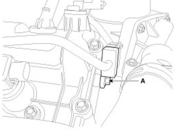

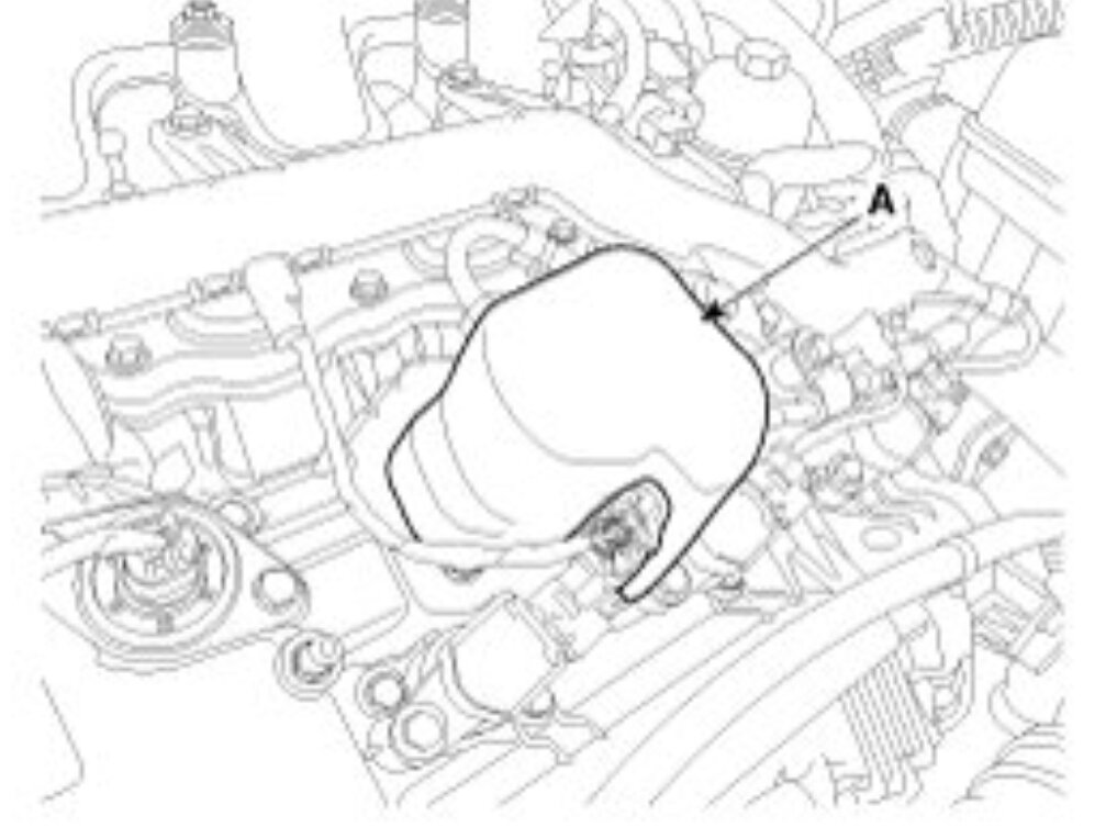

3. Remove the pump foam (A).

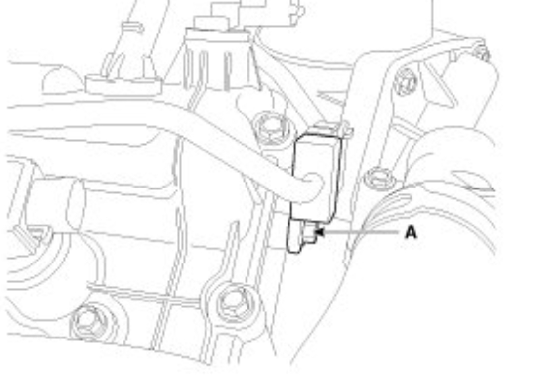

4. Disconnect the fuel pressure control valve connector (A) and the fuel feed tube quick-connector (B).

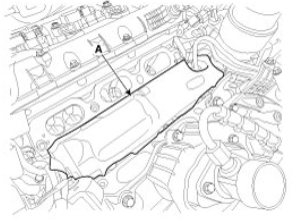

6. Remove the injector foam (A).

(1)Remove the high pressure pipe flange nut in order of A, B with the special service tool [SST No: 09314-3V100]

8. Remove the installation bolts (A) and then remove the high-pressure fuel pump (B) from the cylinder head assembly.
CAUTION:
Unscrew in turn the two bolts in small step (0.5 turns). In case of fully unscrewing one of the two bolts with the other bolt installed, the housing surface of the cylinder head may be broken because of tension of the pump spring.
