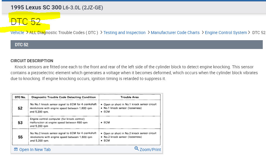

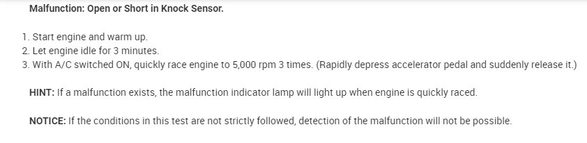

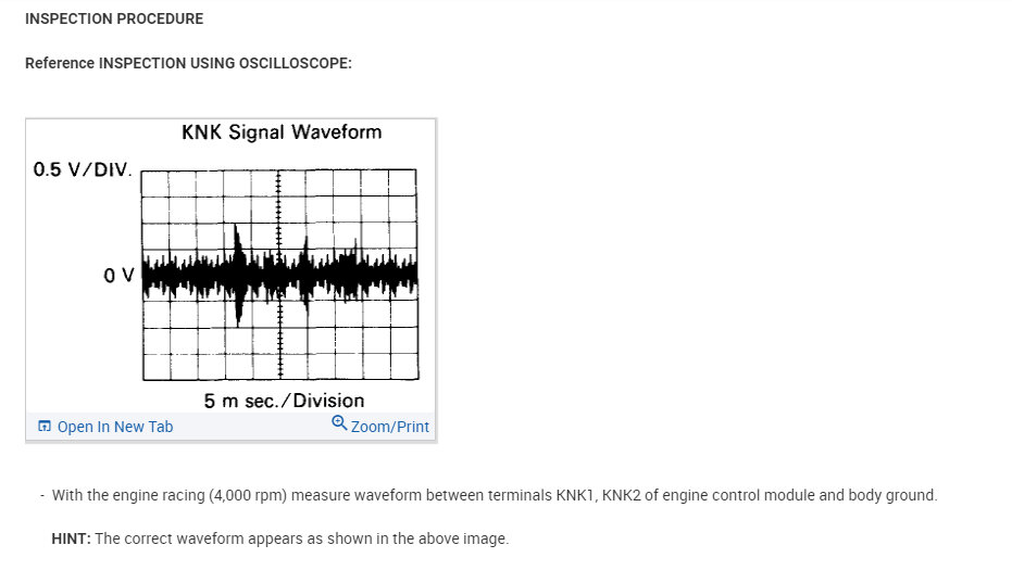

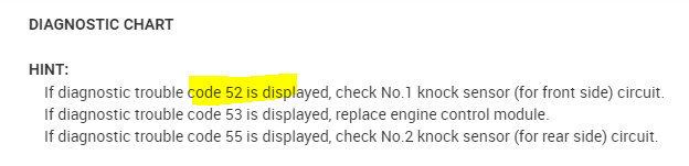

I’ve recently purchased a 1995 sc300 and was retrieving the codes 52 and 71 from the ECU. I’m not very familiar with this car yet so I was hoping to get some advice on what to check or replace as a result of those codes.
May 3, 2023 at 4:04 PM
  • CAR REPAIR CONTRIBUTOR
  • 110,190 POSTS

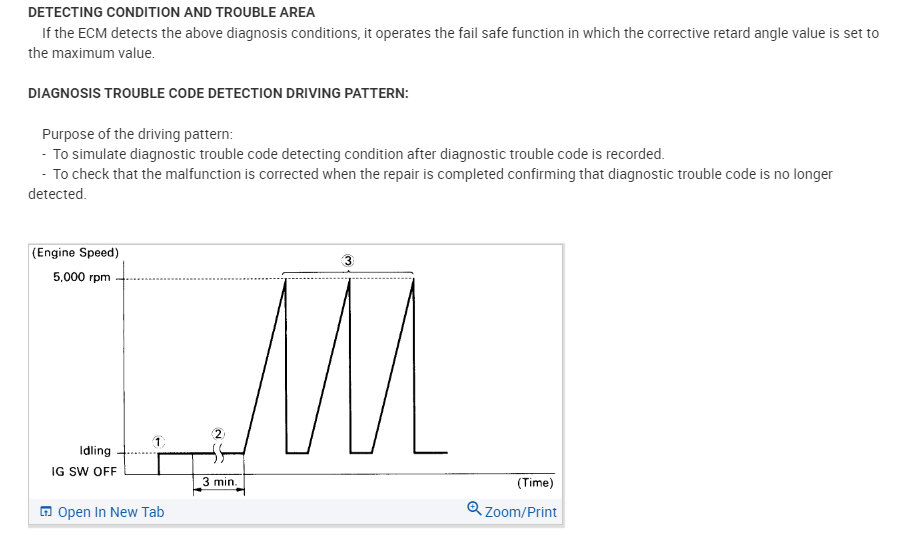

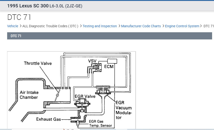

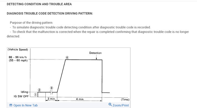

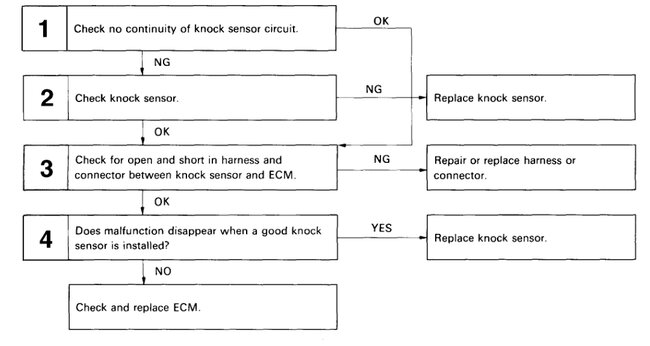

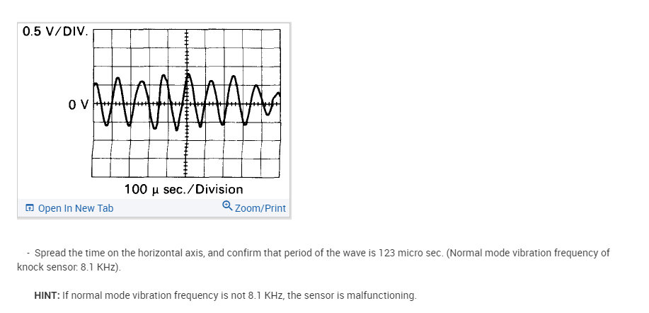

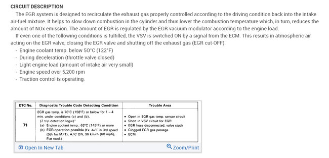

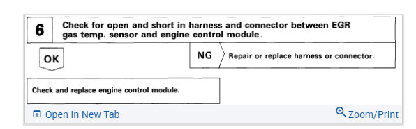

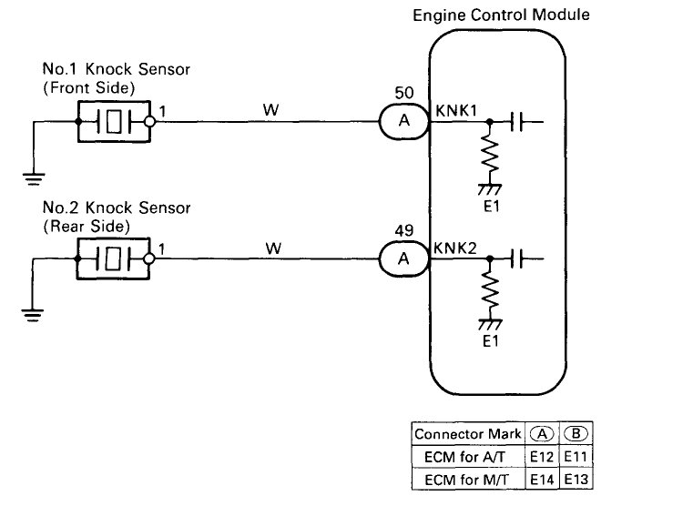

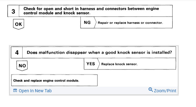

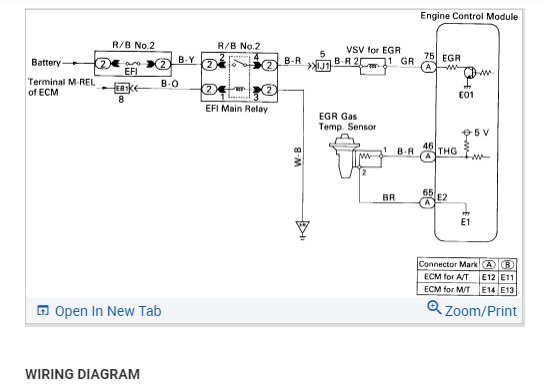

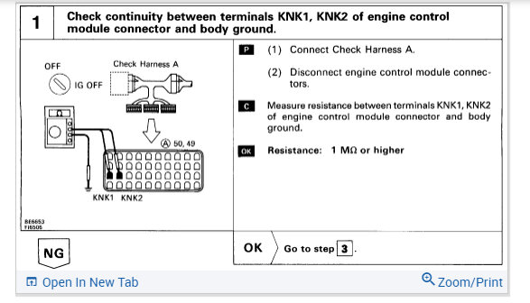

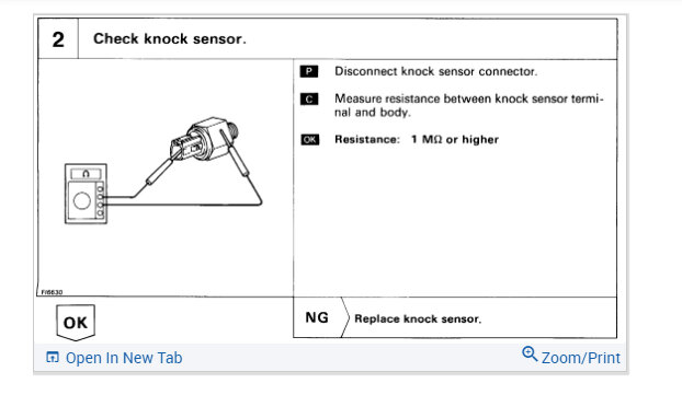

Code 52 is related to the engine knock sensor and the 71 is tied to the EGR system.
So, I need to know how the vehicle is running. If it idles smoothly, I would suggest starting with the 52 code. If the vehicle has a rough idle, then start with the 71.

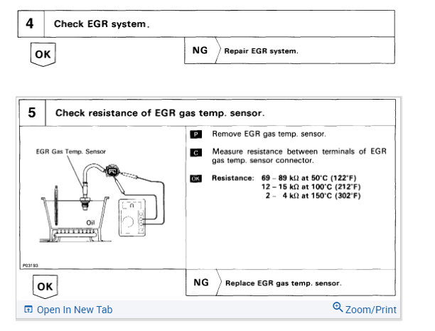

Let me know. If you want, I have attached the diagnostics for both below for you. Take a look through them and let me know if you are comfortable performing them.

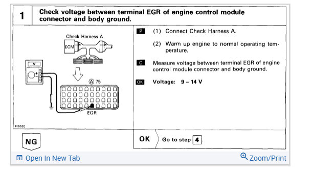

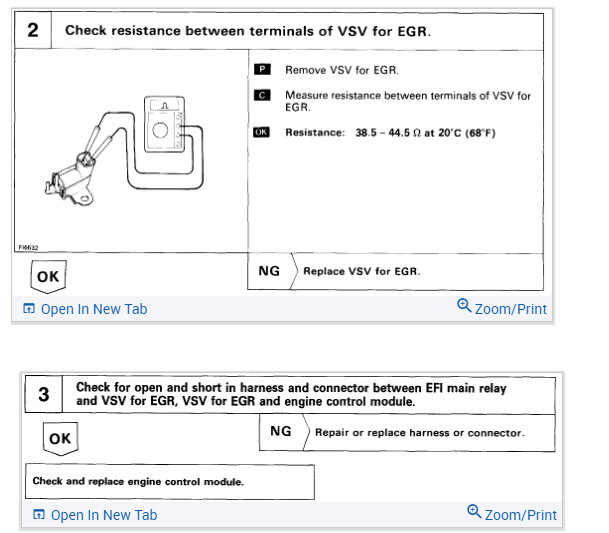

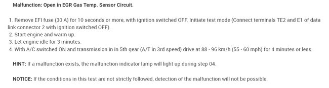

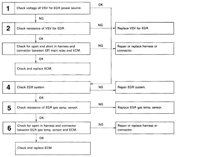

Thanks for the info. Based on a high idle, I suspect the problem is related to the EGR. Are you comfortable performing the diagnostics I attached above?
Also, take a look at this link and let me know if anything helps:
https://www.2carpros.com/articles/engine-idles-too-high
May 4, 2023 at 6:51 PM
LR_SC300
Hey thanks Joe, and I should be able to preform those diagnostics above. I will definitely let you know if anything changes.
May 5, 2023 at 9:33 AM
LR_SC300
I replaces the EGR as it was bad, and the light went away. Although, the idle problem still exists. It will fast idle at about 3-4k rpm and remain that way even after the engine reaches operating temperature.
