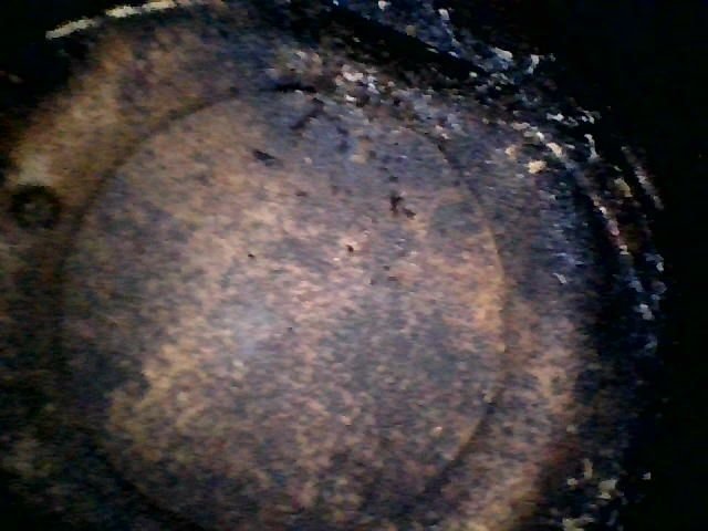

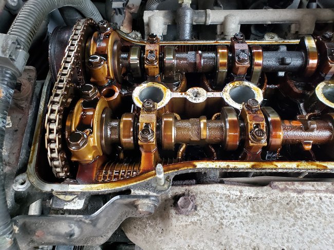

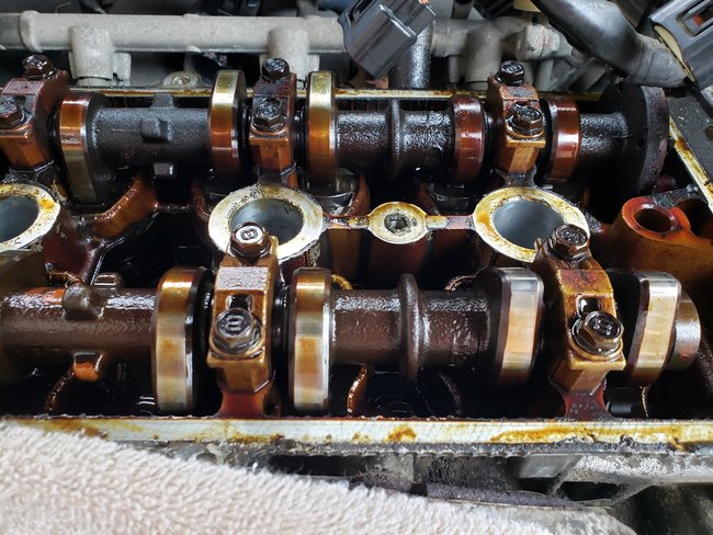

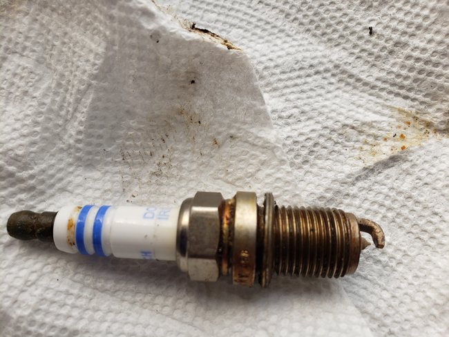

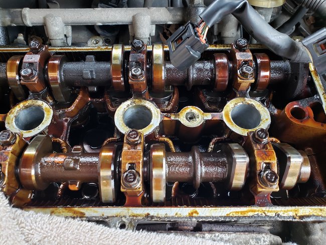

I replaced the valve cover gasket on the car listed above.
Based on the pictures I attached, would you tell me if I have to do anything to prolong engine life?

Based on the mileage and what I see, all I can say is keep doing what you have been doing. It looks clean, especially for the mileage.
The one ticket is keeping the engine oil changed on a regular basis and using a quality oil filter. Also, make sure to keep the PCV clean and operating and the air filter clean.

Thank you very much. I did exactly what you suggest change the PCV valve, air filter, and oil. I'm wondering do I need to do anything about the carbon deposit and fuel injector cleaning?

If you are not experiencing anything as far as a rough idle or poor running conditions, chances are the internal components are okay. Maybe I'm just old school, but I was taught many years ago, that if it isn't broken, don't fix it. LOL I am one who isn't really crazy about internal carbon products. Yes, they do work, but I have seen where they fix one issue and cause a different one.
The injectors can be serviced by simply adding a quality injector with a tank of fuel. There are many good ones to use. Over the years, the most commonly used one that I have heard success with is Sea Foam. It is actually designed to clean the entire intake system. Here is a link I found that you may find of interest:

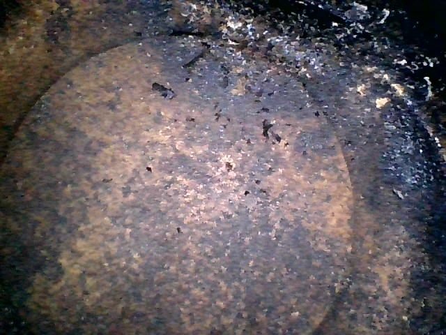

Based on the pictures I attached, would you tell me if I have to do anything?
I experienced poor pickup.

I think you could try using an intake and valve cleaner. It wouldn't hurt. There are several brands. From experience, I always recommend either seafoam or CRC products.

I did exactly what you suggested intake and valve cleaner.
A few positive results have accomplished:
idle stable before it was not.
better pick up.
engine making less noise while idling.
