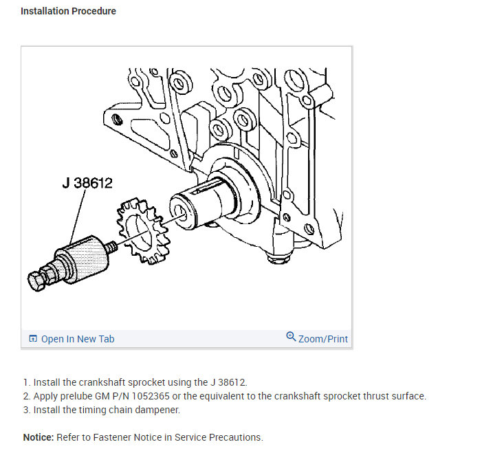

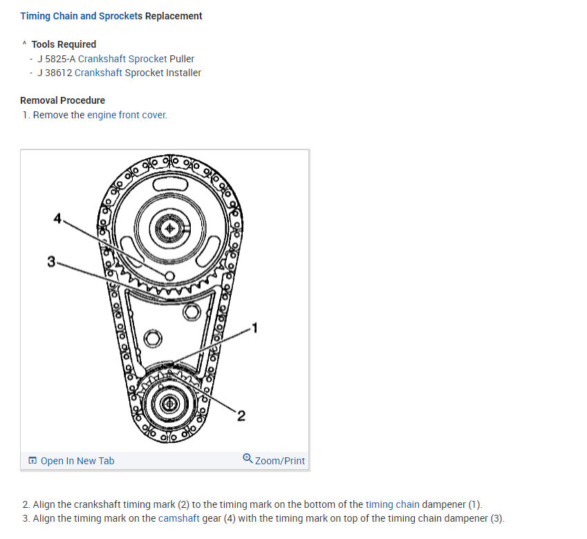

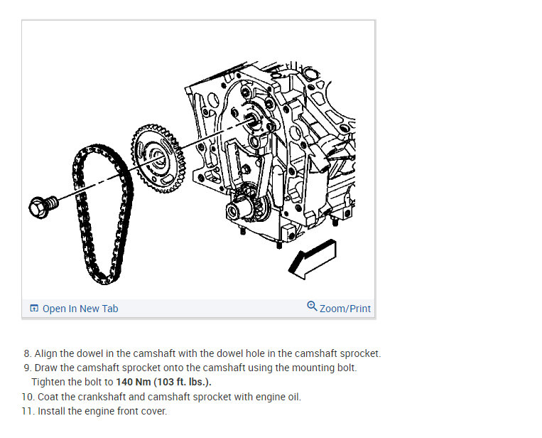

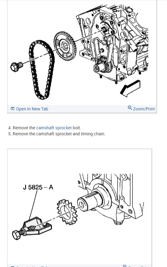

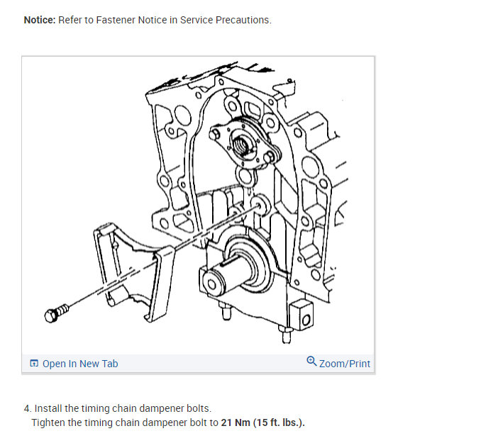

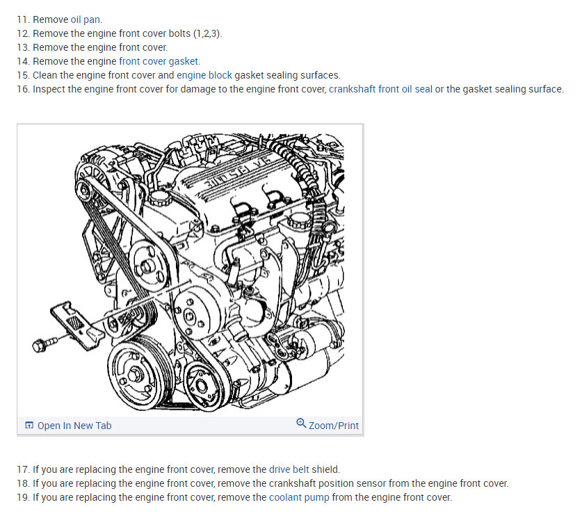

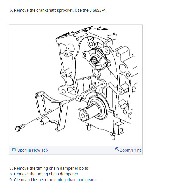

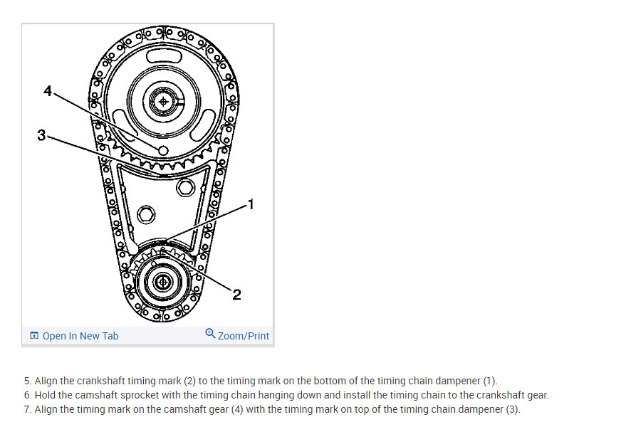

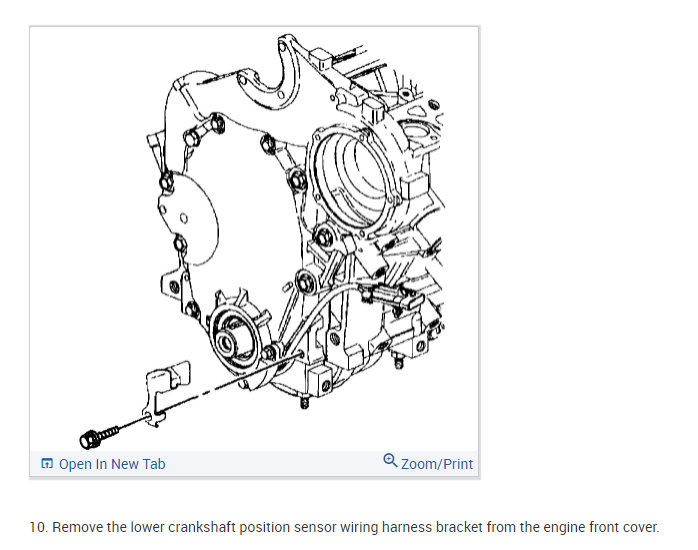

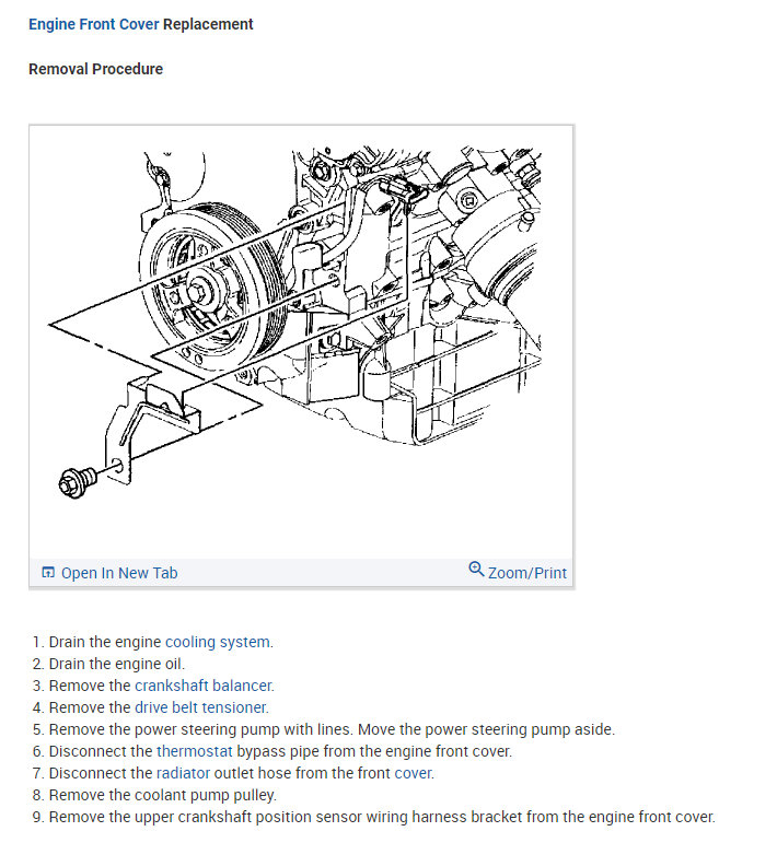

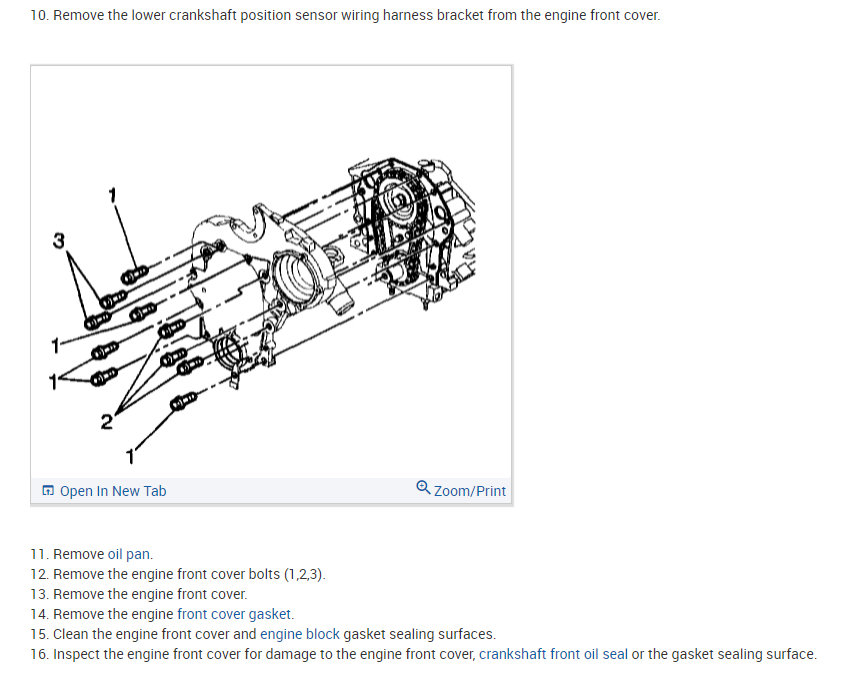

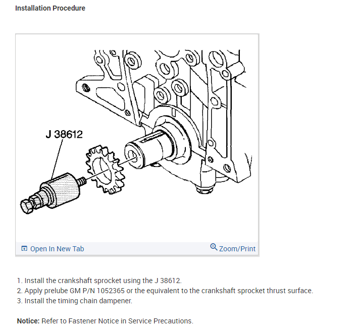

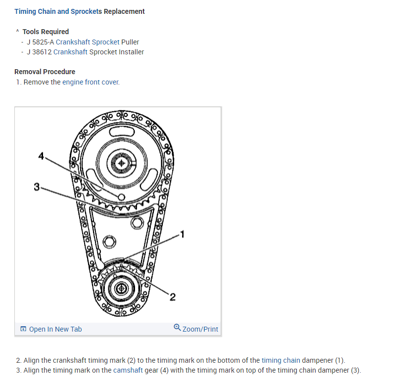

I need to replace the timing chain.
Saturday, July 3rd, 2021 AT 9:48 AM
MECHANIC
52,796 POSTS
Good afternoon,
I attached the procedure below for you for the replacement of the timing chain.
It does state to remove the oil pan but I have never done that. The cover comes right off without removing it.
