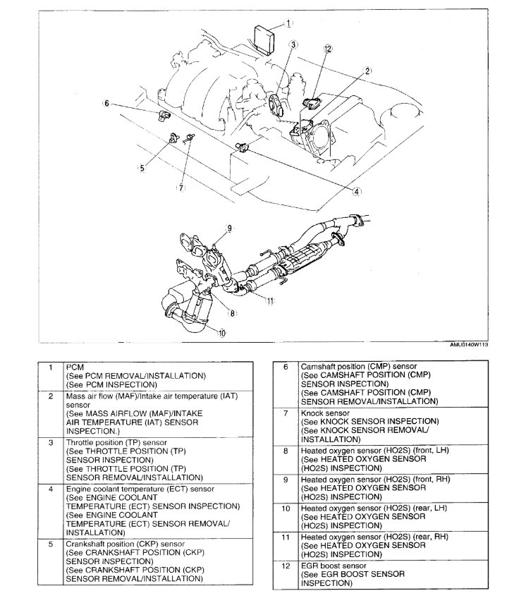

Using the diagnostic emission code reader, I can the bank 1 sensor 1 error. I replaced the sensor and cleared the computer and the light came back on with the bank 1 sensor 1 error. There are two sensors closed together and not sure if I replaced the correct one upstream or not. They are close to each other. P0030 OBD-II Trouble Code: HO2S Heater Control Circuit (Bank 1 Sensor 1). What I will do since I kept the original sensor I replaced is clean it up a little and put it back and use the sensor I originally purchased for Bank 1 Sensor 1 into the correct area. Thanks for the information. I obviously got confused with the location. Do you have a diagram? Thanks, Mark

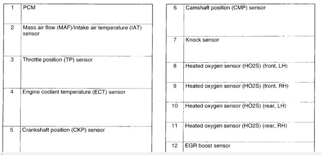

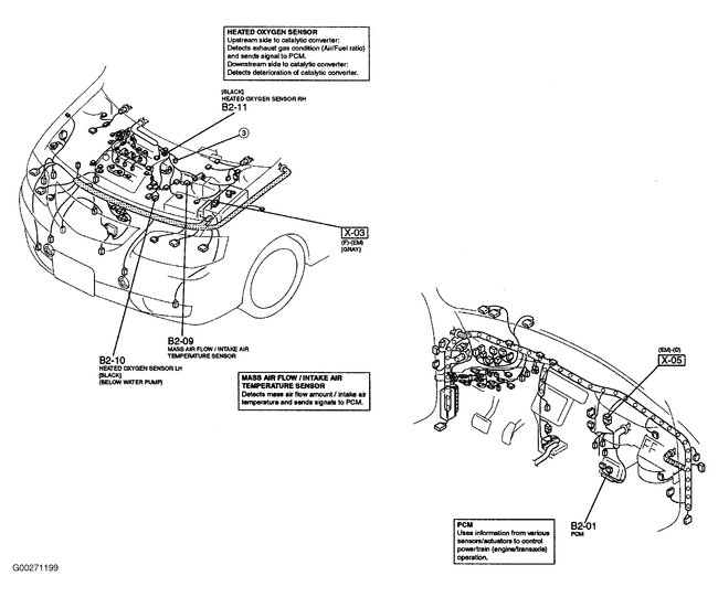

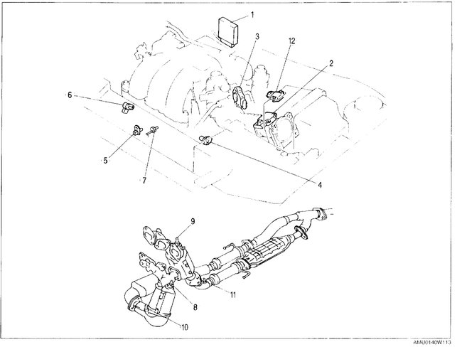

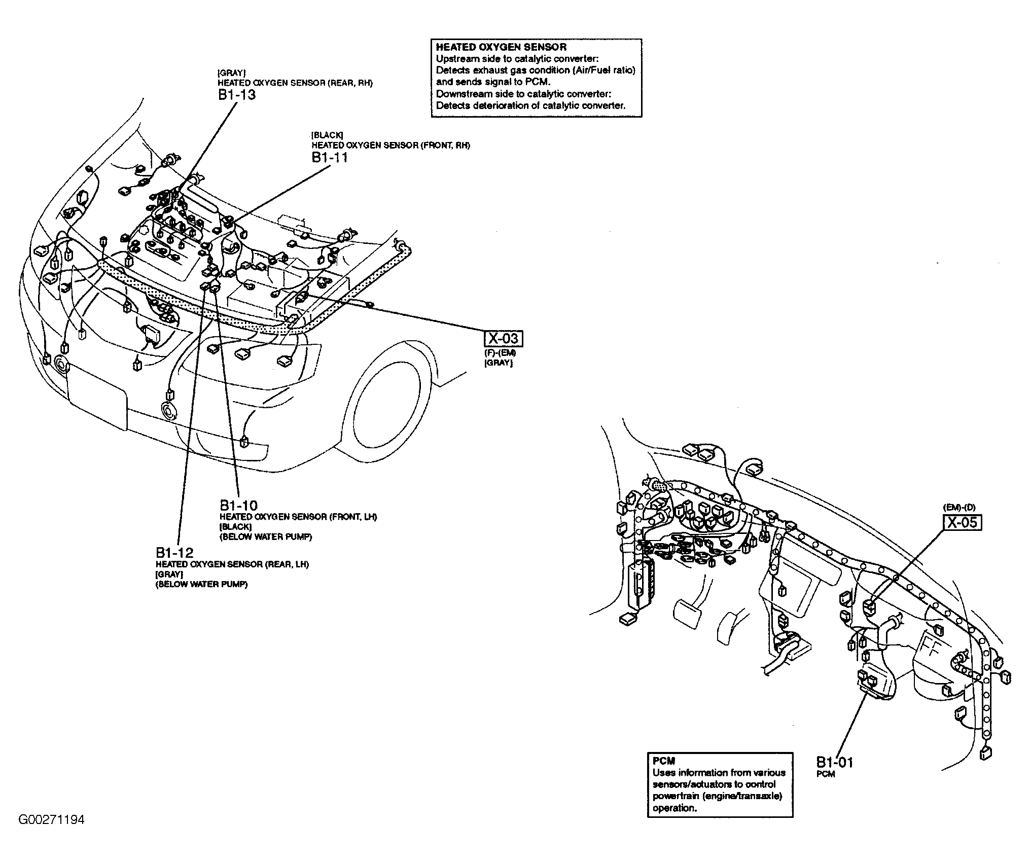

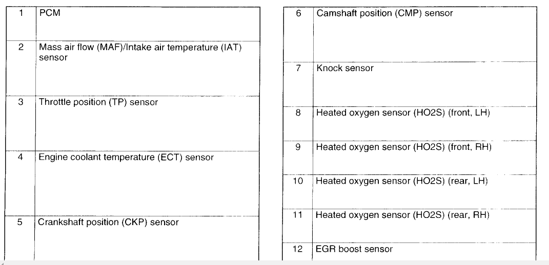

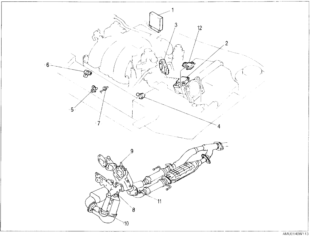

You sent me a link awhile back but it never got bookmarked correctly. I need a diagram on the location of 02 Sensor Bank 1 Sensor 1 that I need to examine and or replace.
+1
Thursday, December 3rd, 2020 AT 8:38 AM (Merged)
PATENTED_REPAIR_PRO
  • 1,853 POSTS
This is north America locations, the second is except North America.

I have a code reset device that clears the check engine light and I replaced the bank 1 sensor 1, but the light came back on. How many sensors are there and the location? My birthday is coming up and in our state and county we have to get echecked.
-1
Thursday, December 3rd, 2020 AT 8:39 AM (Merged)
PATENTED_REPAIR_PRO
  • 1,853 POSTS
There are four, left front, right front, left rear and right rear. Depending on which code you have these are also the locations. Check out the diagrams (Below). Please let us know if you need anything else to get the problem fixed.

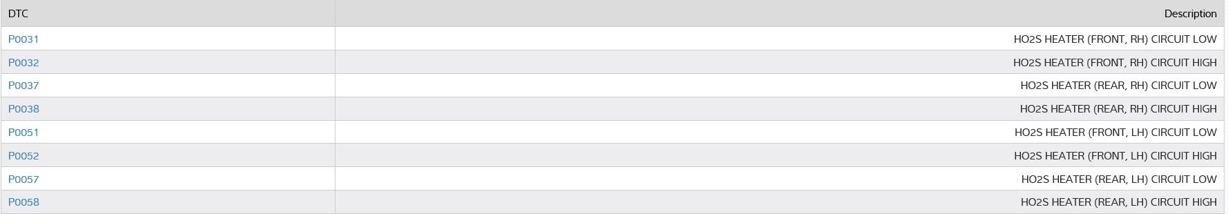

PETE37
  • 2002 MAZDA MPV

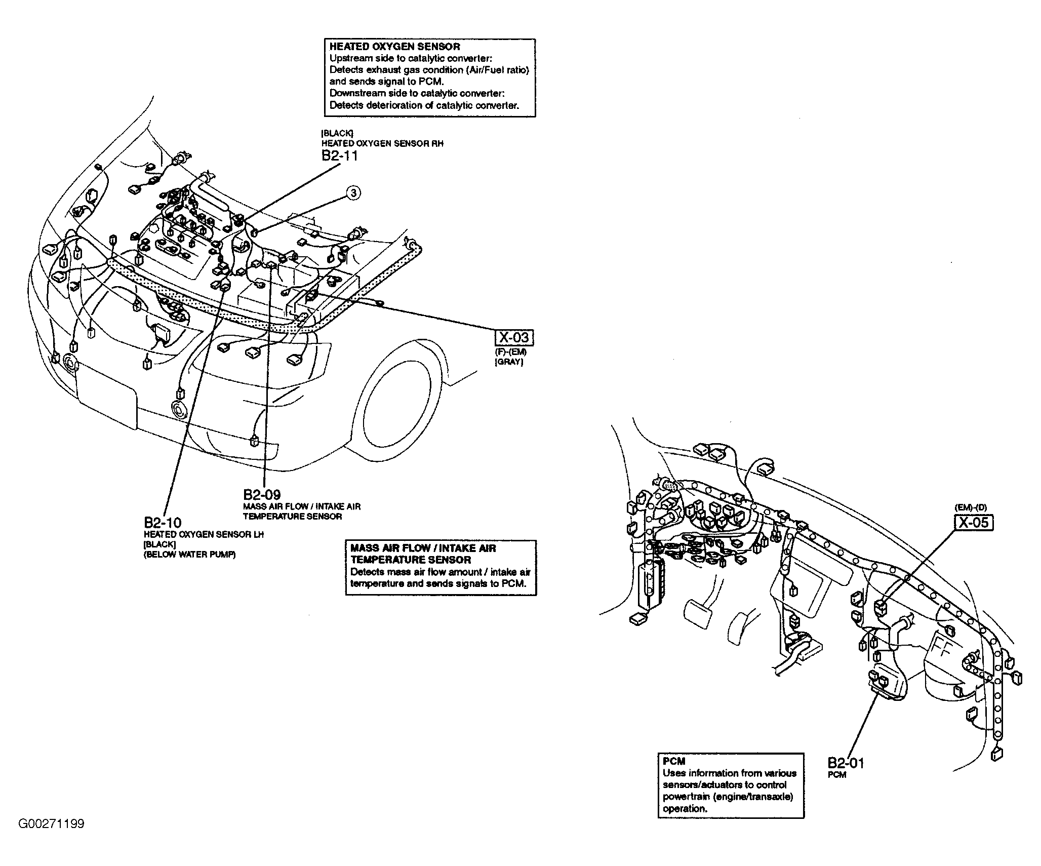

Code is P0051. HO2S II needs to be replaced.
Can you tell me how to physically reach the electrical connector at the end of this sensor? From underneath the car it appears to go up above the alternator. I can't see where the connector is; not from underneath, not through the passenger side wheel well and not from the top of the engine compartment. Any thoughts on what must be removed to access this connector?

You will have to just follow it up and remove whatever necessary to get to it. Here is a guide to help you replace the oxygen sensors with the locations in the diagrams below.
