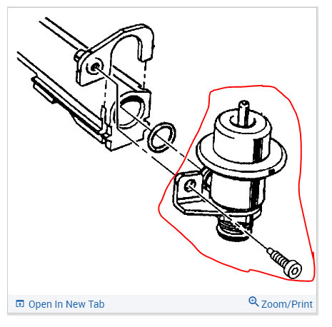

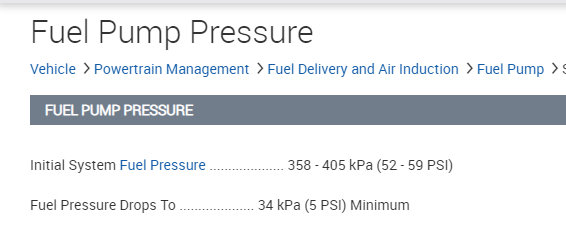

If you smell a rich fuel mixture from the exhaust, I suspect it would be fuel pressure related. You may want to test the fuel pressure to see if it is too high due to a faulty pressure regulator. Here is a link that explains in general how it's done:
I attached the manufacturer's pressure specifications below for you. (Pic 1). Here is a quick and simple thing you can check as well.

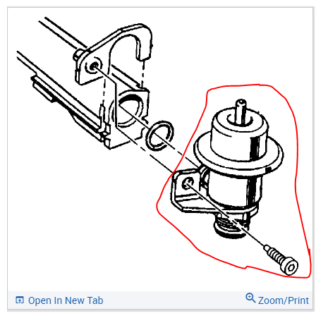

The fuel rail is where the pressure regulator is located (see pic 2). With the engine off, remove the vacuum hose to it, and see if there is evidence of fuel in the hose. There shouldn't be.
If there isn't, start the engine and see if there is a vacuum being supplied to the hose. Don't run it too long like that because the regulator won't be working if the hose is disconnected.

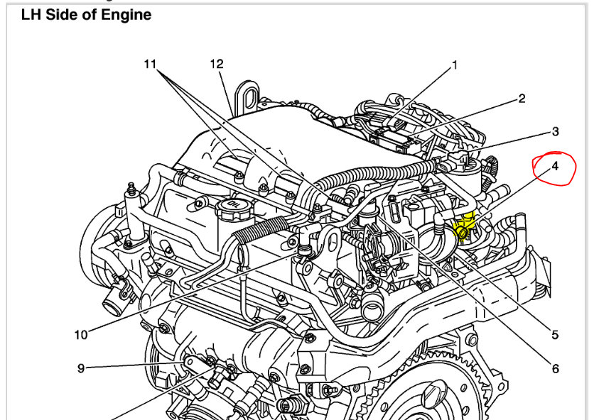

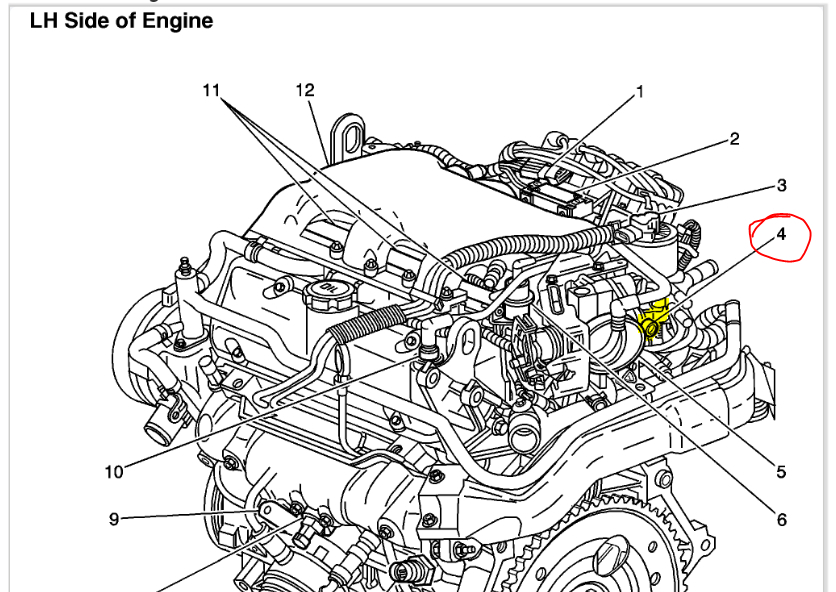

Do me a favor. Locate the throttle position sensor and disconnect the connector. Inspect it for corrosion, damaged wires, and inspect the connectors to see if something is causing the low voltage.
If you look at pic 1, it shows the location.

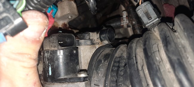

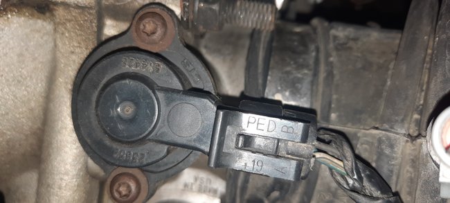

Here's two pics.

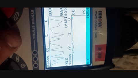

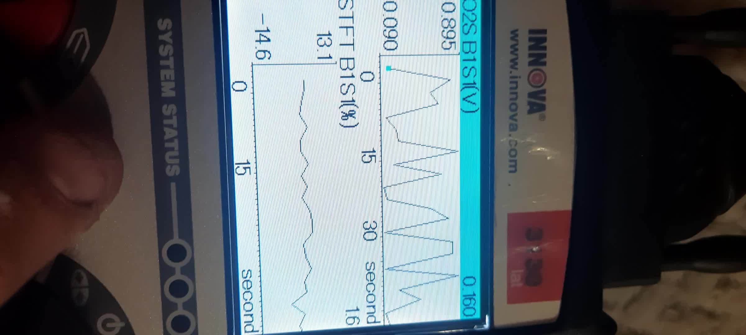

Here's the o2s live data at idle.
Tuesday, July 19th, 2022 AT 12:47 AM
  • 110,192 POSTS
The sensors seem to be working. Why weren't you able to get the coolant temperature sensor info? The vehicle can be running. I suggest doing it when the engine is just started because the coolant will be close to ambient temperature.
Cleaning the connector sure made an improvement. If you clear the codes, do they come right back?

I replaced the TPS. Then cleared the codes. They haven't come back yet. But I haven't had a chance to drive it. Will tomorrow and I'll let you know how things go.

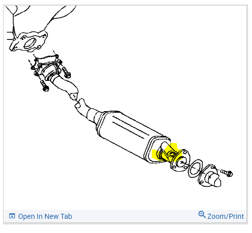

Could it be because the O2 sensor is back too far and isn't heating up enough? I could put the O2 in the cat. And put the plug in the O2 pipe that was added. That would move the O2 sensor forward maybe enough to stop throwing codes.
Friday, July 22nd, 2022 AT 12:37 PM
  • 110,192 POSTS
If the system is still the OEM design, the sensor position should be correct. I have a favor to ask that I asked earlier. I want you to drive the vehicle until it is at operating temperature. Then, check both the short-term and long-term fuel trims. Nothing other.

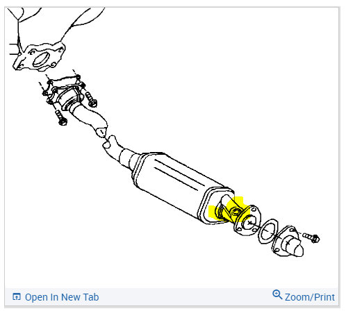

The exhaust system isn't the original except the header pipe and the pipe that zig zags over the axel. Oh, and the muffler. The rest was done by me and my cousin. The resonator pipe was eliminated. I need to know the distance from the header pipe back to where the O2 is supposed to go. No other codes besides the p0420. I'll have to get the code scanner again.
Friday, July 22nd, 2022 AT 9:16 PM
  • 110,192 POSTS
The only way I could tell the distance is if I had one in front of me. I attached a pic below showing it at the 3-way catalytic converter. Looking at the pic, I would estimate it is approximatly three inches after the converter. I wish I had a better answer for you.
