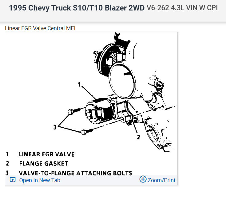

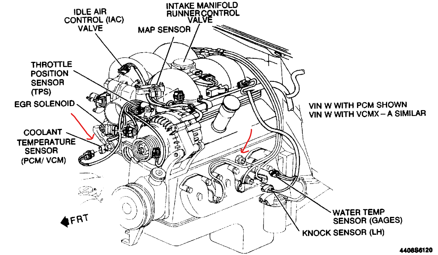

I was changing the engine temperature sensor and it has 1 green wire going to it but the 2 manuals I have say it should have 2 wires, 1 yellow and 1 black. It has a gauge in the dash, not idiot light. The gauge had been working but then it started reading lower temp at the gauge and I decided to replace it and the plug doesn't fit the new sensor connector. The main reason I was looking at the temperature sensor is it has been showing a code number 32 on the check engine light which is EGR failure or circuit. I replaced the EGR and it still comes up after about 6 miles driving it. It has passed emission tests before but recently won't. Too much NOx I believe was the problem. It has a linier EGR and that's where I think the problem is coming from. The temperature sensor not telling the erg it warmed up enough to open and close like it's supposed to. Am I looking in the right direction? If not, please point me in the right direction. Any help would be appreciated. It's also an obd1.5 from what I can tell. Thanks Gentleman, Glen

You are headed in the right direction; I would replace the coolant sensor, and I would remove the EGR valve and use a coat hanger and carb spray to clean out the EGR passages which get clogged causing the problem you are having now.
Code 32 refers to an issue with the EGR (Exhaust Gas Recirculation)
There are two coolant temperature sensors, one for the computer and the other for the gauge FYI. Check out the images (below). Please upload pictures or videos in your response of any problems so we can see what to help you with.

Hello this is Gentleman Glen, and I'd like to thank you for showing me the correct engine temperature sensor and its location. I did change it because I was hoping it was the problem I'm having with the code 32 on my blazer. I also found the insulation on the wires had been pulled back some, so I covered the wires while I was there. Unfortunately, this still hasn't resolved that problem. I have replaced the EGR and cleaned the passages like you described and even put a gasket with a screen just in case. I'm still getting a 32 code after about 4 miles driving it. The service engine soon light comes on and stays on until I turn it off, then it goes off until I've put another 4 miles on it. I'm not sure what to try next because the manuals I have say take it to a dealer to get the erg checked and don't show specs for testing it myself. I do appreciate how quickly you responded to my problem before, I thought that was going to take care of it. If it were a Harley-Davidson, I could have fixed it by now, I'm pretty good at doing things with them. I have been a Master Mechanic since 1978. I still work in the older ones. Anyway, thanks for your help.

I took the EGR off and started the engine, it ran at a high rpm until I stuck my finger in the upper hole to see if that was the intake manifold port and it was. The rpm came back to normal, and I could feel the exhaust from the other port, nothing was coming out except the exhaust, no carbon, so I put it back together to test drive it and there was no difference. It seems to idle smoothly. No vacuum leaks at the gasket, runs pretty good, but again the code 32 came up after a few miles. This makes no sense to me, everything I've read about a bad EGR I would expect at least a rough idle. Do you know what the voltage should be at the yellow wire to the temp sending unit. I haven't checked that, but I think I read 5vdc when it's up to temperature. If that sounds right let me know. I'd appreciate it. Thanks. Glen

If the thermostat is stuck open this can cause the EGR not to operate. But when you say exhaust is coming out of the EGR port it should be loud and there should be a good supply of exhaust gasses, not just a little bit.
