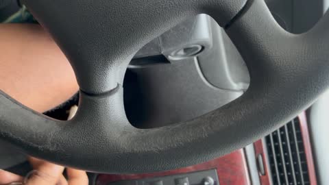

About week ago, my car started to have the no crank no start no noise problem, i figured i should get some more insight on the situation than from reddit. So my car listed above LT, i drove to the corner store literally a 1 minute probably less than that away, i remote started my car before i left my house as well and everything was fine, until i came out the store about 2-5 minutes later, i put my key in the ignition this time and it just wouldn't crank, it would just click 1 time at that time an my headlights and interior lights still was working but even with a jump from my mom's car, it wouldn't start. so i put my car in neutral and rolled it back to my house the same day, luckily i was literally that close to my house but the next day i was thinking over my problem/situation because i have to get to work and doing some research i came to a conclusion that it was the starter but then i went outside that morning to the car and i couldn't lock/unlock my doors, my interior lights wouldn't come on anymore or nothing, so i told my dad what was going on and he said maybe the battery was just old/weak and so i got a new one, i even got a new brass terminal for the negative one because it was corroded and i cleaned my wire tips and other terminal for better connection, i got a jump right after, now only dash lights (no green light behind the dash like it use too though), radio, ac and side mirrors, electric chairs still work but nothing else, no headlights/taillights or other interior lights, not even a click anymore. I bought a starter as well and installed it, same issue still after installation, nothing changed,
I have done some more research but google just says, sometimes starter fuse's/relays or even the ignition switch/neutral safety switch but I'm constantly getting stomped. (My starter relay is fine, i switched my de-fog relay with it, it still didn't work but dad says he can hear click with both relays when i turn the key, my fuses i really can't say as i didn't really pull them out and look them) but i also noticed when i turn the key, the box the goes around the gears (PRND123) or (PRNDL) on the dash doesn't pop up any more like it doesn't sense/indicate what gear it's in anymore. l'm thinking that's why i can't shift my shifter also, i am pressing on my break and everything, could it be my ignition switch? I’m about ready to take it to the shop but really not trying to if i don’t have too. (Last night my headlights came back on for a little bit but then just shut off after i was playing with it).

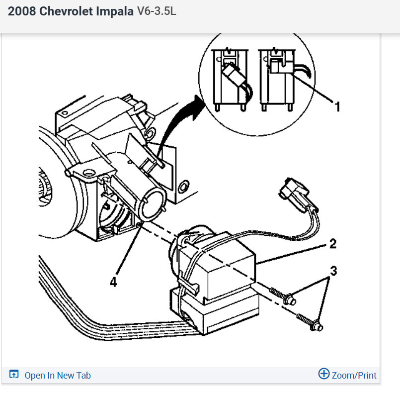

Yes, it can be the ignition switch but let's try to rotate the engine over by hand first.
These two videos can help us see what's going on:
https://www.youtube.com/watch?v=oN42gZN6gOE&t
and
https://www.youtube.com/watch?v=6YRW8fyNudY&t

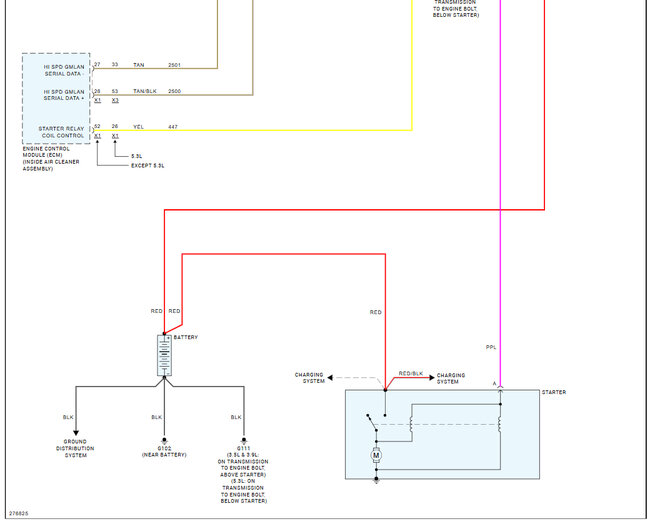

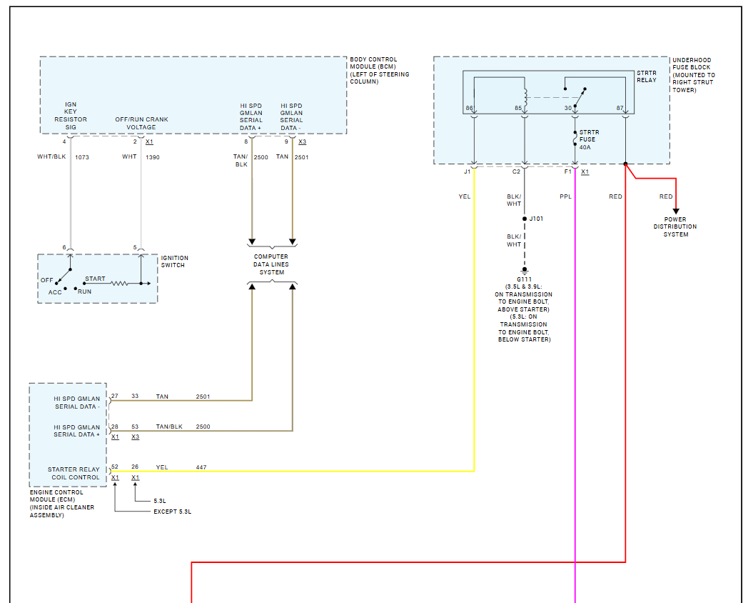

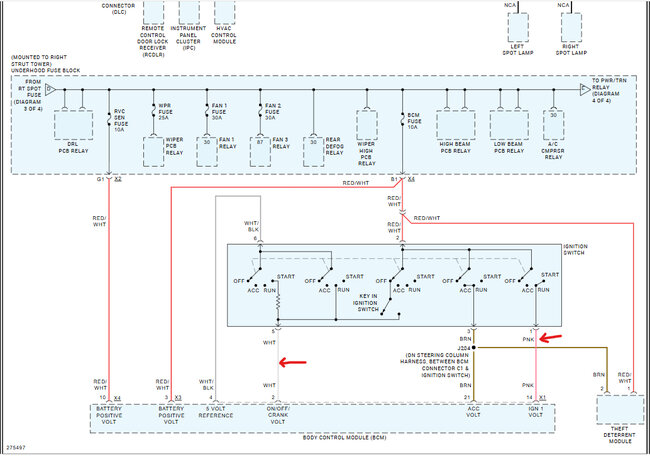

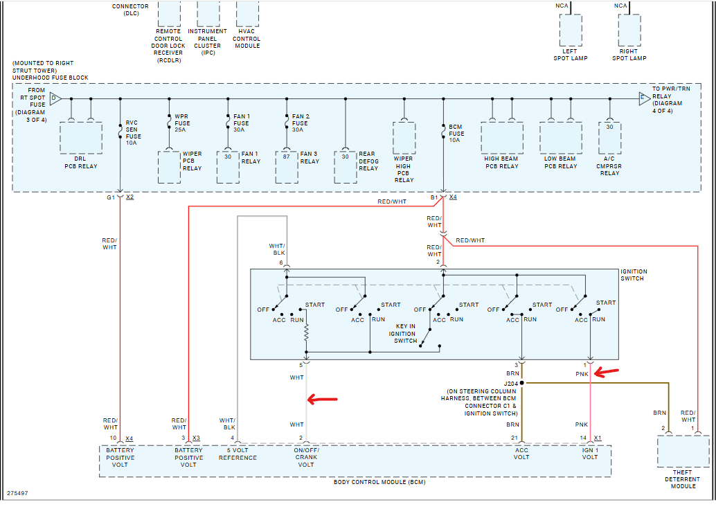

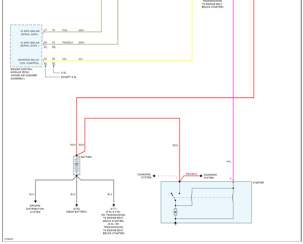

Here is a guide to help you test the ignition switch and I have included the starter and ignition switch wiring diagrams so you can see how the system works.
Can I ask if the security light is flashing? Test the crank wire coming out of the ignition switch. Check out the images (below). Please upload pictures or videos in your response of any problems so we can see what to help you with.

No worries, it will be a red lock blinking if the security system is enabled. Please go over the other guides above and check the fuse as well.
