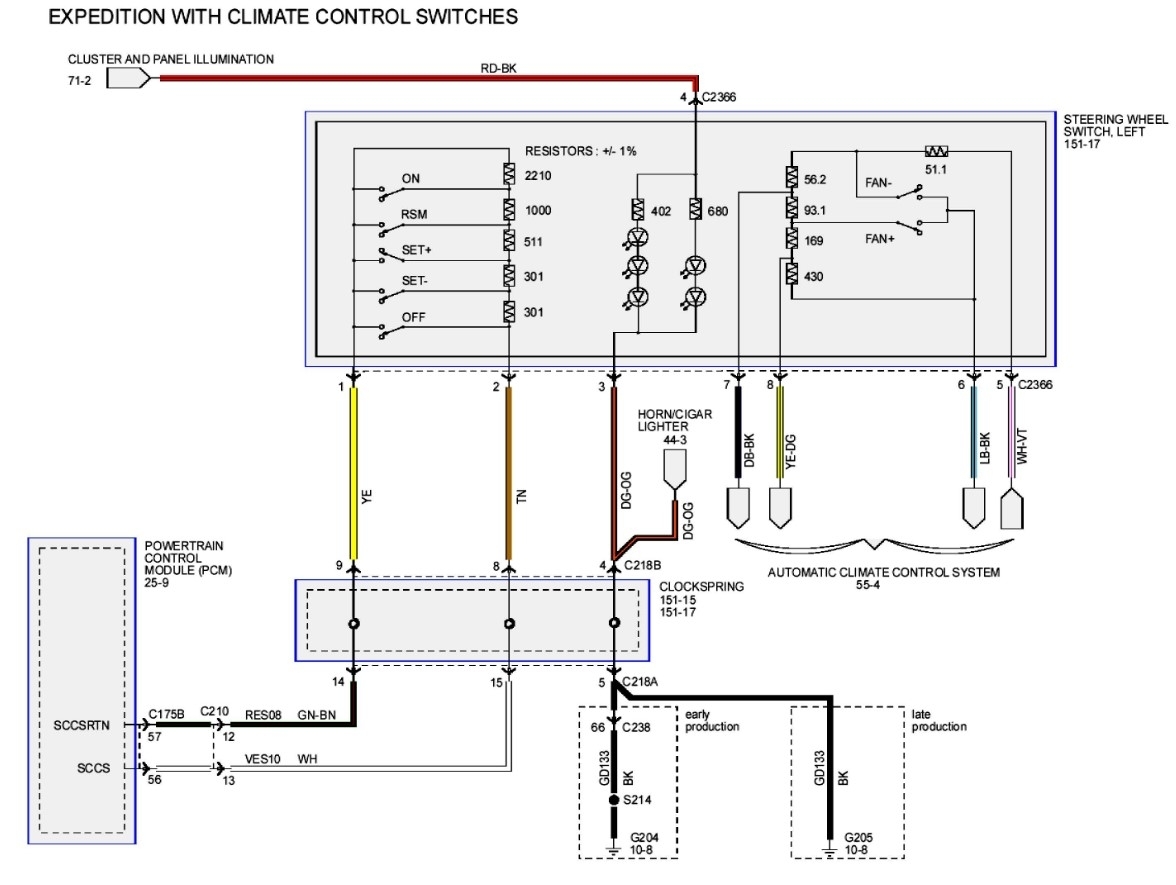

Can I get the wiring diagram for the cruise control?
2007 FORD EXPEDITION
156,000 MILES • 5.4L • V8 • 2WD • AUTOMATIC
MECANICO3

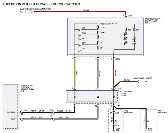

Need cruise control wiring diagram. Cruise light turns on but not turning on.

Hello, we can help with that, but have you had a full code scan done on the entire vehicle, it might show a trouble code stored related to the issue. I know on my vehicle if there are any trouble codes stored in the engine computer it automatically turns off the cruise control. In fact it happen today. Set a code for the Evap system but disabled the Cruise control.

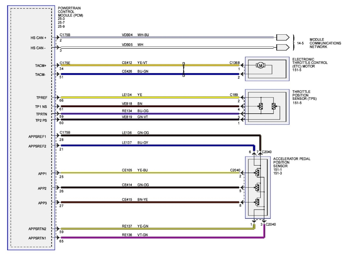

These are the aftermarket Cruise control wiring diagrams to get you started but will post the OEM ones as well.
Dec 16, 2024 at 11:59 AM
AL514
  • 5,541 POSTS

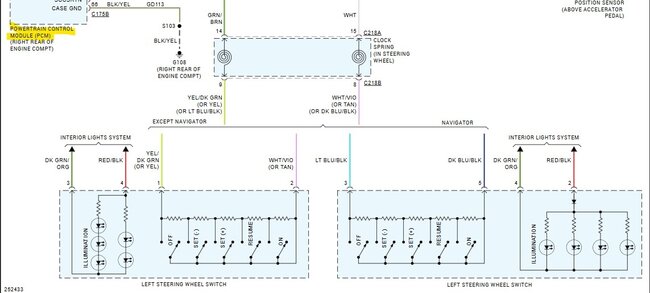

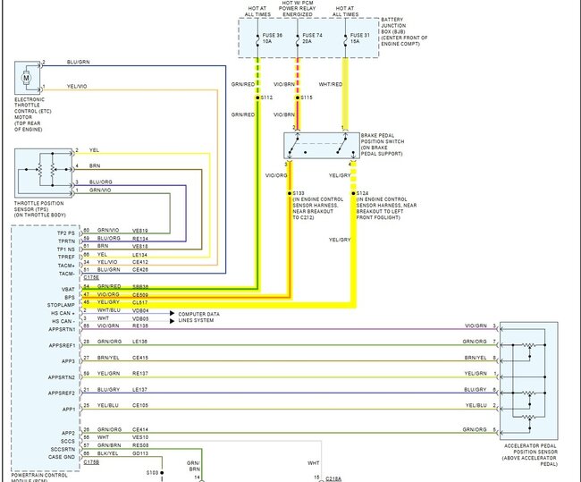

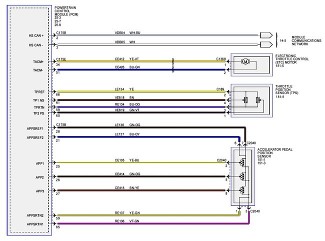

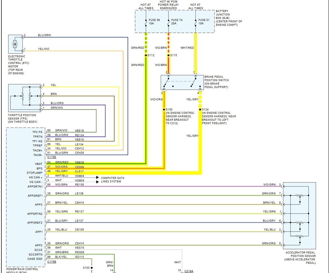

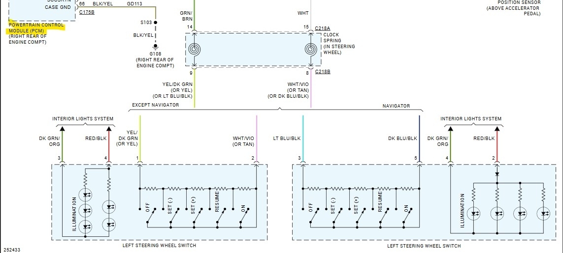

These are Ford OEM diagrams. How do you like the 07?
