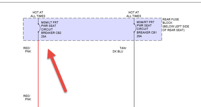

I tried letting my seat back and trying to adjust my seat on the driver side and it want move and I try cutting on the seat warmers on the driver side and that want come on when I got the car it had tape on the bottom of the seat like it was holding some together but the passenger side is working will somebody please help me.

call dealer about heated portion of seat as there is a TSB on that. then check circuit breaker under rear seat for moving the seat it may be that.
