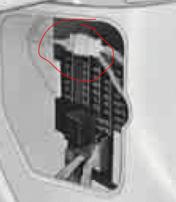

I took a close look at the fuse box to see which fuse was it?
2012 MINI COUNTRYMAN
25,000 MILES • 4 CYL • 2WD • MANUAL
H.JARRETT
My car is making a clicking/buzzing noise as if the battery is to low to crank the car but when I take the key out of the ignition there is a clicking/buzzing sound coming from the fuse box in the passenger side kick panel and my brake lights stay on after key has been removed. If I put the key back in and out a few times the light will eventually go off. Today it was a different story. The battery seemed to be drained because of the brake lights staying on. So when I asked my friend for a jump I thought it would help the situation but it did nothing. The car made the clicking/buzz noise then the started would kick out but nothing else. The motor does not turn at all. I drove it to the location not an hour before.
I took a close look at the fuse box to see which fuse was it that was buzzing and the white thing at the top of the fuse box is what is making the sound
May 29, 2019 at 7:12 PM
  • 110,190 POSTS
I attached a pic below and circled a component. Is that what you are referring to? That is a connector and shouldn't be making noise. If you disconnect it, does the sound stop?
Also, is it possible for you to take a pic of the component and upload it for me to see, as well as a video so I can hear the noise you are referring to?
