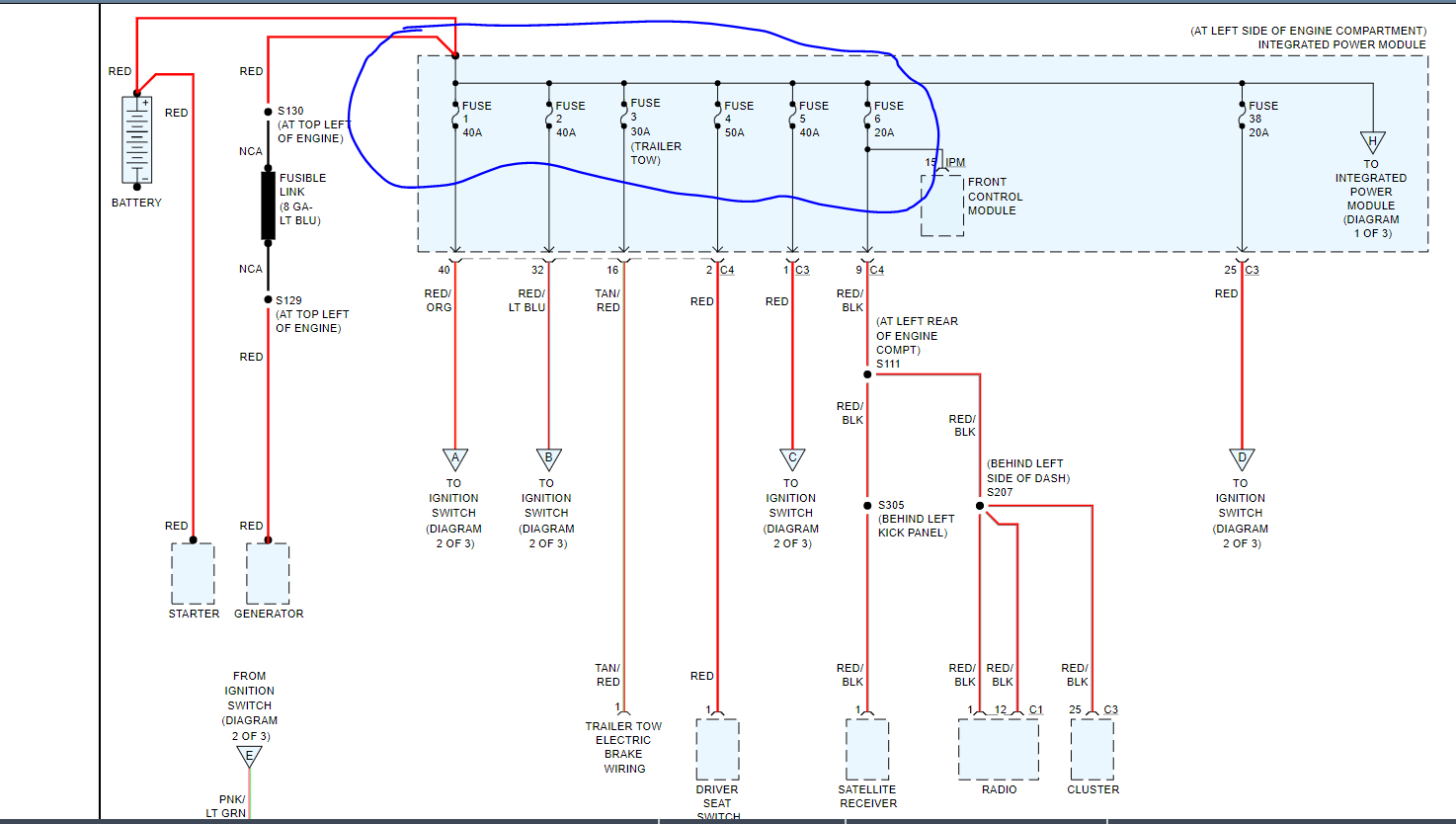

No power to the first ignition fuse in the box under hood
2005 DODGE DAKOTA
230,000 MILES • 4.7L • V8 • 4WD • AUTOMATIC
SNOWMANBFC
i think it's the ignition start fuse, but there is power to the rest of the fuses. i was told to replace the computer or ECM or CPU or whatever you want tot call it. i bought a new one and had it reprogrammed. installed and still nothing. i ran a wire from the battery to the fuse and installed a toggle switch and now it will start and all the lights on the dash will work when i turn the key on. the transmission is in limp mode, no low gear and no high gear. i read that you can re-teach the transmission by turning the key to the second position and press the accelerator to the floor for 30 seconds and then turn the key off. when i start the truck and put it in drive the transmission will work fine for a few minutes and then goes back into limp mode. have to manually change the transmission between 2nd and drive. still no low gear or overdrive.
Sep 8, 2020 at 2:29 PM

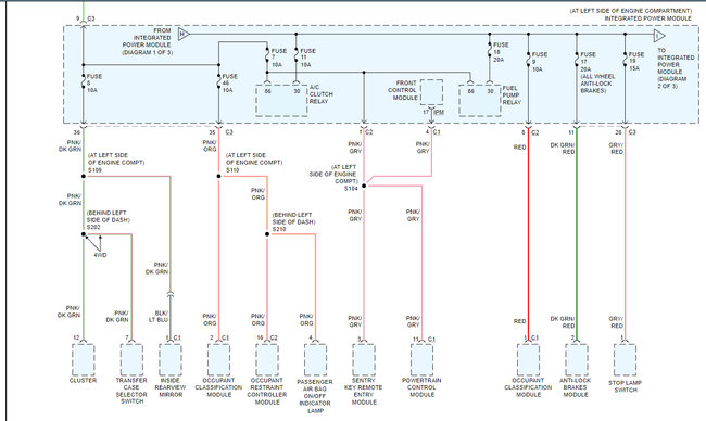

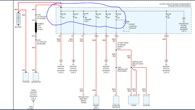

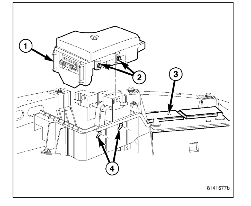

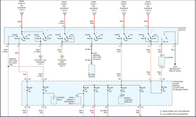

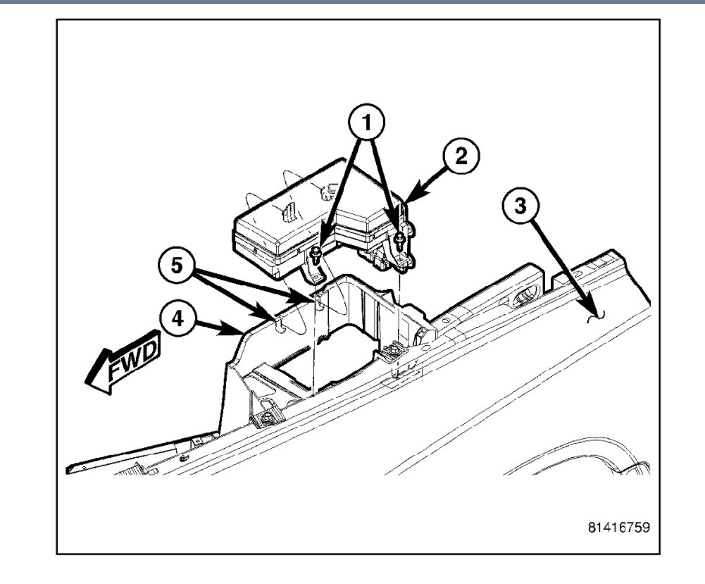

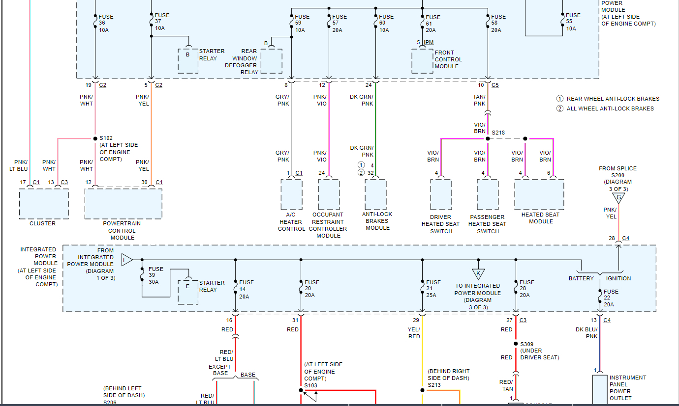

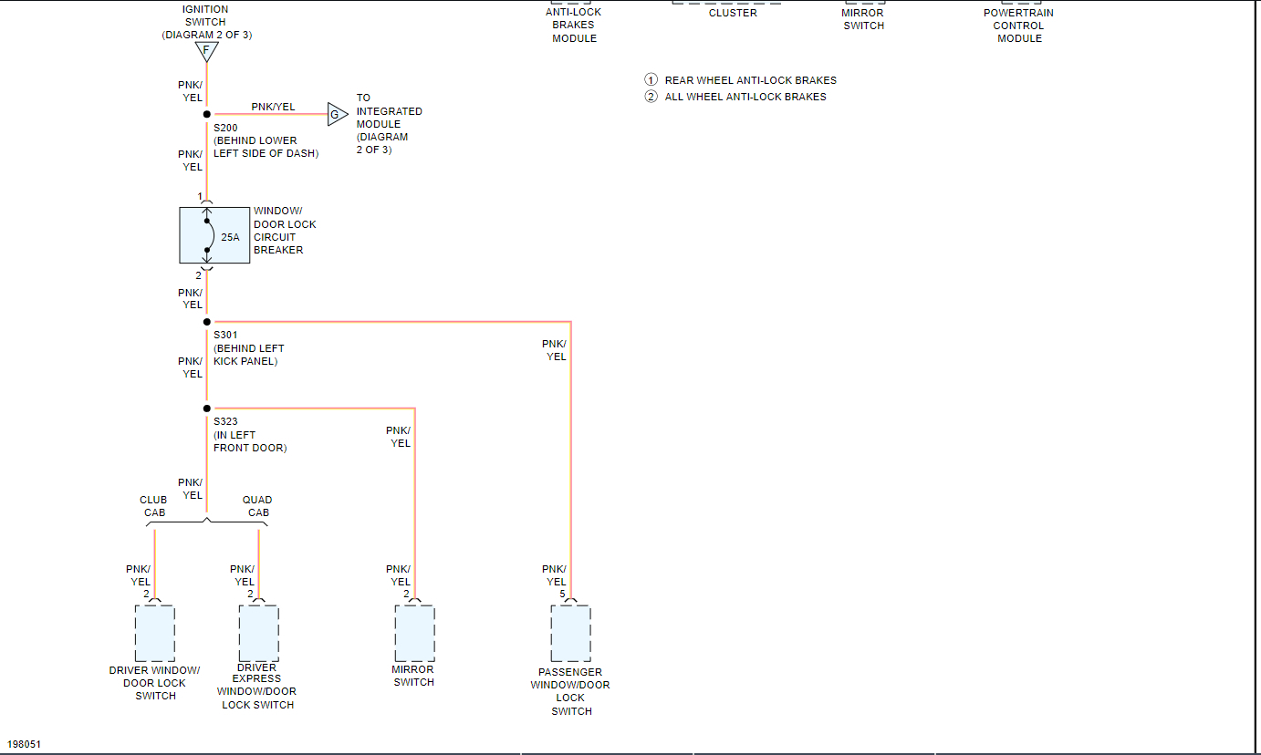

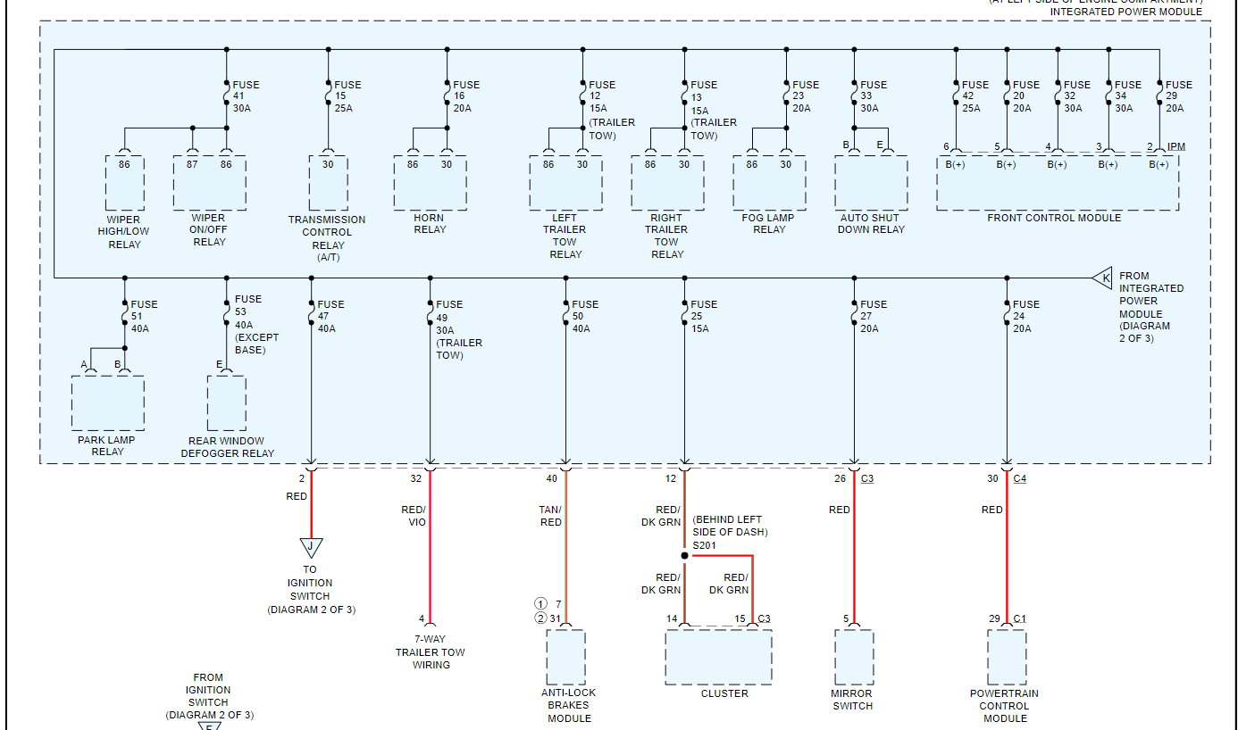

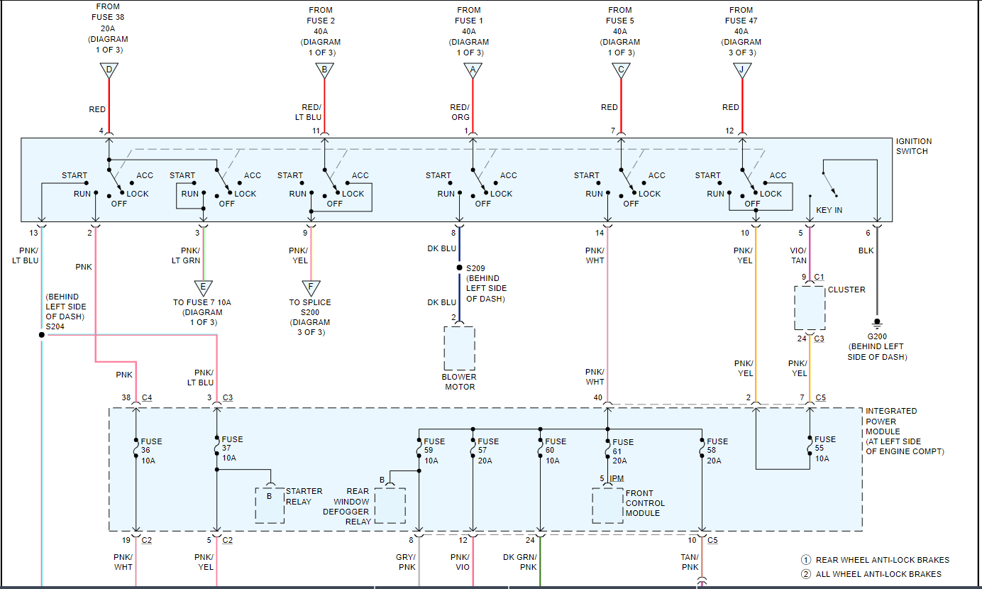

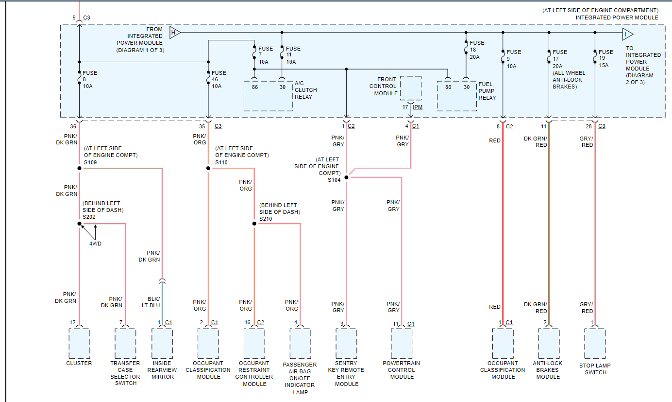

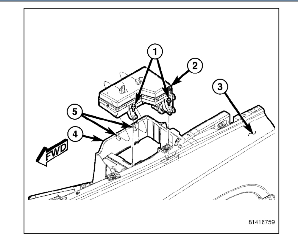

Okay, the power to that fuse comes from the power module or the TIPM. This is a very common failure.
I attached pictures for you of the module under the hood.
I also attached a wiring diagram of the module. The fuses I circled are the ones for ignition.
REMOVAL
1. Disconnect the battery negative cable.
2. Remove the Integrated Power Module (IPM) cover and remove the nut (5) from the IPM B+ terminal stud (6).
3. Remove the battery positive cable (4).
4. Remove the IPM (2) pushpin fasteners (1) from the battery tray (4).
5. Move the IPM (1) forward and up to disengage the locking tabs (2) from the battery tray locating slots (4).
6. Lift the IPM up to access and disconnect the wiring harness connectors from the Power Distribution Center (1) and Front Control Module (2).
7. Remove the IPM assembly from the vehicle.
