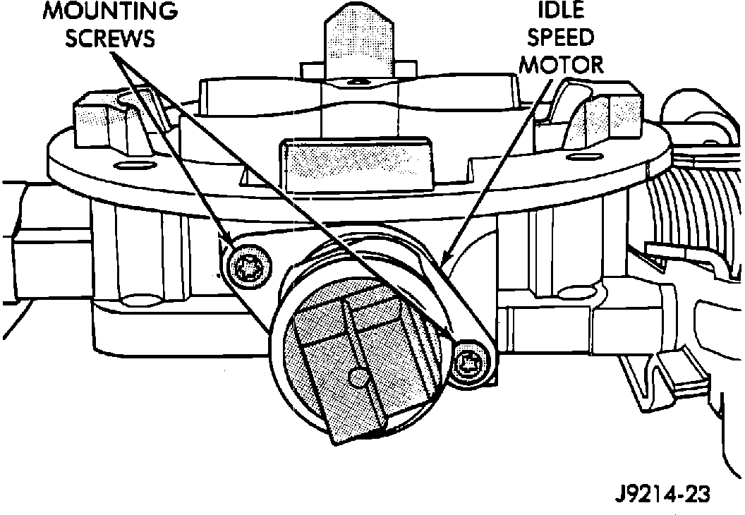

I have to be honest. What you are describing sounds like a bad idle air control valve (IAC). It is located on the front of the throttle body and its only job is to maintain engine idle speed. What I suggest is to remove it and check to see if there is any issues with carbon. Also, have a helper turn the key on and off to see if the small pintle on the end moves.
Here are the directions for removal and replacement. It is really simple. The picture attached shows its location.
AC Motor Removal
REMOVAL
1. Remove air cleaner assembly.
2. Disconnect the negative battery terminal.
3. Disconnect the Idle Air Control (IAC) motor wiring connector.
4. Remove the Torx head mounting screws (2), and remove the IAC from throttle body.
INSTALLATION
1. Install new IAC motor.
NOTE: If the pintle measures more than 1 in (25 mm), it must be retracted by using the IAC exerciser (Tool # 7558). The battery must be connected for this procedure.
2. Install the Torx head retaining screws, torquing them to 20 in-lbs (2 Nm).
3. Connect the IAC motor electrical connector.
4. Connect the negative battery cable.
5. Install the air cleaner assembly.

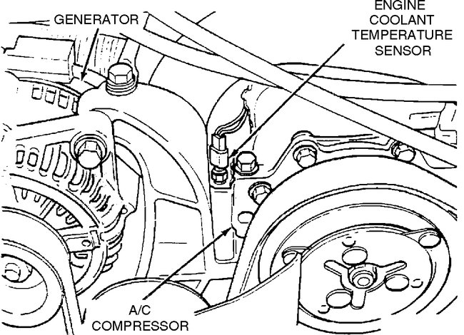

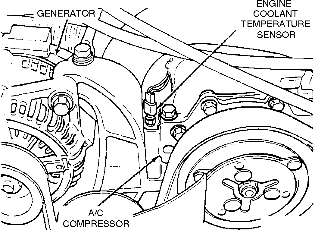

I was thinking about this issue. This vehicle has a coolant temperature sensor that sends a signal to the computer. It tells the computer the coolant's temperature, and from that the computer decides how rich or lean to make the fuel mixture. For example, if the sensor is telling the computer it is 5 degrees F, the fuel mixture will be rich. Check that component. I have attached the component location and directions for testing it.
__________________________________________

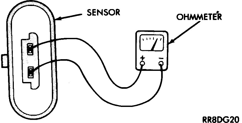

COOLANT TEMPERATURE SENSOR
Coolant Temperature Sensor Test
NOTE:
To perform a complete test of the Coolant Temperature Sensor and its circuitry, refer to the DRB II diagnostic tester. Also refer to the appropriate DIAGNOSTIC CHARTS. To test the sensor only, refer to the following:
PROCEDURE
1. Turn the ignition key to the OFF position.
2. Disconnect wire connector from coolant temperature sensor.
NOTE: Engines with air conditioning: When removing the connector from sensor, do not pull directly on wiring harness. Fabricate an L shaped hook tool from a coat hanger (approximately eight inches long). Place the hook part of tool under the connector for removal. The connector is snapped onto the sensor. It is not equipped with a lock type tab.
3. Connect one lead of ohmmeter to one terminal of coolant temperature sensor.
4. Connect the other lead of ohmmeter to remaining terminal of coolant temperature sensor.
For resistance (in ohms) at given temperatures, See SPECIFICATIONS.
Replace sensor if resistance readings are incorrect.

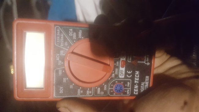

I am not so familiar with well anything on a multi-meter, so I did all of the ohm options and these were the readings I got:
2000k 015
200k 144
20k 14.37
2000 1
200 1
Oh, and here is a picture of the multi-meter:
Thursday, September 13th, 2018 AT 11:03 PM
FORENSICS
  • 108 POSTS
I have no clue if I did those readings right.
Friday, September 14th, 2018 AT 7:13 PM
