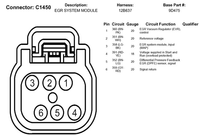

Does anyone have a diagram of the function of each wire on the EGR valve connector? A picture like the one added below would be great. Easy to read and understand.

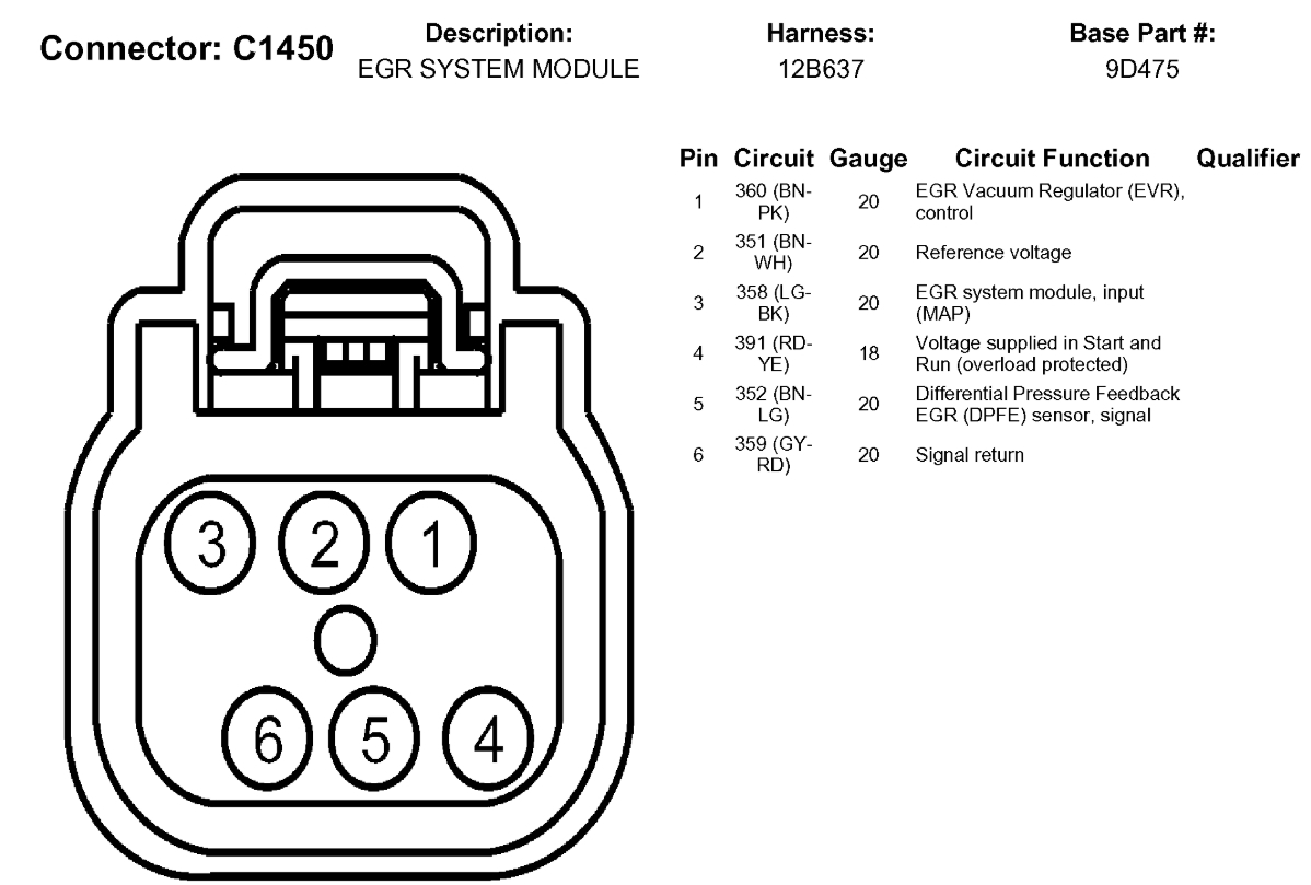

I don't see the image can you upload it again? In the meantime, here is the connector view and pinouts for the EGR system. Check out the images (below). Let us know if you need anything else.
