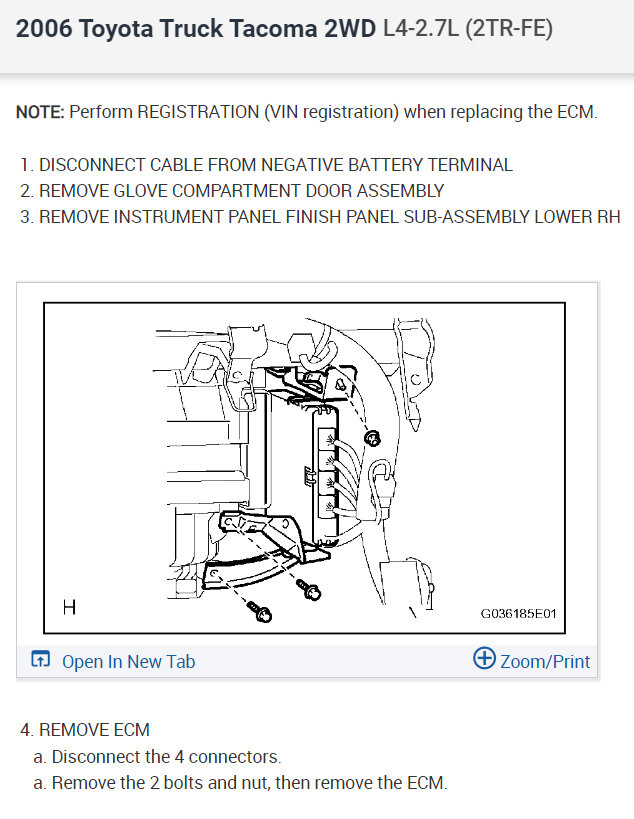

I'm trying to figure out if my truck has an EDR or black box and what year they started.

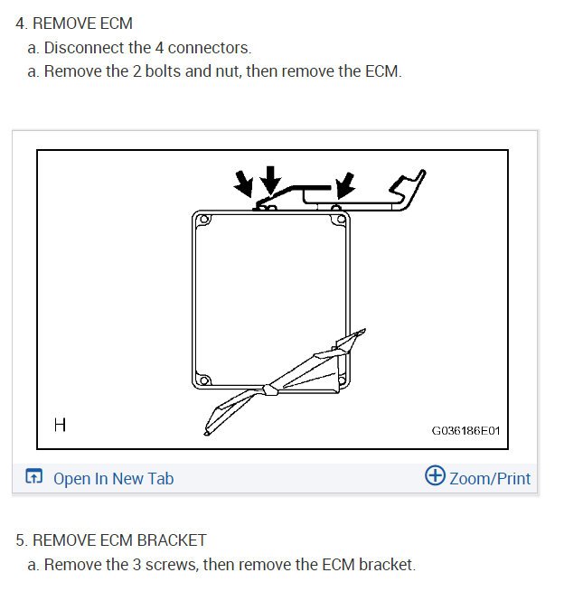

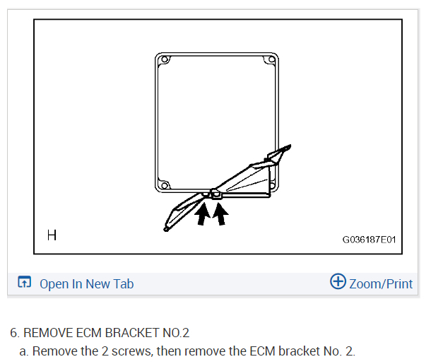

It seems there is a Event Data Recorders which is inside the PCM. Here is the location so you can check it out and install a rebuilt or used PCM which will have the recording delete are changed. Check out the images (below). Let us know if you need anything else.

Toyota started sequentially introducing an event data recorder on their vehicles in 2000. However, they still have not included them on all vehicles. In 2006, there was not one on your truck.
Let me know if I can help in any way.
