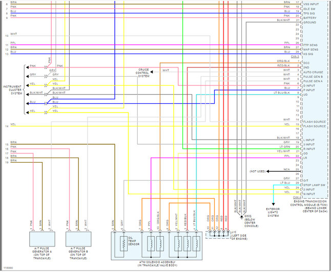

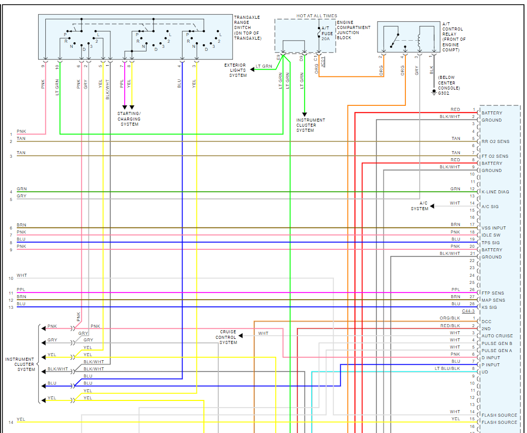

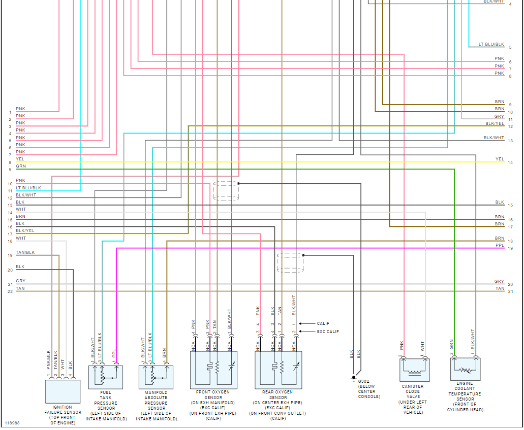

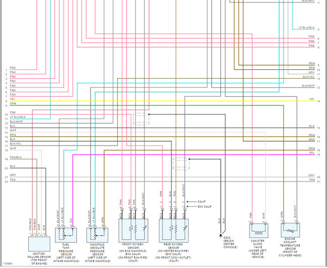

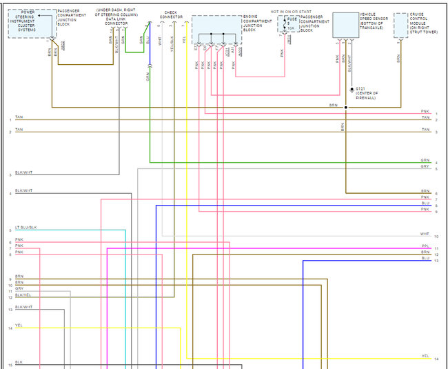

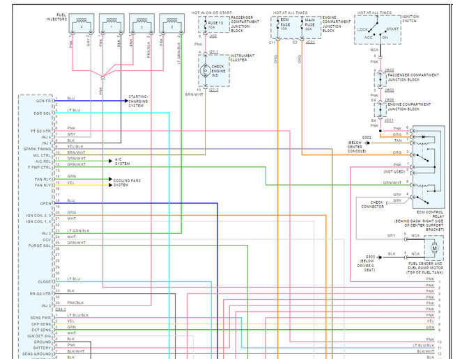

I need a wiring diagram for the vehicle listed above.
Thursday, September 5th, 2024 AT 12:22 AM
KEN L
MASTER CERTIFIED MECHANIC
55,297 POSTS
Sure, here is the engine and PCM wiring diagrams, and I have included a guide to help you with the testing if you need it.
Check out the images (below). Let us know if you need anything else.
