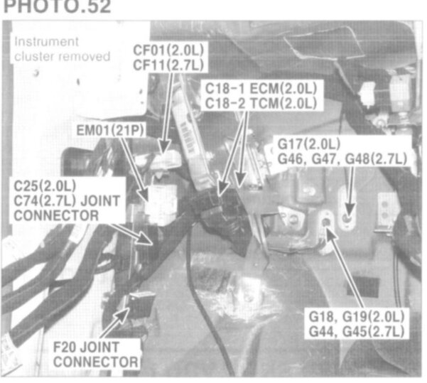

I'm running new TPS wires to ECU and found some item under drivers dash KEFICO 95447-39110 I think it for transmission and before i dig deeper I'm looking for location of ECU on this model.

The ECM is located on the right side center up under the dash, here is an images of it for clarification. Check out the images (below). Let us know if you need anything else.
